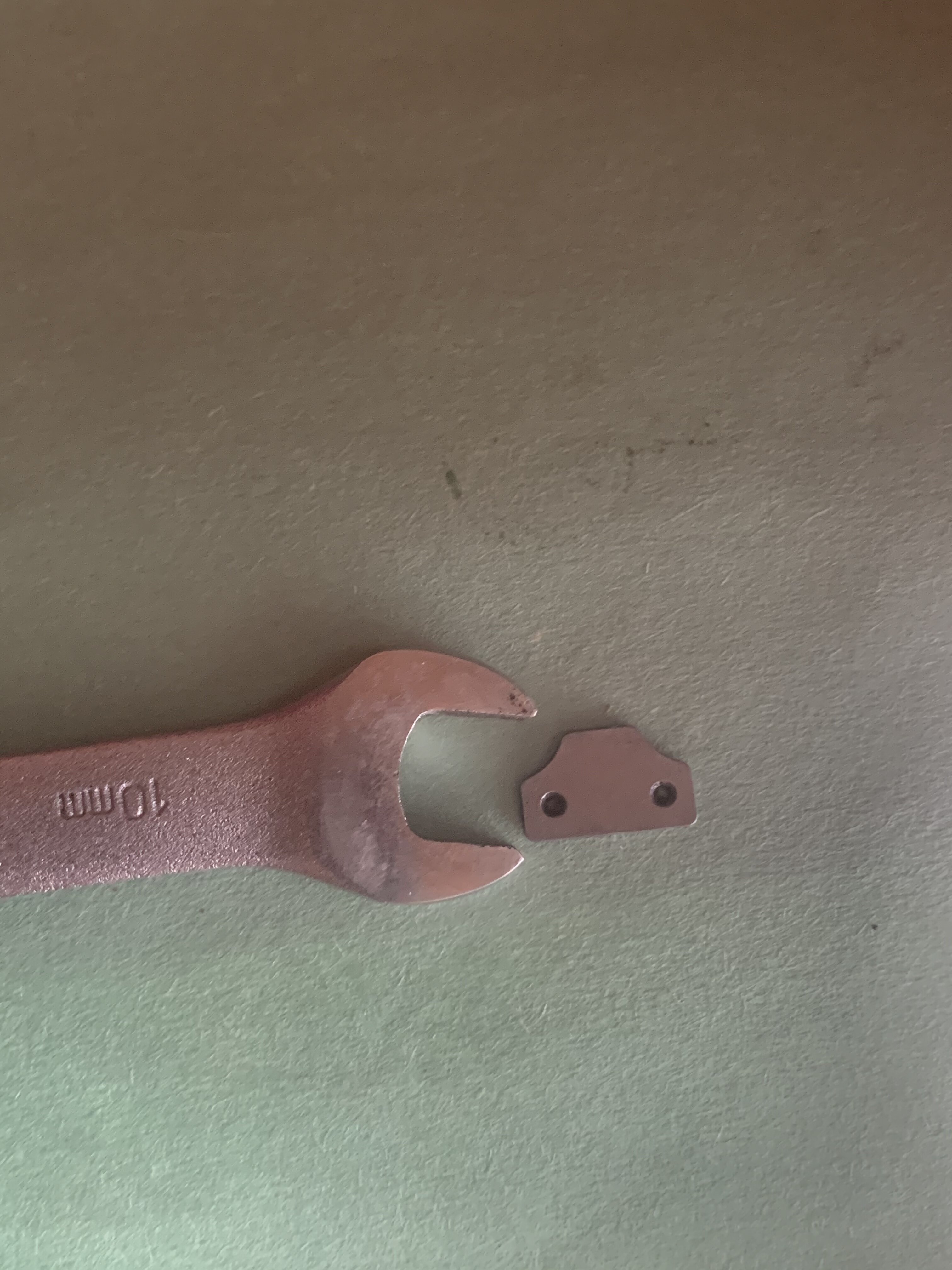

I just bought a 2003 gas gas 2003 280 pro I knew it had shifting problems, it drops into neutral when I’m riding then it’s difficult to get back into gear I usually have to shut the bike off roll it around and it usually finds a gear, I’m in the process of checking the adjuster behind the clutch, the clutch removal isn’t going as planned the 4mm bolt in the centre of the clutch seems to have stripped threads I turned it out with no problems and I can’t get the bolt out the clutch hub moves out about 1/4 inch and that’s it the bolt just spins, and also when I removed the clutch cover a piece fell out that I can’t find where it came from, it just seems to have fell out because it’s not broken from what I can see, any help and ideas would be greatly appreciated, thanks

No clue what that piece is that fell out when you took the cover off.
The Hell Team has much Tech support information.
click on "Parts Books" and then click on the year of your bike, and viola!!  parts diagrams.  I could not find anything that would be under the clutch cover that looked like that piece.

I would be inclined to split the cases and see where that piece of steel in the first photo, came from. May be it is the link (missing!) from the gear selector rollers that ride inside the end of the gear selector drum, though I recall these as looking more like a skinny chain side plate. Have a look inside before any serious damage is done. Bye, Peter B.
 The only part that looks like that is the mounting bracket that holds the trigger to the case, which is the flywheel side.

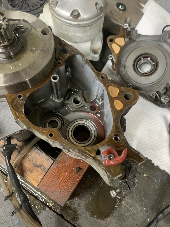

I finally got time to split the case and I found that my shifter just was the issue

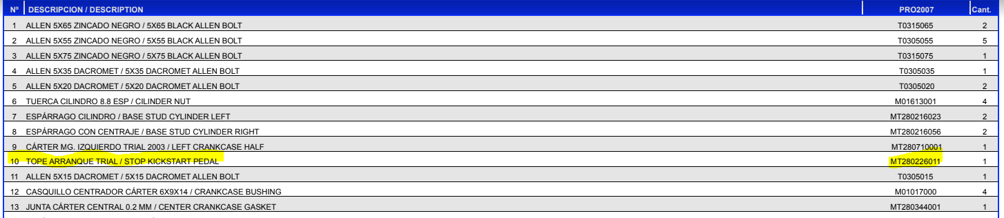

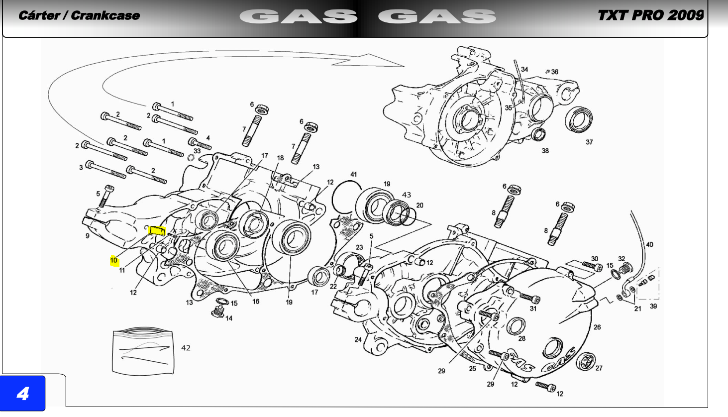

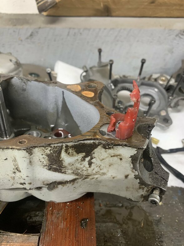

And I also have to ask.. what’s this red part??? And advice is greatly appreciated, thanks
Tacton, since you're in Creston, Dave Fair at Moto Trials West in Victoria may be you're best and closest source for needed parts; he helped me with what I needed when I repaired the tranny in my 2008 TXT. Dave also suggested that I replace the needle bearings under the gears on the shafts, and I'm glad I did as they fell apart immediately when I removed the gears (so the bearings were waiting to fail). Basically ... since you're in so deep, best to go all the way in. :)
