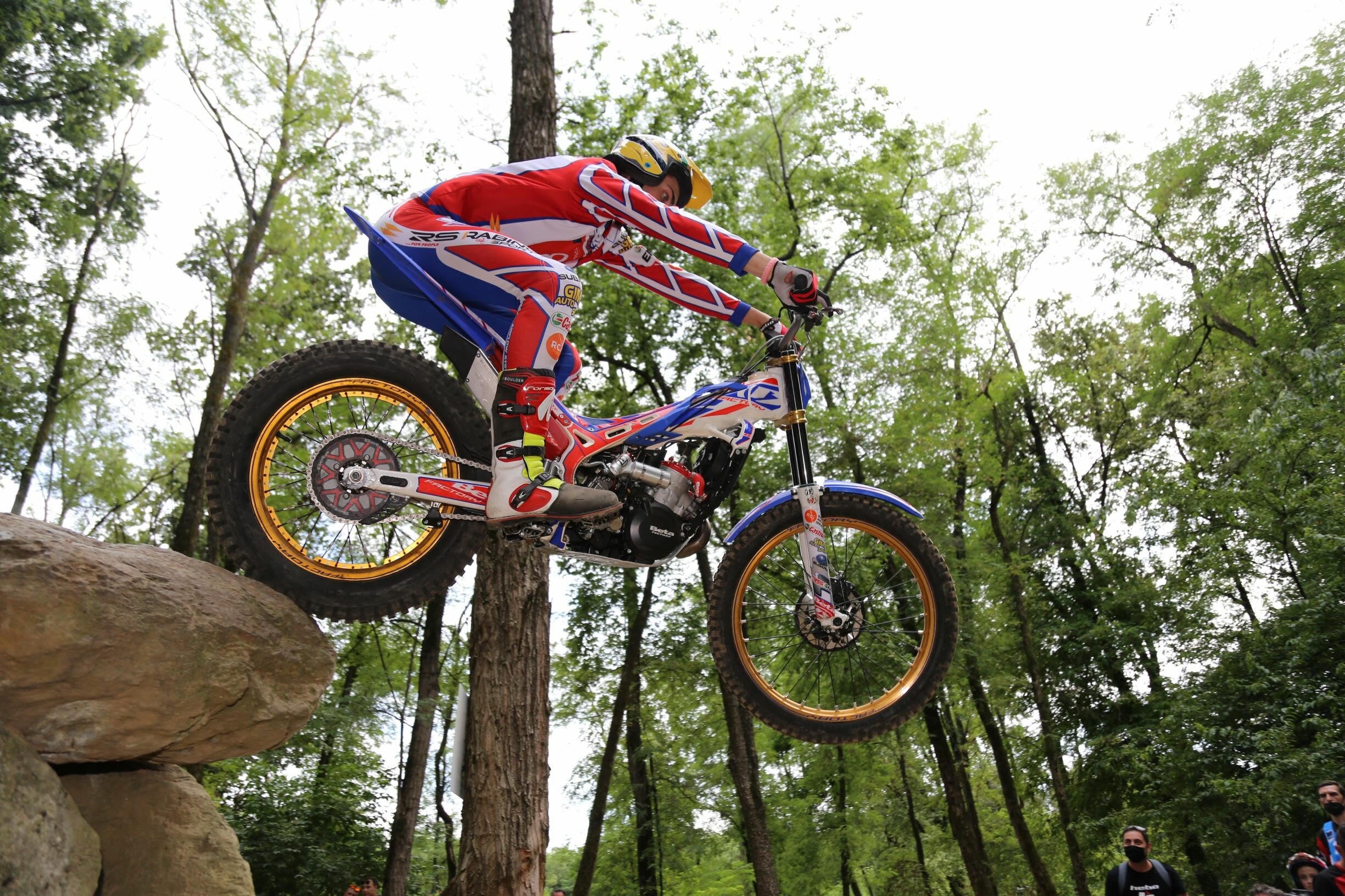

Any ideas as to what this object is?
In the attached photograph of a Beta, being ridden by a works rider, there is an interesting object in the intake area. Could it be a fuel injection system?
ย
It has a hydraulic line coming out the back. Looks like a shock reservoir but much bigger than usual. Or maybe itโ€™s a bold new graphic?๐Ÿ˜
The only factory beta riders are Grattarola and Bincaz. Neither have a remote reservoir on their shocks
Looks like a remote reservoir to me. There is a guy here in the states that customizes Ohlins and the reservoir are much different in size.ย
What I am really interested in the clutch slave cylinder. I have heard about 30mmย clutch slave cylinders for Evos but I can't find squat online. Saw one in a a Trials Tube vid but no info for sourcing.ย The gold anodized color is the giveaway I believe. Anyone have info on where these can be sourced?

Most likely a remote reservoir for the rear shock. It even has aย ย  ZF ( Sachs)ย  sticker on it.
There are more riders in the Beta Factory team than just Bincaz and Grattarola. I believe that the photograph is that of Carlo Alberto Rabino, who is not a Factory rider as I mistakenly suggested.ย However, Beta lists Lorenzo Gandola, Sondre Haga and Aniol Gelabert as Factory team riders in Trial 2.ย
The photograph was taken during an arena style trial and that might explain the reason for having a larger fluid reservoir.
You can see the reservoir in the Jitsie vid from Andorra @ the 12:30 mark
