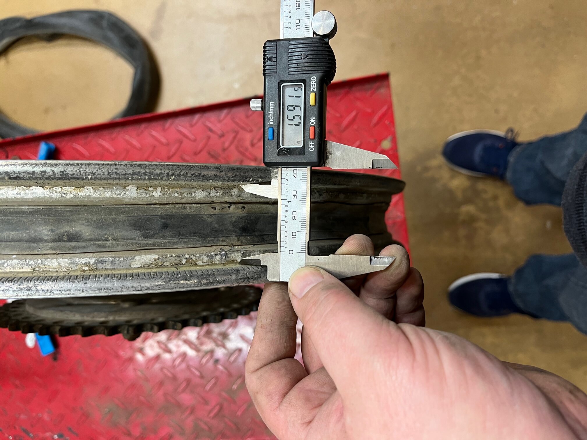

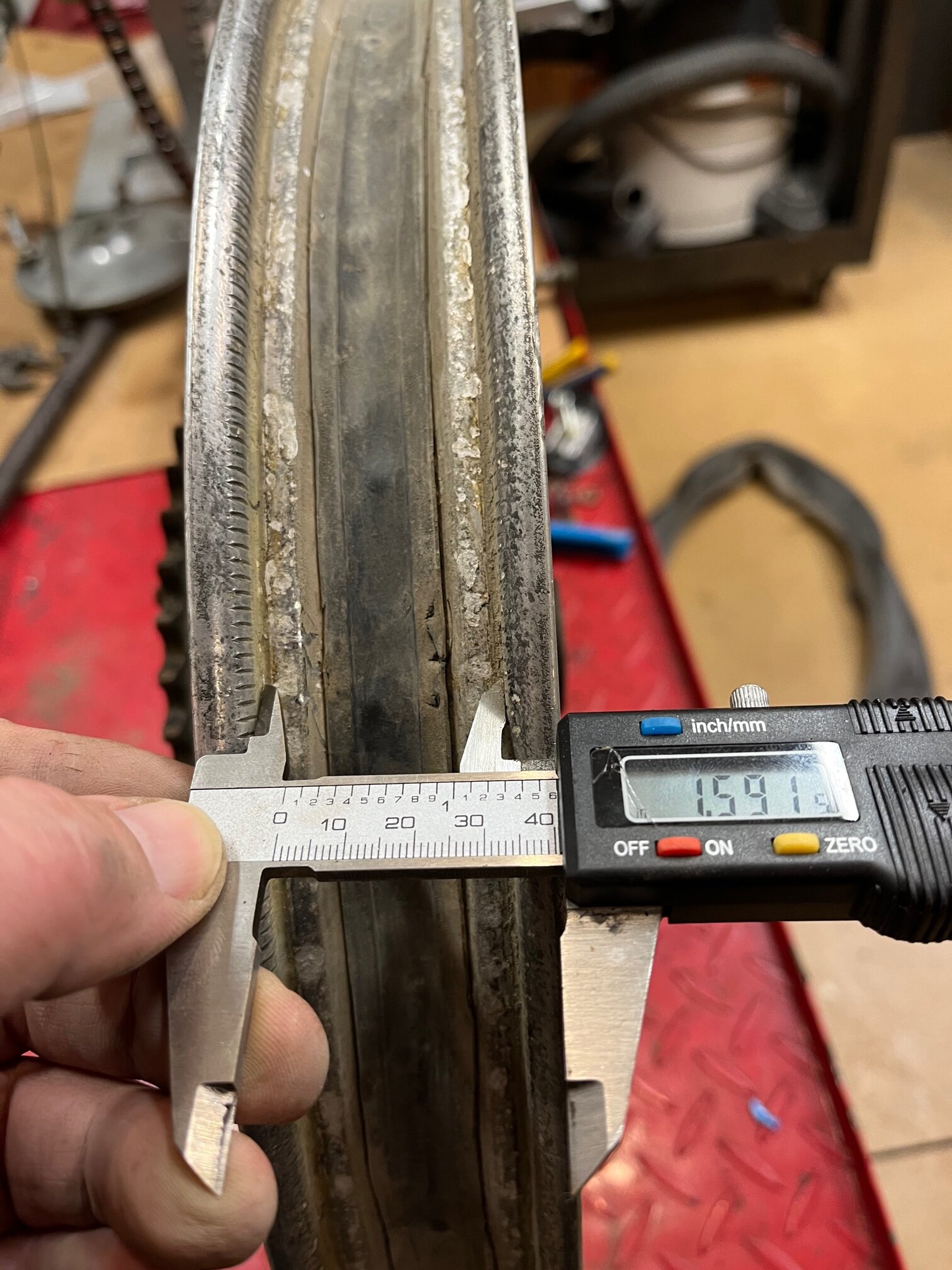

So I took the old tires off and measured the front 21" and rear 18" rim. They are both 1.60 +/-
These are akront rims and i believe them to be original to this bike, (1968/1969 year) 21M00389
Edited by 1968Cota247

Unusual to have such a narrow rim on the rear I would have thought, but the caliper doesn't lie. I would think that you will need two at 1.60" or WM1...............
I've got a 1960's rear rim that width taken from a Bultaco so I'm not surprised to see that your old Cota has one too.
