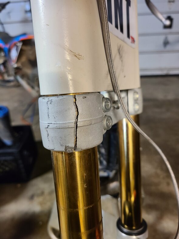

Hello, Im new to trials and recently bought a 1997 Beta Techno 250. I realized later that the lower triple tree clamp was broken. Ive been having trouble locating a replacement part. I tried Beta USA and they found a whole triple tree/fork assembly located in Italy but they wont seperate the forks from the triple tree and want quite a bit of money. I was hoping to find something used or possibly even new at a more budget friendly price point. Can anyone point me to a source to find something like this? Parts for these older Betas seem to be getting rare and trials is not very popular here in the US. Im interested in finding out if some other triple clamps might fit my bike to help me broaden my search for a useable part. Can I use a triple tree from a newer Beta trials bike? For example I found a triple tree from a Beta Rev 3, would that bolt right onto my techno and fit my forks? Would a triple tree from another brand (sherco, gas gas, etc) fit onto my bike? What other options do I have? Im trying to get this thing fixed before spring so me and my kids can begin learning this sport. Any help to get me on the right track would be greatly appreciated. Thank you!

I think i read somewhere of someone putting rev3 yokes into a techno, but don't quote me. Obviously yokes from an upside down fork rev3 won't fit. I think most yokes will be compatible with the headstock so long as the fork diameter is the same. Im not that clued up on beta im afraid lol. I think you have 38mm paiolis

Thats a pisser hoseclamp !!   Your forks could be bent also.   Try this--  Trials super store.  Inland north west trials.  There are many other smaller trials shops all over north america and canada. search them out - forget google, its junk. use start page instead to search.
You may be able to get it welded, I have had success on different bikes having aluminium welded on fork tubes at the wheel spindle, good luck
A skilled welder with the right gear can weld that and have it hold up just fine.  Finding such a skilled welder can be tricky, though!
           On 1/7/2022 at 9:30 PM, nhuskys said:  I stopped at the Tryals Shop today. I asked Mike Komer the owner if he had any used Techno triple clamps, and he does. Contact him..... https://www.tryalsshop.com/      Dude! You rock! Thanks! Ill try to get ahold of him today
