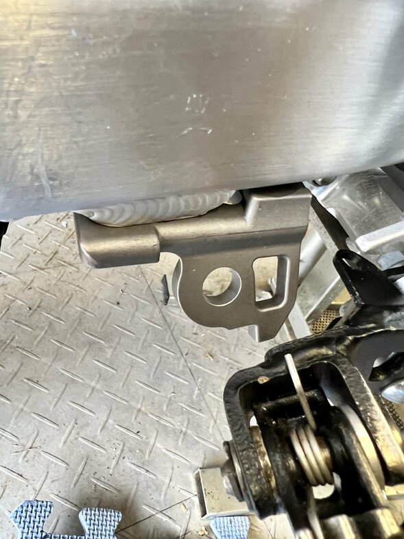

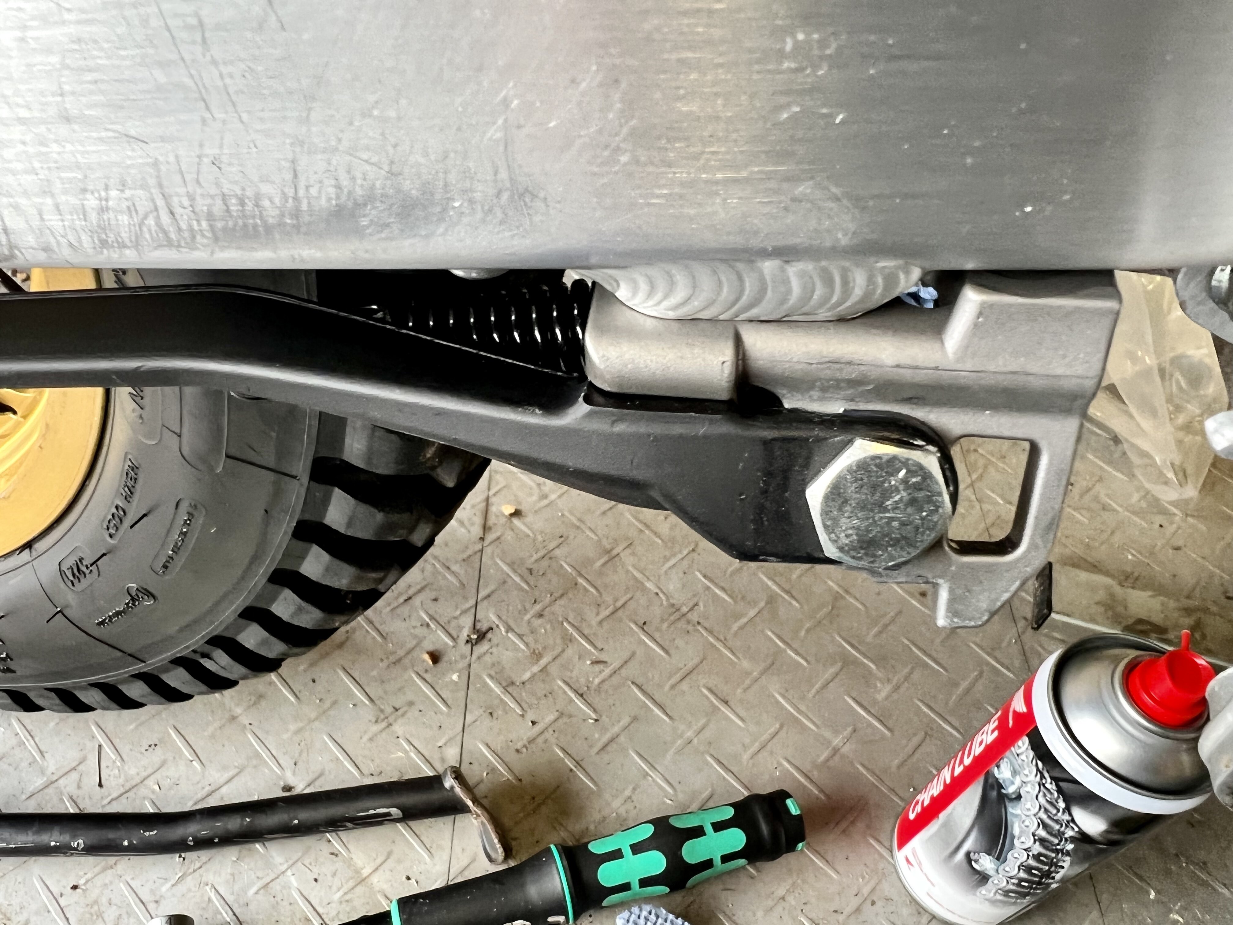

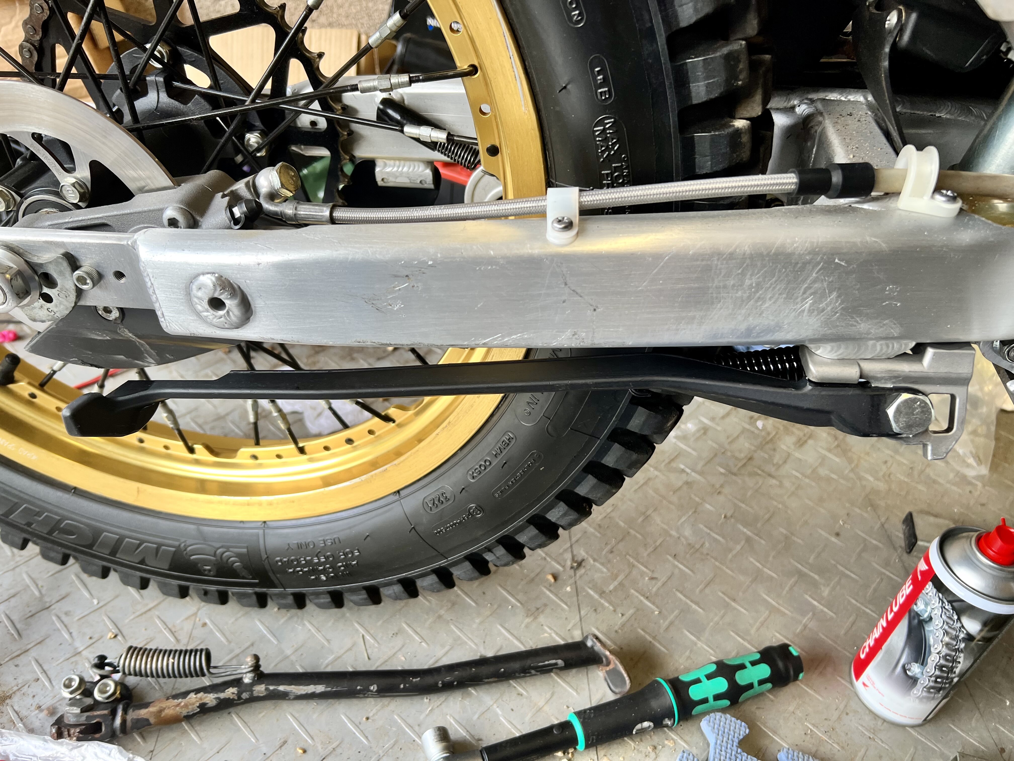

October 8, 20224 yr On 4/24/2022 at 9:21 PM, jimmyl said: Have you an alloy stand as in 301 seems to sort it I did exactly that with mine, the standard one is useless my bike fell off it twice! I bought the full kit 300rr off Mickey Oats motorcycles from there web shop, it’s a great improvement!
October 8, 20224 yr 1 minute ago, Nigelpugh said: I did exactly that with mine, the standard one is useless my bike fell off it twice! I bought the full kit 300rr off Mickey Oats motorcycles from there web shop, it’s a great improvement! I thought I posted a thread and pictures about fitting it, but perhaps I didn’t! here’s some pics as I fitted it.
October 8, 20224 yr Author Great post - thanks Nigel. Will def look at this as the stock stand is a total pain!
October 10, 20224 yr On 10/8/2022 at 9:31 PM, rr62 said: Great post - thanks Nigel. Will def look at this as the stock stand is a total pain! You are welcome chap! Let me know if you need any help with fitment once you get it, it’s lot exactly straight forward!
