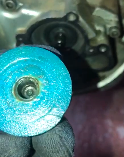

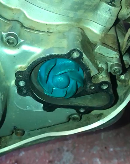

Just checked and the impeller is turning freely on the shaft! Needs a new one I guess? Yamaha charge 62 GBP for a new "impeller assembly" - my god! Any way I can fix rather than replace? Maybe a second hand impeller (not the full assembly) will do the job? Anybody know where I can get one?
If you search under Scorpa on a well known internet site there’s a lad on there whose always breaking Scorpas so worth a look
I took a video of the spinning impeller but it's an illegal file type here so the pictures will have to do. The first picture shows the impeller on the shaft and can freely turn - I was able to spin it, zero resistance. Definitely gonna replace it and check for overheating. Will update here when the verdict's in. Thanks to all who've commented so far :+1

If you can't get a replacement part, I would recommend Loctite 638 retaining compound.
