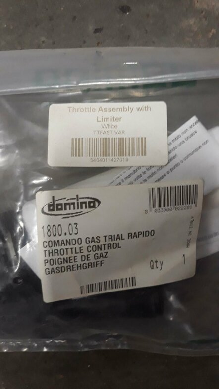

When the stop is removed, does these revert to fast action, or slow?  The white tube suggests they are fast action, so I'm not sure about fitting one.  As a beginner I'd benefit and so would my lad, as we've had incidents of whisky throttle and whilst I'm OK, it knocked his confidence a bit.
Can't find any info outside of what you posted and another store in Europe.  I thought maybe it would say on the box or something.
Cheers

Don't know for certain but Domino would be silly to confuse us between white/black tubes on their limited throttle, so my guess is "fast throttle".
Buy their "limited" throttle and their "black" tube and you've got all bases covered in my opinion.
PS: Check photo, definitely fast white tube.
Edited by fourex
Photo Added.
Thanks mate.
I think they have been discontinued as I can't find them anywhere, even manufacturers site.  If thats true, I'm sure it's because someone devised a simpler workaround, but I'm at a loss as only just getting into this sport. :)
Maybe the fast throttle is a good thing if it's limitable.  I'll have a ponder.

I don't think so. Fast throttle gives you full power without too much wrist movement. The throttle stop just gives you less movement and less power. A slow throttle gives you more sensitive control for slow manoeuvring but the power is still there when the wind it on. It's my guess that you could change the throttle tube in a limited throttle assembly if you wanted to.
