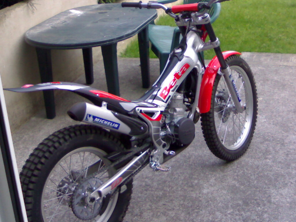

I will give it a go ive nowt to loose worst bit about it my mates 06 sherco fires up first time and our lads 05 rev3 and im kicking mine over for 10 mins!
Well thought i had bad cold starting sorted till this afternoon when i got to adingham moorside or the nab if you want to call it that! its still not liking it from cold but once it was warm it ran the best it as ever.Bike felt really lively and revs cleanly but getting sick off having to kick it over when cold for 5 mins?
I think they wang the carbs straight on from mikuni and dont bother checking them. I found a piece of aluminuim under my choke plunger making it a t.wt to start. im thinking of getting a delloroto carb for mine! there on special offer at the moment on there uk website
Got fork stickers from steve saunders think they were only about 8 quid. I want some swinging arms repsol ones now as i have worn one of the beta ones off! Just a shame you have to buy a full set off him but he is looking into doing them seperatly
Tryed starting it today again and it was not having it.Removed spark plug and it was pi..ed wet through cleaned plug which was new a fortnight ago and shoved it back in and tryed again.Still no joy so i removed carb and stripped it totaly down. When i removed choke plunger i found a small amount of aluminuim blocking hole in bottomn of choke housing.Cleaned all carb jets reset float height and put carb back on and it fired up first time. Just goes to show how these mikuni carbs are thrown together for beta! I also fit my fork protectors and repsol fork stickers which finish it off nicely
