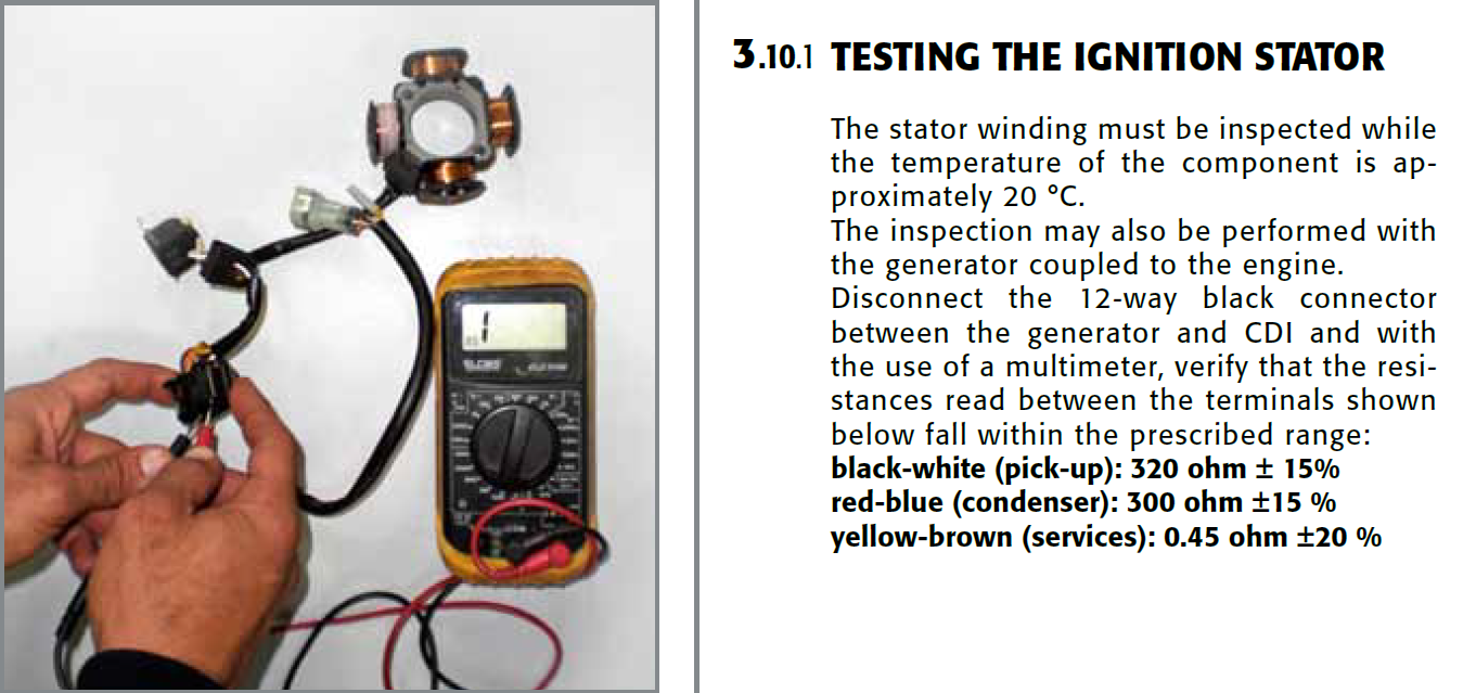

rev3 coil resistance values.

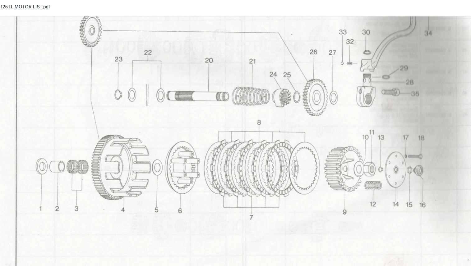

This is from EVO Manual
