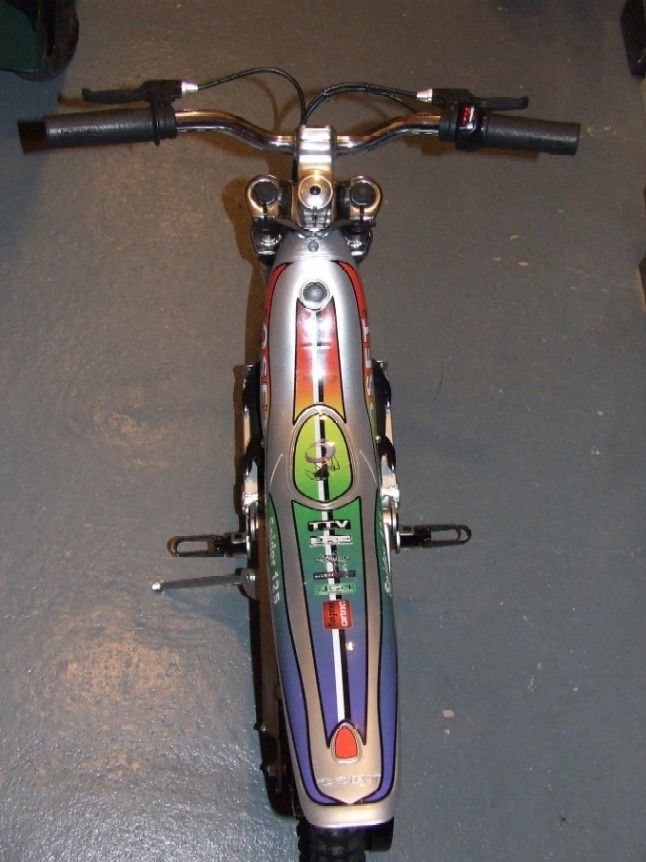

I got the batteries from a UK supplier and wanted to use the Oset charger as there is a charging port on the bike, this saves hassle having to remove the batteries and charge each one seperately :chairfall:
