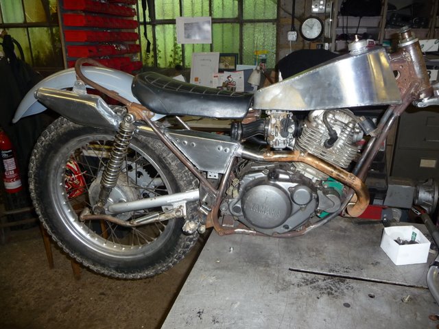

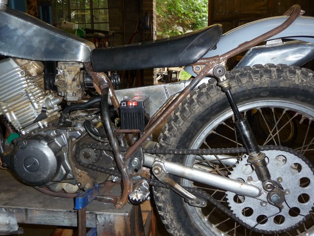

I've added a couple more pics,to show how wrong it is.The white cross is where I am thinking of raising the pivot to - 25mm higher.Not totally decided,but it sorts out the chain run and there isnt much more I can do.It will mean cutting and raising the subframe mounts and adding extra metal around the new pivot hole.By leaving the top shock points in the same place I should end up with pretty much the same height/ground clearance,the only worry is the rise/fall under power.
All good fun,if it does not work I'll build a frame from scratch,using a jig that keeps the original dimensions and angles from the TY frame - lets hope its not needed.
It is a step in the right direction.
"if" you can get it closer to the gearbox sprocket all the better
i used to trial a complete Serow (kick only, with valve lifter) and used from memory a 420 chain with a
very small front sprocket (held with circlip) it may be worth your while to compare diameters of sprocket between 520 and 420
the smaller you go on the front the more it may help your compromise
on picture 3 it looks like the rear wheel spindle is slightly higher than the line through the first two points, you should try and get the rear spindle to drop below the line when at rest, weight off
but your proposed new swing arm pivot point will certainly help.
good chain guide, and a very good spring on you chain tensioner!

Moleman, I still need to sit down and actually work out the best way forward,but I think the compromise,(as you rightly say) will be to raise the pivot by approx 25mm. With the CV carb I'll have a fair bit of room for the airbox,but my memories of Strombergs on Rover V8's was that they like a bit of depression upstream to make them pull properly,but thats a bit further on.I spent a couple of hours fitting points/condensor and cleaning the carb on my TY250 - not ridden it at all since September,it was in a bit of a state - water in the float bowl etc,very poor waveform when I scoped the plug lead.So having a nice 4t twinshock hybrid to ride will be a waste of time if I'm so rusty and fat its not true ! First Bath trial is 14th Feb,better start practicing.....

No,I'm going to keep going - moving the swinging arm pivots is no real drama and there is no hurry.If I can build a reasonable bike form the TY and the Serrow I'll be happy - 4 reasons;
1 Its not a Honda.
2 Its electric foot.
3 Its a well proven and reliable 4 stroke.
4 It wont cost more than about

There is some progress after almost 2 solid days of fiddling.(Not that it looks much.)Got my camera back and sort of sussed out how to post piccys direct.

Still in a similar shape to the pics,I have made the airbox but its not finished.I need a bit of thinwall 1 1/2" alloy tube to get on with it.It will happen tho,I bought everything I could think of to finish it from BVM a while back,but there will be odd bits and pieces to add.Once the airbox is finished the main bit is the wiring - not too much of a problem apart from the W/S manual I downloaded off the net is for a US spec bike and I think mine was a Jap home market bike.Many of the wires are a different colour.....
