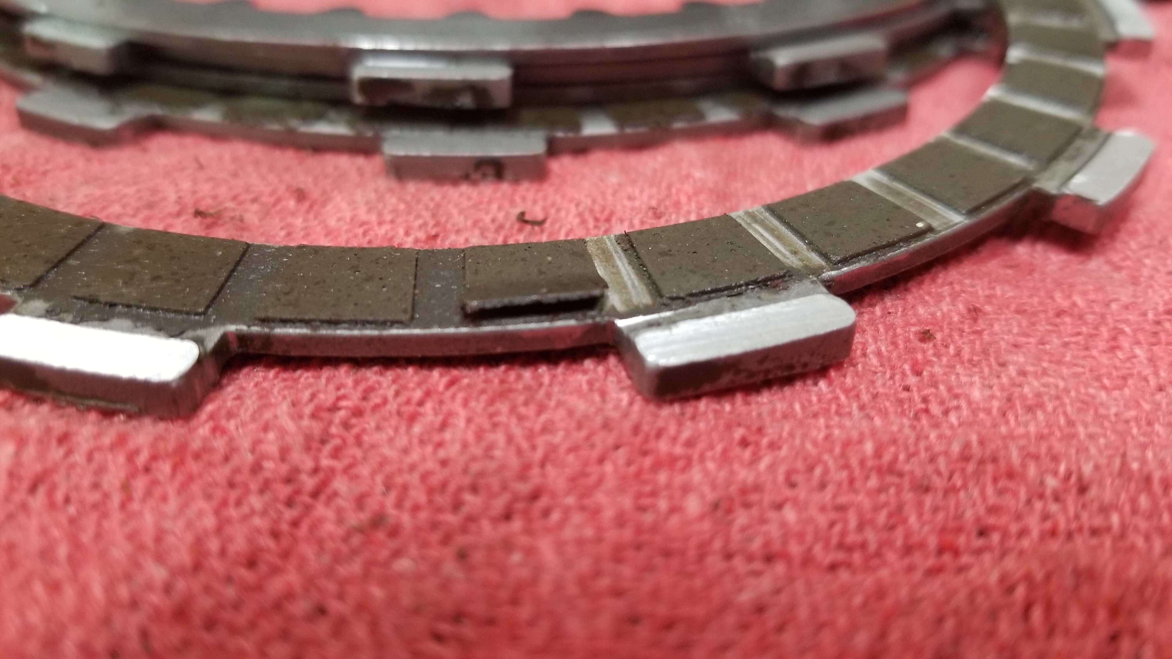

Just removed my plates to do the mod , I appear to have two different types of plate , all but 2 of them have larger gaps between the tabs.the one on the left on the photo is really sticky and looks like it will benefit from the mod ,the others look ok , am I missing something?image.thumb.jpeg.d4ec965973426ff74a2c7c4ce3f5766e.jpeg
Yeah that's "normal". Beta replaced the two outer plates with slightly thicker plates so you will have four 2.7mm thick frictions and two 3.0mm thick frictions. Not sure of the logic behind this. I usually replace the 3.0mm thick plates with a couple of the 2.7s and dress them all to the Clutch Fix document. Or you could just dress the 3.0mm plates like the others and put it back together. The newer plates are a lot less gluey so the removal of the glue between the pads is optional. The older plates were a mess.

First I would suggest a thorough clean, looks like at som point the oil was left in too long and all that sticky stuff stuck to part of the plates sitting in t6he dirty oil. Do you mean two of the plates are thicker, if so thats correct. so clean then do the mod and clean agin before reinstalling. Let us know the results you get.
Thanks for the replies lads much appreciated , so the 3mm thick plates go back and front do they? Eric your right when I took the clutch pack out it was all stuck together in one big mess.when I was riding yesterday my clutch was gradually getting worse and worse to the point where I had to wind the adjuster all the way in to have any clutch at all! Looking forward to seeing the results after I’ve done it , I’ll keep you posted

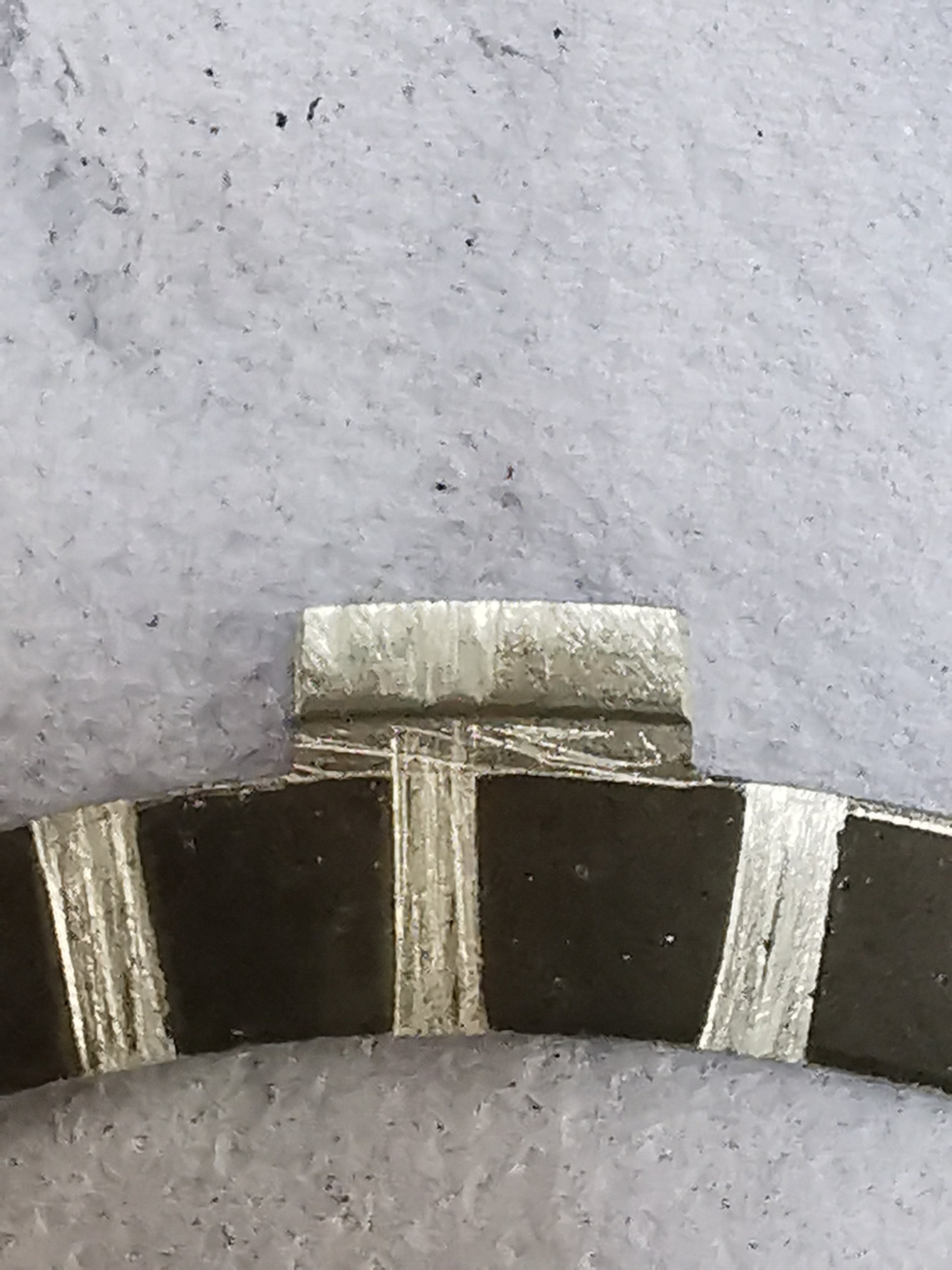

I've carried out the clutch fix but think I may have messed up - it looks like I've not got all the tabs square when doing the final polish after cleaning the faces with a needle file (see pic). Will I need new plates? My worry is, if there's excess play, it may damage the clutch basket.
Wow! Rushed it a bit did we? That much play would probably result in twisting of the plates. I'm not sure there's a way to recover this as all the faces on the tabs have to be at least close enough to wear in. You also appear to have leaned in pretty heavy cleaning the glue from between the pads. All it takes is a light touch and as with any filing less per stroke is always better than too much. Anybody around Leeds got some spare plates to help this guy out?

Perhaps if you do any more tabs start with an 18cm cut 6 Barret needle file and maybe then a fine emery paper (not wet and dry) from a jewellers supply house. HS Walsh & Sons, Hunter House, Biggin Hill Airport, Churchill Way Biggin Hill, Kent TN16 3BN United Kingdom. These guys have good materials and will likely sell a couple of sheets of medium and fine rather than a choir, far too much for one job.
AND clean the needle file clean after each tab, you can use a thumb nail and scrap the teeth of the file at a 45% angle.

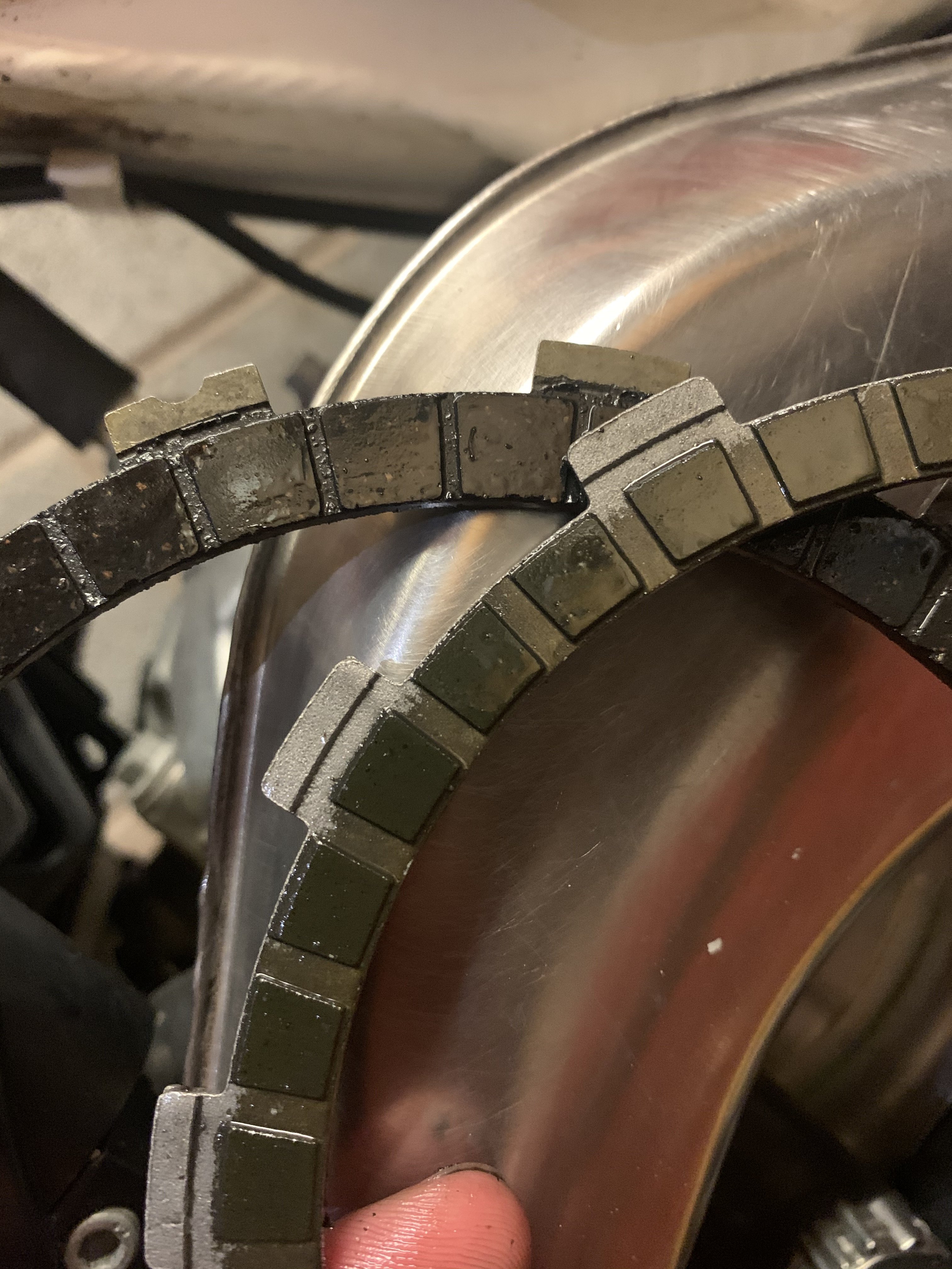

So I finally get around to doing the clutch fix.  I get about 3/4 through the first plate and this happens:
I guess I'll be buying some new friction plates...  doh!
I'm pretty sure this clutch is 21 years old...
