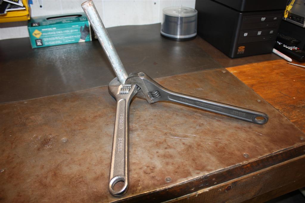

May 27, 201115 yr Hammers are too sophisticated, I use a stone. For some perverse reason, Charlie, I believe you... Here's a little "trick" I've used for decades to bend or straighten parts, from spokes, subframes to sump shields and beyond. Two Cresent wrenches work very well, just imagine the pipe as a spoke or any part you want to put a lot of torque on and be able to easily control how much you want to bend. Better than a rock..... Jon
