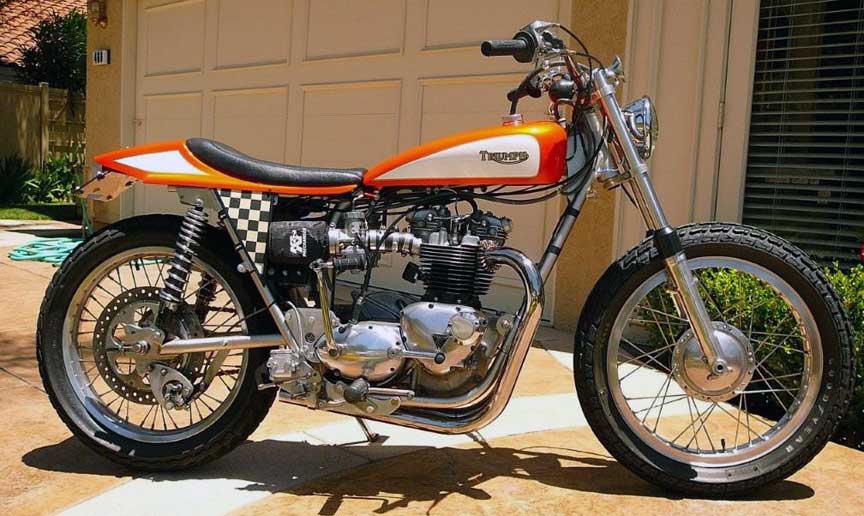

September 25, 201313 yr Why stop at a DT-1? I got a lad at work that is a Triumph GURU! Says he has a couple(hundred) bikes! I already told him I want a 650 Street Tracker!

September 27, 201313 yr Author Copemech , the Triumph looks smart . Must admit,bet that bike runs tons better with them carbs on . They look like Mikunis . Was the bike from the track converted to the road , or is it a road bike . From looking at the pic there seems to be quite a few track bike fabrications on there . HTRdoug . My choice exactly . Run a 18 x 4.0 inch rear and 19 x 2.15 inch front (for a road going bike) co-built fork yolks and R6 RWU forks . DT 360 tank. Mick Abbey hydro-formed expansion chamber and mild tune , 36mm Mikuni with pod filter and put a fork brace on like the one fitted to Kenny roberts YZ 400 flat tracker . Convert the hubs and fit discs .

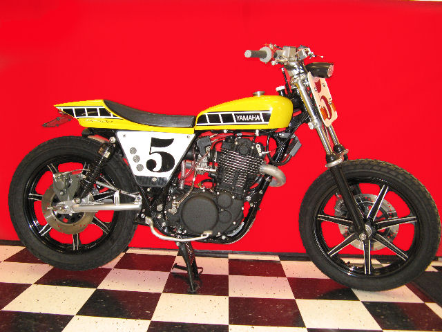

September 27, 201313 yr To get the Street Tracker look you have to have a fat front tire,I can't recall if there are any mounting bosses on DT forks to attach a fork brace to,only really needed if you run a strong front brake.Possibly track down some RD400 forks,bet you could even use the RD 7 spoke wheels,or if you find a good RD just build that into the Tracker... Big square number boards(don't know the british colloquialism for what we call number plates) with hole cut out to mount projector beam head lamps,trackers don't look right with standard headlights.You guys have "daytime MOTs"? forget lights altogether! If your a real man about it you pipe must hang low and be in the way for turning right,right footpeg should hang low,left up high and tucked in as in the above rd pic. RD is the real deal,not a street bike,note the Champion frame. Edited September 27, 201313 yr by htrdoug
September 28, 201313 yr Copemech , the Triumph looks smart . Must admit,bet that bike runs tons better with them carbs on . They look like Mikunis . Was the bike from the track converted to the road , or is it a road bike . From looking at the pic there seems to be quite a few track bike fabrications on there . HTRdoug . My choice exactly . Run a 18 x 4.0 inch rear and 19 x 2.15 inch front (for a road going bike) co-built fork yolks and R6 RWU forks . DT 360 tank. Mick Abbey hydro-formed expansion chamber and mild tune , 36mm Mikuni with pod filter and put a fork brace on like the one fitted to Kenny roberts YZ 400 flat tracker . Convert the hubs and fit discs . No idea as the pic was a random example I found just for idea. Fact is, nothing here is practical or comfortable as a road bike, yet for short jaunts around I could come to grips on one better than a crotch rocket type!
September 29, 201313 yr Author Htrdoug , check out the pair of 70s 2 stroke twins by Winbro racing on google . Immediate stalker on! The thing is you can't pick old RD's up here now for less than $5000 ! For a non runing pile of ***** you are paying $1500 and need to spend a bomb on them to get them something like . I had the DT in mind as it's simple and doable at a reasonable price . The bike in the photo looks **** hot ! The point here for me is simple , if you get a kick from riding a bike of your choice then that's good.Iv'e done 10 lap club races on my old Aprillia inline twin with little more than a sheet of foam under my ass and remember we all ride trials bikes and don't know about you but the seat on my GasGas is err well non existant . If i was interested in bikes as a means of day to day transport here in the UK then i would look for comfort or buy a better car . Then a fairing , heated grips (pipe and slippers) STOP! Tell me more about trackers ,do any of you go to meetings , have any of you got one ?Tell me , i'm interested ! Regards TED
October 2, 201313 yr Author HTR D ,Thank's a lot for the pics . The SR 500 is my second choice . Simple lines only seem to amplify the attraction of the first two images. The bars on the sudco bike really set it off as does the black motor and spoked wheels of the bike with plate 83 . Great ! Strangely enough there are very few of the Harley's that i like or the ex moto crossers although without a doubt they are brilliant , just not pleasing on the eye . Once again thanks Ted
