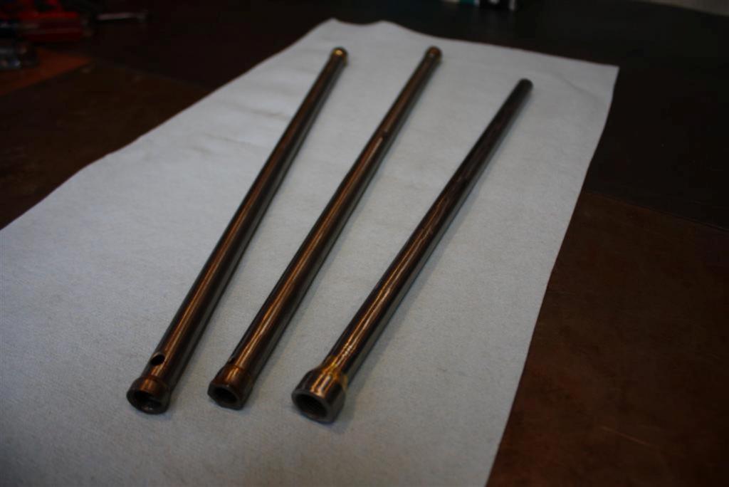

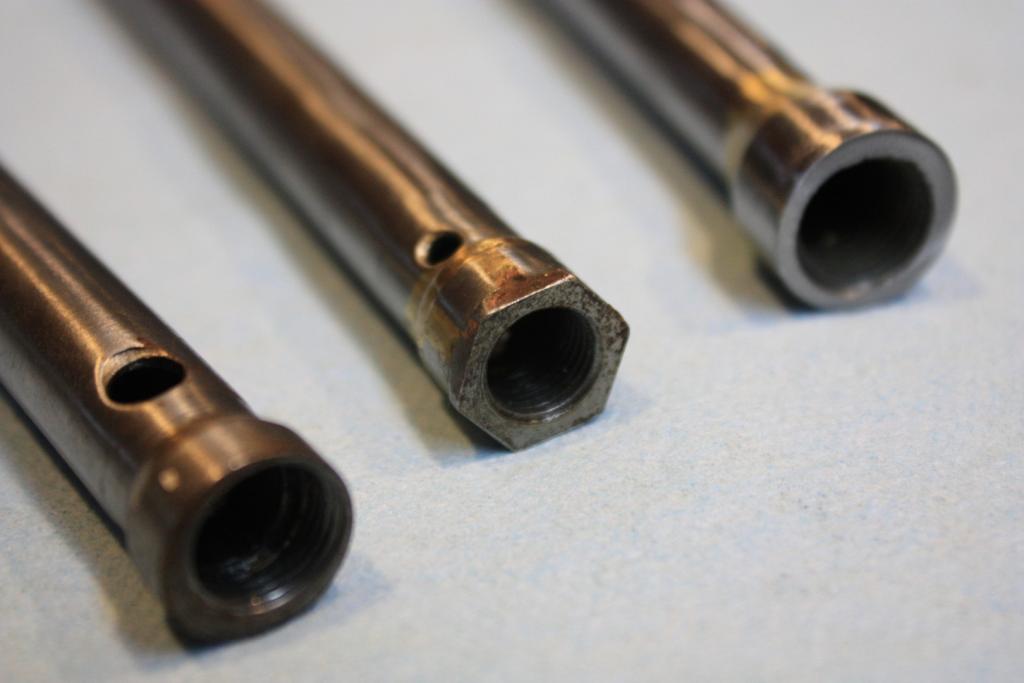

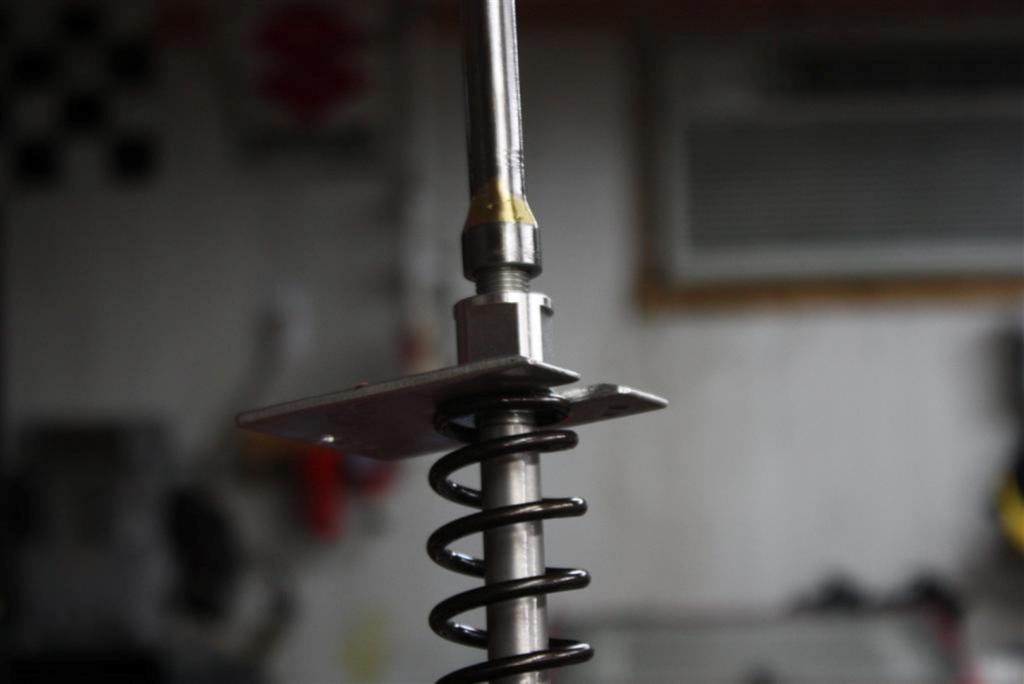

If you are going to work on forks a lot, you may consider making a bleeding tool. It's steel tubing with a nut welded on the end and a bleed hole drilled. It's threaded on the cartridge rod and allows you to easily pump the cartridge to work any air out. I made these tools that have various size nuts to fit a wide variety of forks. They also make assembly easy as you can pull the cartridge rod up after putting in the spring, washers and spacers.
Jon
Jon,
Thank you for replying, and for the pics of the tools you came up with! That's a really great idea for the bleed tool you came up with..... :icon_salut: It would work out much better than my piece of copper wire that I use to pull the rod up.......
