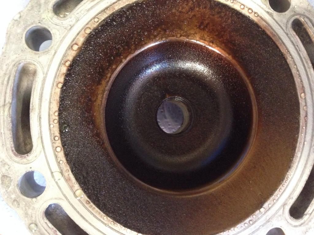

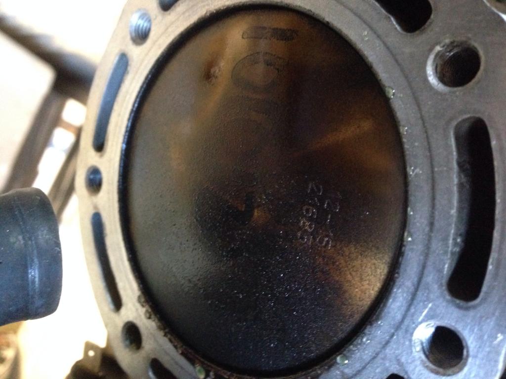

I've got a new head gasket and taken the head off and this is what the inside looks like also when I rode it it was muddy, I didn't think at the time but I had quite a lot of mud built up on the front pipe which probably wasn't a good idea whilst breaking a new top end in.

I would be happy with a carbon spot of almost any size on the piston crown, yours is clean or washed down
The theory is for power reasons you need your combustion temperature and therefore piston crown temperature to be high enough to burn the fuel mix onto the crown
Rich means cooler temp, lean would put carbon to the edge of the piston

Hate to tell you, but only after 3 hours of riding that cylinder and head should be clean as new. Hard to give advice over the internet, but have someone that knows check it out.
