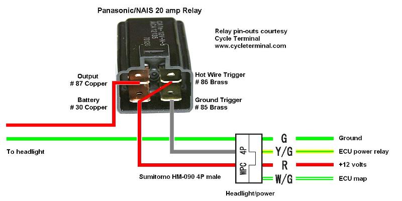

Once you have the bits, wire it up as per the ED/2E version wiring diagram in the manual. You need 12V power from the red wire in the harness (Sumitomo connector) to go to two places on the relay (bat terminal #30 and coil terminal #86). Run the trigger wire from the yellow/green wire in the harness connector to the relay coil (terminal #85). Then for the headlight: run a red wire from the output of the relay (terminal #87) and an earth wire from the Sumitomo connector (green harness wire). The relay terminal pinout diagram is available from the cycle terminal web site but Ill post it here if I can get permission.

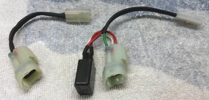

This is what my finished wiring looks like the original on the left (with a Tamiya 2 pin connector for the headlight because I remove it during the day) and the power relay setup on the right. It adds a couple of grams but works a treat.
Edit: Added this wiring diagram...
