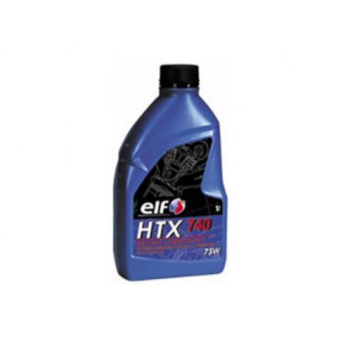

Not been that happy with my clutch for a few weeks now even though the oil gets changed quite regularly so time to try the ELF HTX to see what difference it makes before try different plates. I knew it would improve things but the difference has been quite incredible and much better than I could have ever imagined. The clutch is very soft and progressive and the bike will start in gear, and more importantly no more slight dragging which was becoming a problem whilst riding. Yes its expensive but I'll happily put up with that considering the result and its worked really well this morning at a local practice area not far from me, so thanks to Laurence at BVM Moto for recommending it as I was going to try something different.

I find that with the GRO Gear Extreme 75W, which is the same kind of oil, the clutch is even a little smoother.
There's a reason why it's the oil Montesa recommend - it works
For some reason Elf don't recommend it for gearboxes with a wet clutch, but it works.
Also it doesn't seem to get dirty as quickly as other oils I tried so I just change it very 6 months, not so expensive then.
If you can track down some Mitani clutch plates it works even better

Have  used ELF HTX  since my 05 4RT and have to say I have always been happy with the clutch action, even on the  05 (although take up was a bit sudden until I got used to it) Everybody mentions the price but at 0.54 L per oil change and excellent life it really is peanuts compared to the rest of the costs of competing. If it is available use it would be my advice.
Guys, do I understand that you tried the Elf first and then found the GRO slightly better, it's just I've 2 litres of GRO 75w gear oil left from my previous bike and would use it in my new 260 4 RT.

Yes, i've used the Elf for a long time (in my 315R and previous 4RT), and the GRO is slightly better. I'm using it in my 2015 4RT as well, together with Mitani clutch plates.
