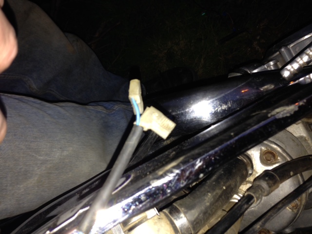

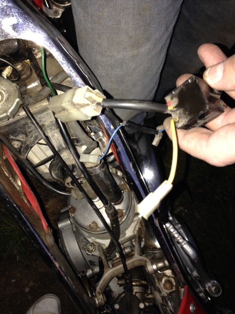

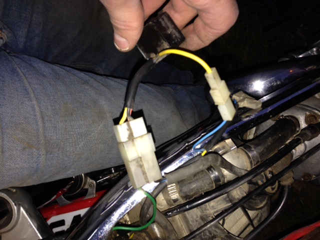

Well the good news. The fan works when a 12v current is attached, spinning nice and quietly. The bad that once the wires on the thermostat are connected it doesn't seem to want to, so not such an obvious quick fix. I will post some pictures to see what your thoughts are.    There needs to be live feed from somewhere. The yellow? If I could only do a temp fix that would be great and I will take the bike away with me.

Are you not basically saying the thermostat is faulty?? Or are you saying that when the bike is running and you short circuit the thermostat the fan wont work? Thermostats are such a common failure on that age of gg its the first thing id go to.

I agree with the switch. We were going to do that last night. However, if it was just the thermostat then bypassing the two wires would set the fan running. It didn't,  but if I knew where the power was coming from (yellow?) I could use a length of wire and spades, could I not?

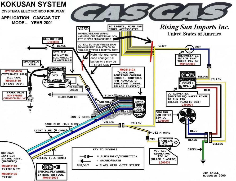

Is that a txt? This wiring diagram looks abouts right. If its not the fan nor the thermostat the next thing to check would be the rectifier (the small black box you are holding in your hand). Time to get the multimeter out
Yes the yellow wire is your power BUT it is AC the rectifier changes it to DC.If the fan did not run when you unplugged the thermostat and connected those wires more than likely it is the rectifier. DO NOT BYPASS IT
