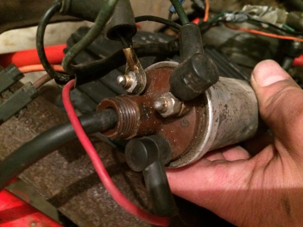

i got a new fantic - the fm450 trial 240 pro. nice, but they dont start. a the ignition cables somebody did change. the spark is but not so strong (i thing...)

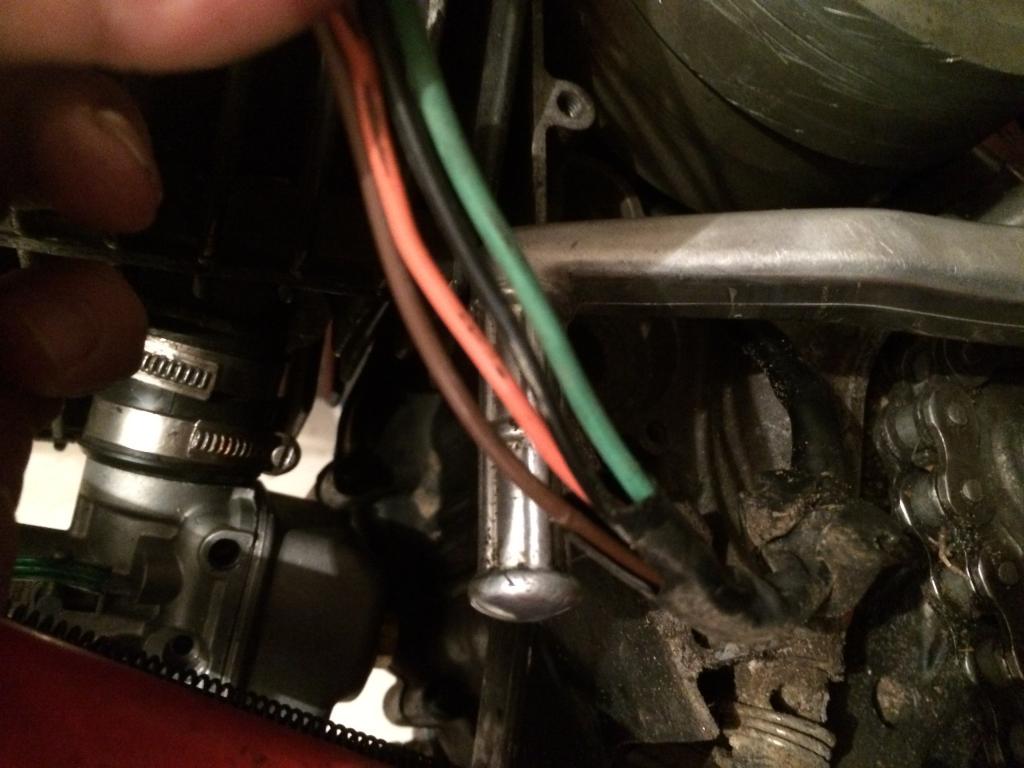

i got ONLY 4 cables from the startor (brown, orange, black and green) the white and red are missing...? the orange goes to the coil combined with a red cable.

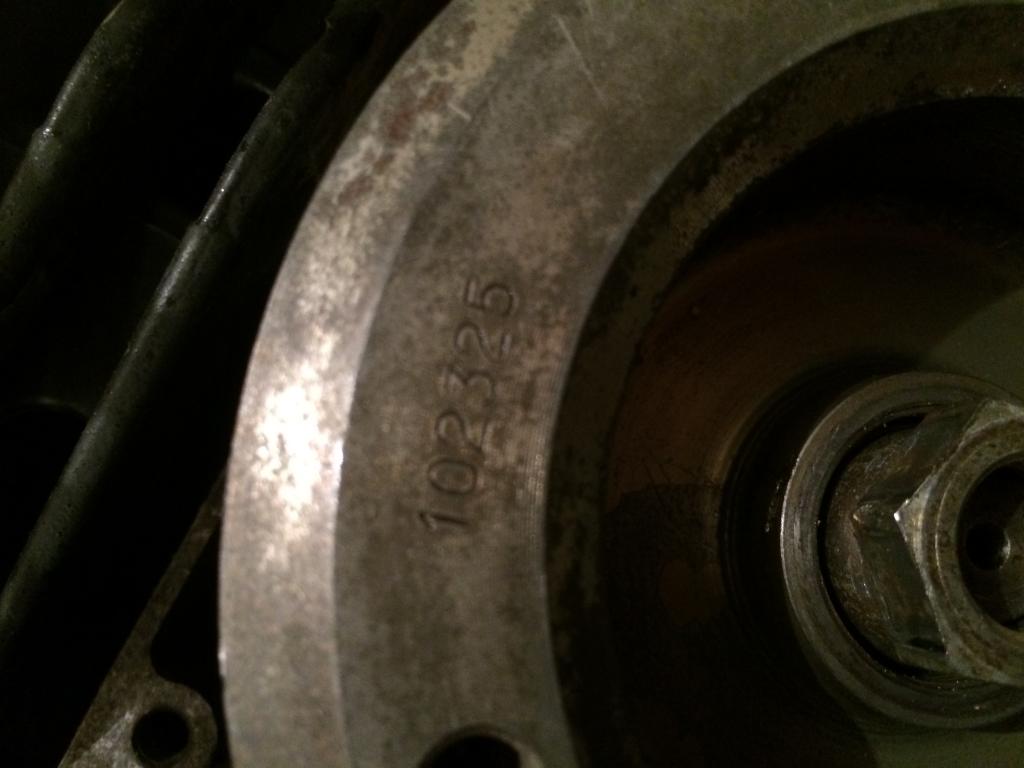

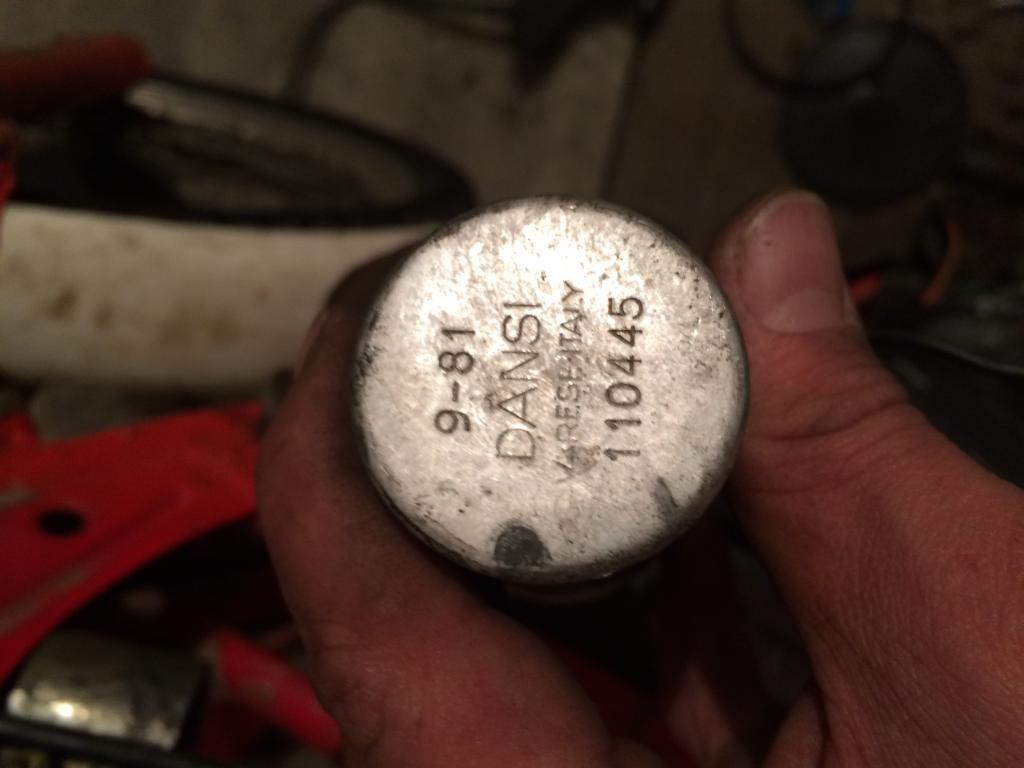

coil is a DANSI 110445 and the magneto is a DANSI 102325.
some idea? dos enybody a FM450 / fantic trial wiring diagram or a repair manual book?

nice Glenn, thank you!
looks my coil works on a brake light cable...

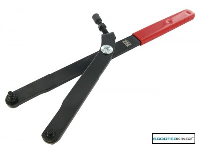

ok, thanks i just order the 26x1,5. one more question - what tool should use to block the flywheel?
like these? is it enough ? left-handed or right-hand thread
Edited by elsimonell
That tool looks OK, thread is a conventional RH thread. I have service information for a 240 - PM me your email & I will send it.
and what the ohm resistance values on RED / ORANGE / GREEN / BROWN cable ?

Black is ground, red is coil and green is trigger coil. Black to red is 450 to 800 ohms. Green to black is 40-80 ohms.
Black to ground should be zero
