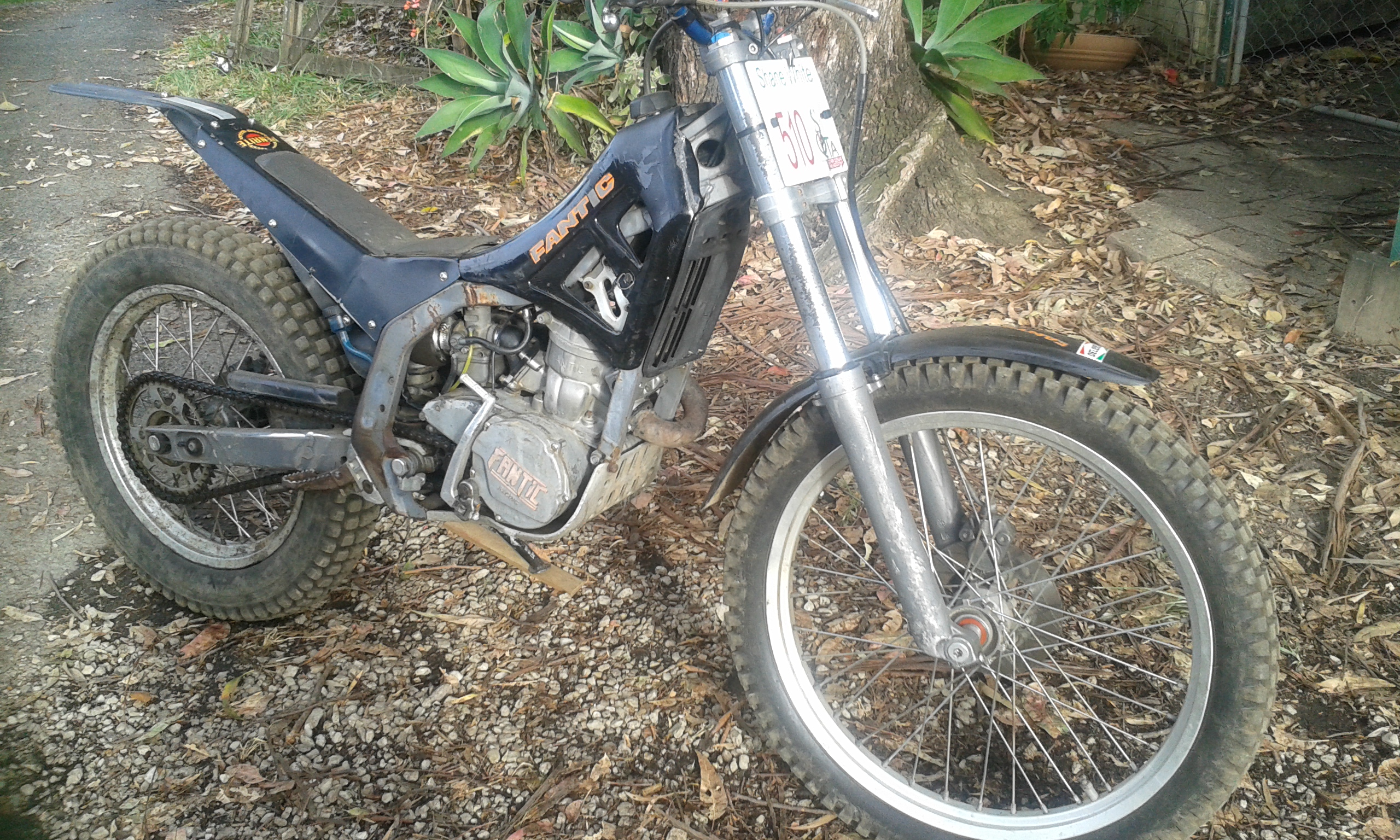

After cleaning fork seals and replacing oil, neither leaking, forks need re chroming but used some fine wet and dry to smooth off pealing chrome.
See what happens after a days riding.
noticed RH head steady has cracked from the frame. Can weld, but do I need to disconnect any thing before doing it ????
Have a stick, DC welder. Can put the earth right on the weld point.

Not welded yet. Still waiting for advice.
In theory if you clamp right next to the weld so long as you have a good earth it should be ok. Having said that whenever I take anything aluminium to my mate who’s a fabricator for welding he tells to me take it all off just to be safe.
I don’t know what the Section is like but on my 309 all the electronics is built into the coil. The only other thing is the generator itself. Once the coil is disconnected the only connection to the generator is earth through the body of the stator onto the engine.
I suppose it all comes down to how comfortable you feel with doing it.
Sorry I can’t offer a more definitive reply.
All welded. Nothing disconnected.
Just removed side covers and fuel tank.
Lay bike throttle side down.
Cleaned frame right next to weld point for earth lead. cleaned up crack and welded.
Everything important was covered. Just pored clean water on weld when finished.
