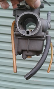

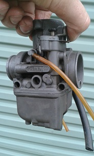

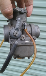

Hi, Just wondering if the two yellow tubes from the carby should actually be one piece and have snapped into to separate ones.
I have some new green chainsaw fuel pipe to replace it with.
Thanks.
Whitehillbilly
Edited by whitehillbilly
Any Dellorto carb I've had, the overflow tubes are separate.
The ones with an air screw were not the best.
Well all back together.
comment on Trials Au,
'Those ports are vents and must be open to atmosphere. As stated it was common practice of some Euro bikes to link them together with one tube but what they did was knick the side out of the tube around mid point to open it to atmosphere. If you don't have these ports open the carby will not function correctly'.

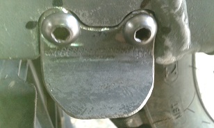

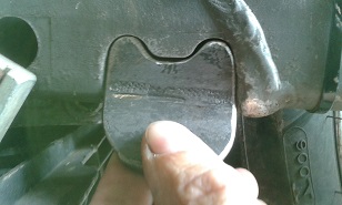

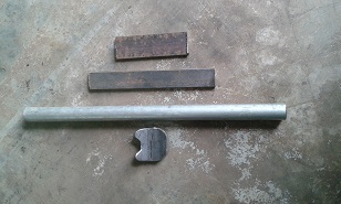

Decided to make a stand.
got some steel and made a start.
whitehillbilly
I fitted this universal side stand to my Section...
http://www.ebay.co.uk/itm/NEW-UNIVERSAL-FITTING-STEEL-SIDE-STAND-FOLDING-MOTOCROSS-ENDURO-MOTORCYCLE-MOTO-/322092152560?hash=item4afe3036f0:g:RckAAOSw~OdVbcmC
Needed to shape the bracket to fit in the recess. I fitted an original stand spring as it was smaller. The one supplied kept catching my boot heel when riding.
