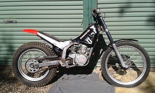

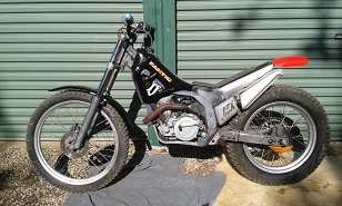

Thought I would start a thread, as many questions may follow.

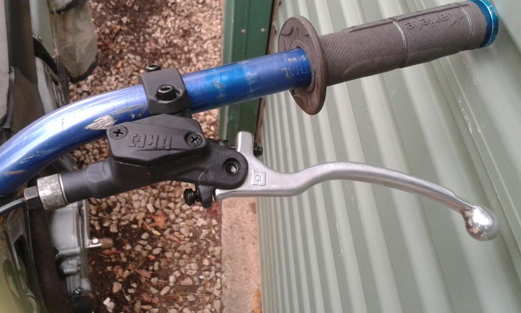

New clutch and brake masters fitted.
Front brake bled up easy.
Clutch not so easy. Ended up seized plates was the problem, but not before putting fluid out of the slave cylinder.
Before photos.

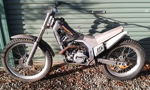

    Changed the coolant, 500 mls. Good weekend trial, 40 section day, Fantic ran like a dream, apart from hand starting the Radiator fan, now and again. Took my 10 year old daughter for the first time,

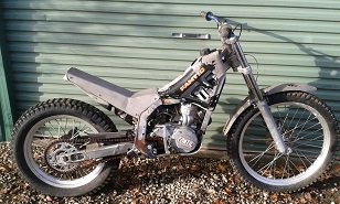

    Well Santa has packed his Sleigh away for another year. All ready to go. First Trial Kicks off next week.

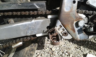

Fixed the fuel tap lever, small hole, high tensile nail and some locktite.

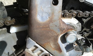

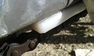

Next problem was the worn chain tensioner, and swing arm protector, which fell to bit as I rode the Fantic.
These seem a bit hard to get hold of.
Some head sratching and 2 hrs later, with an old 10mm chopping board and clear silicone, and use of the old fixing screw.
I also made a set of spares
