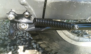

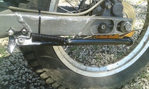

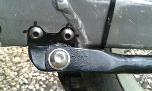

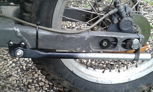

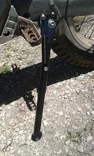

Finished Stand :D
Thanks to those involved.
Trial Tomorrow,
see how it goes, as I think the lower spring bolt could be another 15/20 mm lover, to keep the stand up tight.

Well done! The stand looks really good. You could put a slight bend in the leg tucking it up a little out of the way, save moving the spring.
I use the same EBC brake pads in all my Fantic disc brakes and have found them really good.
Hope all goes well tomorrow. I'm out on the 240 at the South Midland Classic Trial. It's been raining a fair bit so we'll have some mud to keep things interesting!
