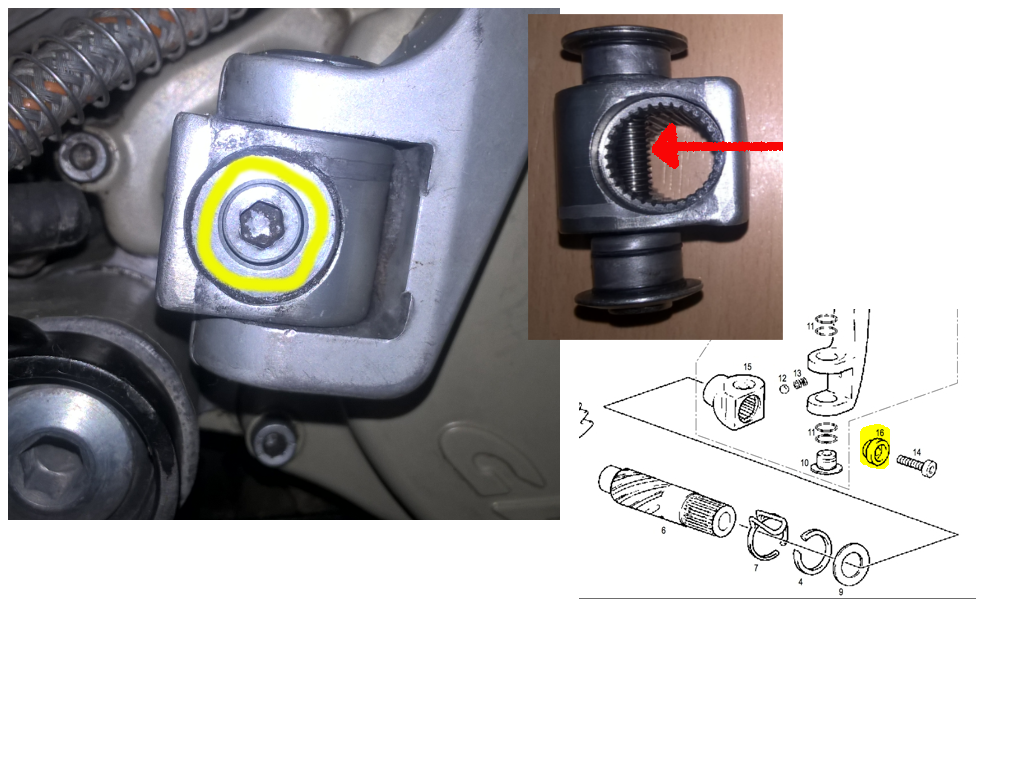

 Actually the Gasser is easy to work on. You have not even touched on the real faults. After taking a second look, are you missing the kick starter bushing. That washer should not be used. part  MT280226068 And the leak just needs the seal seated or a new seal.
Part MT280226068, I suppose that is the in yellow part on the photo, no?
I don't see how it can be avoided that the vertical bolt (red) don't touches the kick shaft when the kick assy is bolted t the shaft? That doesn't look as a good and solid fit to me, with this vertical bolt in between?
I've used a similar product from Loctite; #620 Bearing Retainer. It's a "glue" for cylindrical surfaces. One will need to heat it slightly with a torch to loosen it. I've used it on my gear lever.
I'm not convinced the design is OK. The fine serrations need to be held to very close tolerances, and even then, a steel shaft in an aluminium body! :o If it has to be steel and aluminium, I would prefer to see a slot and pinch-bolt.
 The only time most people have trouble with the kick start lever is when they can`t get it off. It is actually a clever design, since you just loosen the bolt about two turns and open the lever and it pries itself off the shaft. The bushing holds it in straight so it aligns going together. Ever figure out the seal? New seal install correctly should stop the leaking, unless something is wrong with the shaft on the inside of the motor.
