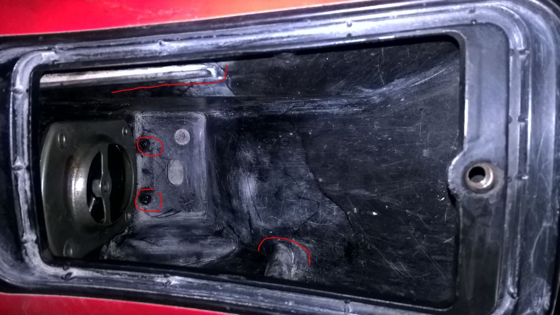

1. airbox: very important to keep clean, but very time-consuming to do. What a joke is this 'valve' at the bottom? And the 2 studs inside that cover the screws of it? All these corners, the pole inside, inaccessible areas,.... makes it almost impossible to clean. The metal airfilter holder is not leakfree, just like the cover with the benji seal. And this transparent flap covering the filter, just because the top cover is leaky.... How hard can it be to make airbox leak free, accessible and easy to clean?

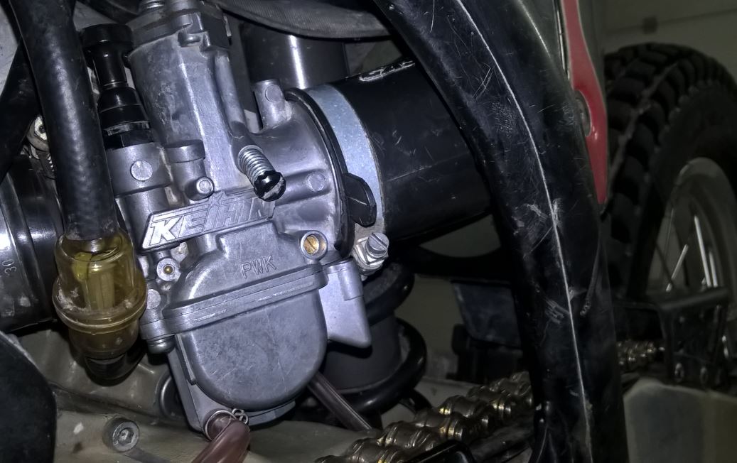

2. carb intake: for cleaning the airbox, I found best practice taking of the rear fender assy. But putting it back is a tricky job. It is not easy to get rubber hose completely over the carb inlet and at the same time keeping the 4 spring-nuts in place.

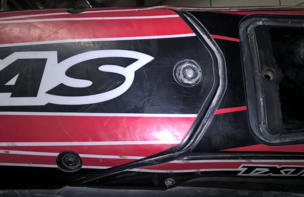

3 rear fender:  why is it fixed with screws? One flip-over and the fender is broken. Why not using a sort of clip-on system? Some makes recently start to use a very soft, bendable fender now.

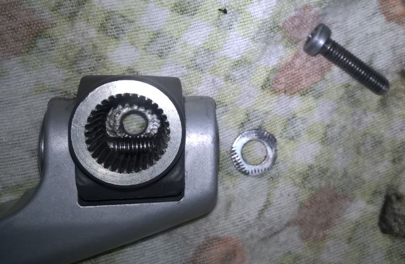

4 kick start: after some years it bends and/or brakes. And what about the fixing on the shaft? The bolt from the kick itselfs, sits in the way to get the fixing completely to the shaft with as result that the bolt on the shaft comes loose now and then. Not to mention the oil leak at the shaft itself.

I've used plastic bolts (number plate type) to hold the rear mudguard on and they break off and save the mudguard (successfully tested many times)

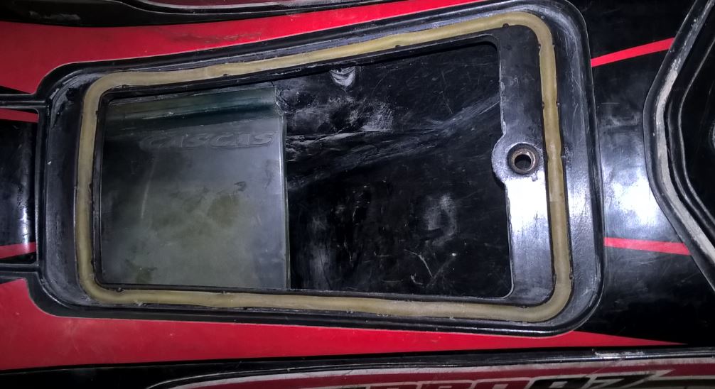

Used different seal strips on the airbox lid though improved but not found perfect one. (still experimenting).
Warm the rubber boot to soften it attach to the rear of the carb before attaching the carb to the forward inlet boot, you will wonder why you never did this way before it is much easier.
Never broken a kickstart but when I found out how much they are I got a 2nd hand one in new con for a spare very cheap.

1 Why are you getting so much dirt in your airbox? Do you pressure wash? Do you block air box before washing with a sponge/or something?
2Its not easy but if done slowly with the jubilee clip slack its not hard to do. Make sure the rubber is aligned and ease on then worry about clips when in position. Dont forget to slacken the intake rubber clip as this can help wiggle carb to get airbox in. Once refined its a 30 sec job, honestly.
3 most change the rear fender screws for automotive plastic trim clips.
4 never had a kickstart go or bend, but your bike is ten years old?

1 i sealed the lid with grease as its water proof and did the job, also put a sponge in the bottom stop mud coming up through the flap if in muddy conditions.

3 Plastic bolts as said.
4 Kick starts are ok if used correctly. I had 2007 300 and didnt start it correctly or set carb up. After damaging kickstart paw n idle gear then case i sought advise and never had any issues.

I'm aware good kick starting procedure is important, I also bring the piston first to compression with a few soft strokes on the kick, to then hit with all my weight. Mostly, with a warm up engine, is starts with 1 or 2 kicks. Maybe you some other good kickstarting tips to share?
Last year I had to replace the kick, it was bent over the years in such way that your booth easily slipped off when kicking, but finally it broke at the turning point. And yes they are pricy.

The idle gear tends to chip teeth and needs to be removed to inspect the inner side, sadly i didnt remove n spot the damage and it ruined the engine. I learnt how to strip it and rebuilt it a great cost. always check filler plug for small bits of metal and if you get a intermittent rattle that could be the idle gear.
Air box are effective i know they fill up with crap but it dont get past the filter. Always check as i didnt n a mouse had made a home in it n ate part of the filter LOL!

The filter box isn't a design flaw as it does its job very well. Modern bikes have a low seat height. At some point in the early 90s the separate seat disappeared and was replaced by a filter box you sit on by most manufacturers. This means that the intake cannot be under the seat like it was on an air cooled mono.
On the gas gas the intake is behind the shock so yes you do get mud and water splashing in. That's the point of the flap on the underside, any material amount of water drains back out. In reality in really deep water it can get in that way but it's limited by the design of the flap if the bike is going forward.
The filter was also moved and is now inside the box not at the air entry point. This means all of the mud in the filter box hasn't got through the filter. It looks bad but it works very well. I always clean the filter but 99 times out of 100 the carb is clean after a trial.
