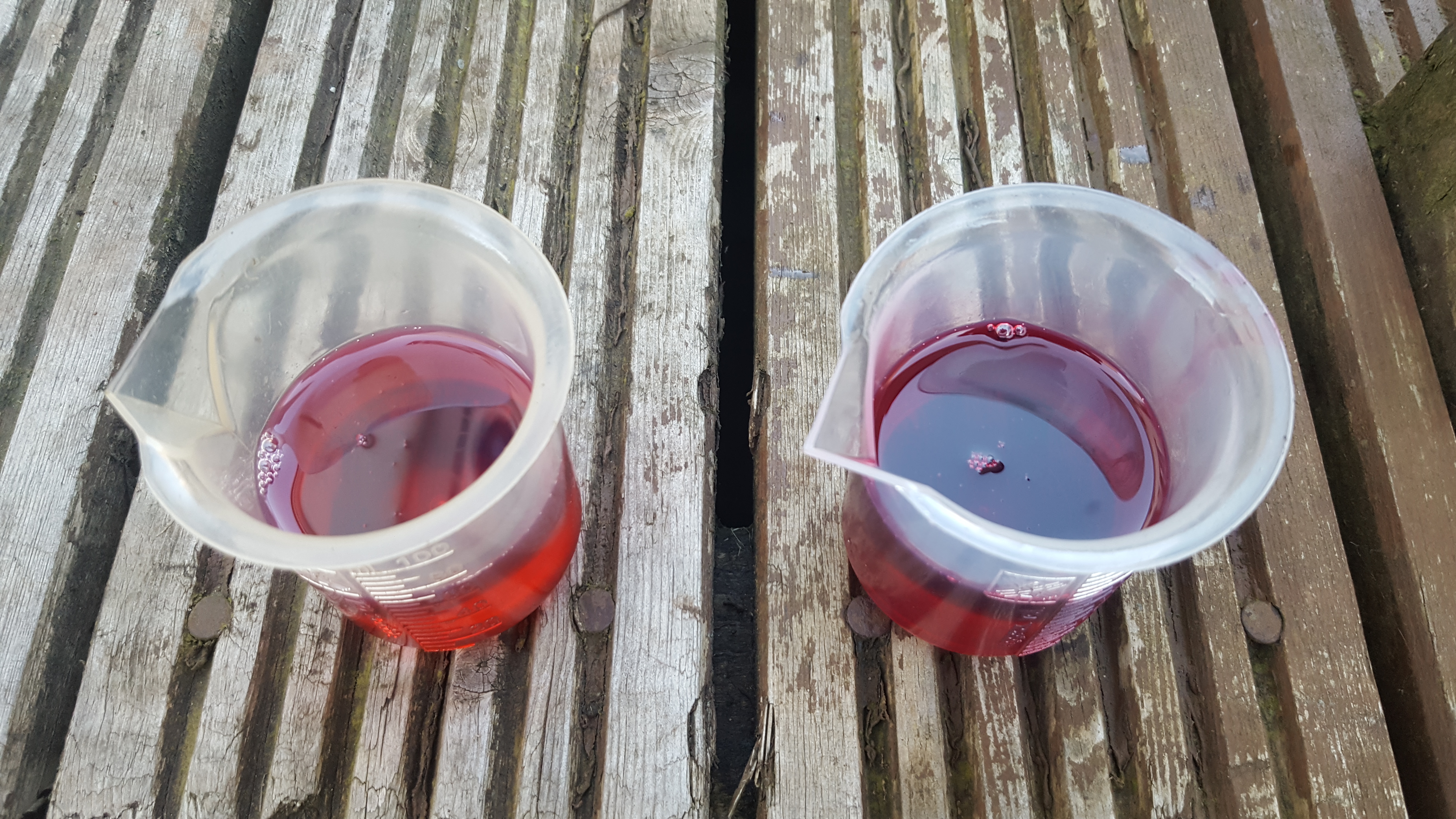

I normally use fully synthetic Castrol ‘racing’ mixed at 80mil of oil to a gallon of fuel. I accidentally bought castrol 1 (not racing) is this still ok to use? It’s a 12 beta evo! Thanks.

That's a lot of oil for 5 litres, I use 60-65, oh and I use the racing as shown in your top photo

Here's a wee secret for ya, see the top bottle, I've been using is at every trial since February, guess what happened when I used it again at a trial today on my bike ??? .....yep....nothing, same as every other time since then.
Seems I'm limited to picture uploads but I have 5 different two stroke oils here....i use them all in equal volume.
