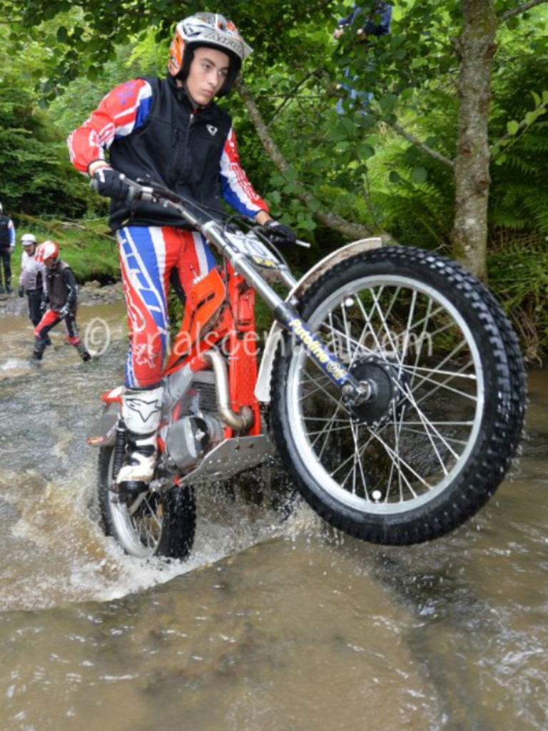

My son on his modded 175 he's used successfully in the Kia experts this year
That looks a little bit more modified than my end game, but it's very cool to see just how far the envelope can be pushed!
Could be he has cut the tubes there, and wants some more strengthening on his welds.  Or it's a mud-guard !
Hi
its just a perforated steel guard painted red, to stop mud build up in the head which in the past has lead to mud shorting the plug out
chris ' yam has has 2 years of development to where it is now and a very competitive bike !
