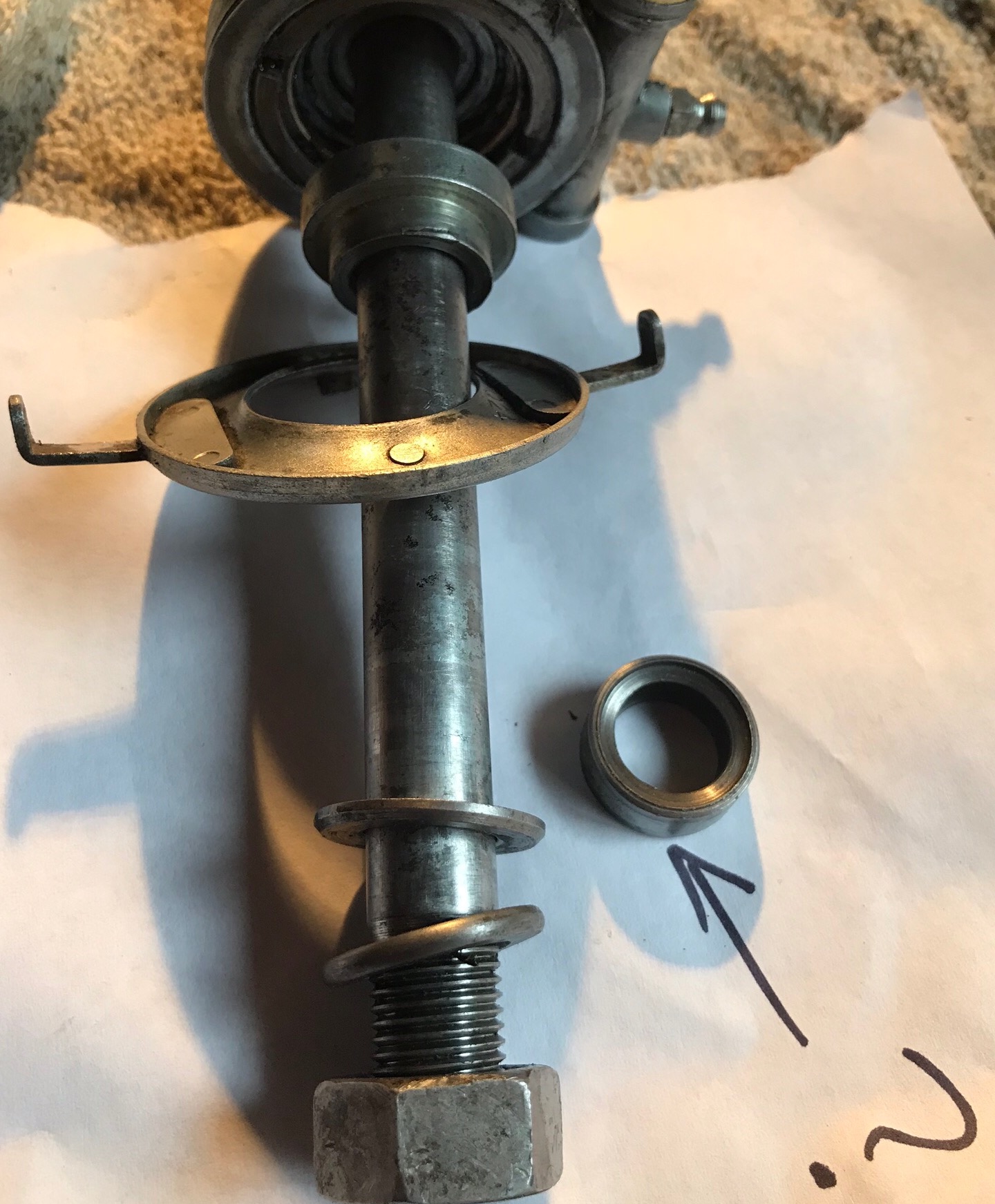

Hi fellows.
We are in the same predicament. As the bike arrived in a parts we are having a hard time figuring out the correct spacer, washer order combo on the front hub. We also have a speedo to fit.
Any pictures or diagrams would be great. The parts Manual we have is not too accurate. Thanks.
