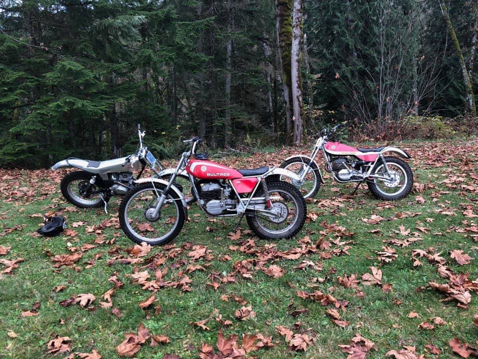

May 6, 20206 yr I have a one off TL 125 frame and I am thinking of installing an adjustable head set like the old boyd and stellings units. It would seem to be hugely adjustable -- but maybe more confusing. Have any of you seen this? Pete Edited May 6, 20206 yr by pinsx3 forgot picture
