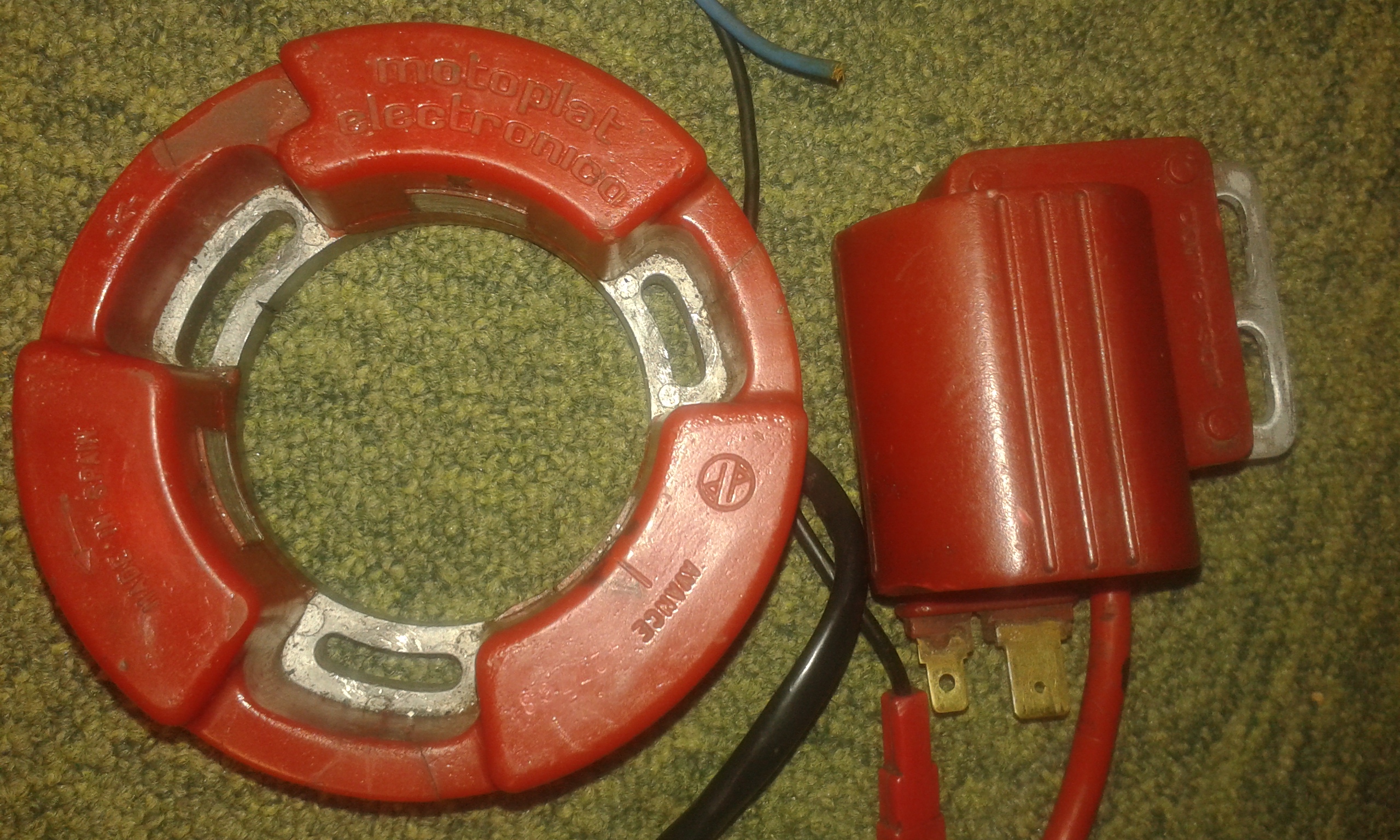

January 24, 20188 yr Okay, so this is not really trials related but I suspect someone on here will be able to offer some advice. I have a Bultaco, Pursang which I have been building and is pretty much all done, however I cannot get a spark from the Motoplat ignition. The ignition is the internal rotor type 63mm rather than the external rotor trials type. I have taken some measurements and referenced them, the coil and stator both seem to throw odd values. I have tried contacting UK Motoplat both via website and Ebay listing but no reply has been received. I have also tried West Country windings who tell me they cannot repair Motoplat. Does anyone know anyone in the UK that could check and repair the ignition or suggest a good (economical) replacement? I do have an external rotor Motoplat but the crank taper is different and will not fit. Coil (Red lead type) Large terminal to small terminal 35.5Ω Large terminal to ground plate – Small terminal to ground plate – HT lead to ground plate – Stator (Diode symbol embossed) Blue lead to black lead 10.7Ω Blue lead to ground plate 128.6Ω Black lead to ground plate 142.5Ω Thanks

January 24, 20188 yr Author Thanks for that pschrauber, i will look through. Do you know how his English is? The ignition is electronic, attached photos. I know there are lights fitted on the bike but there is no lighting coil on the ignition but was planning to a separate total loss with LED bulbs as the would hardly be used.
January 24, 20188 yr I’ve seen this with motoplat before. The resistance values seem about right but I’m not 100% sure. But the real issue isn’t with the resistance of the windings within the sealed coil block. It’s the capacitor that stores the electrical charge. As the flywheel spins it induces ac electrical voltage within the winding. That voltage generated is to be stored in the capacitor until another trigger type coil fires and tells the capacitor to shunt it’s current to ground (or in this case an ignition coil) I’d bet if you are able to actually spin the engine up fast enough you’d probably generate spark because you are able to create enough stored energy in the capacitor to make the system work. Problem is it won’t last. The capacitor is worn out. The coating around it is allowing current to leak out. This is why it won’t work. There are several places worldwide that can repair motoplats. A google search can turn them up. This is a common problem with older electronic equipment. And usually is easily and permanently fixed. Ironically the best best preventive maintenance for this problem is to ride more !!! That’s right the more use the electronics get the longer they will last. Steve
January 24, 20188 yr I don't think it has to do anything with capacitaors, These are regulary just mounted to point's ignition to cut off voltage peaks generated by the points so they don't burn themself away while operating. It's an electronic ignition, so there won't be any capacitaors, instead thrysistors wich are well cast inside the coil with also have electronics inside. See here: http://www.motelek.net/zundanlagen/motoplat2.html I would discuss this issue with Ewald, and to his English I don't know but think he can speak some English at least, try to keep sentence simple and short, I would too suggest to speak slow and pronounce well then it should be hopefully not too dificult. Oh and he has an heavy Austrian dialect this will have an impact in his English speech too...
January 24, 20188 yr Yes a thyristor will be used to trigger the voltage collapse of the capacitor. This is why this type of ignition is often referred to as capacitive discharge or CDI. There has to be a storage device of some sort in order for the system to work. Trust me it uses a capacitor that right now isn’t storing energy. Steve

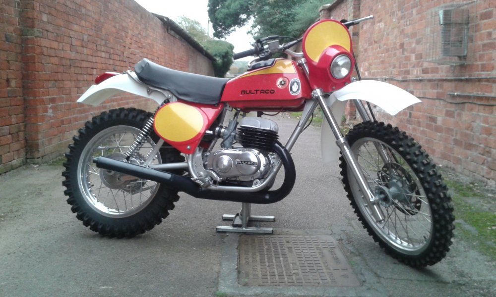

January 24, 20188 yr 2 hours ago, petorius said: Thanks for that pschrauber, i will look through. Do you know how his English is? The ignition is electronic, attached photos. I know there are lights fitted on the bike but there is no lighting coil on the ignition but was planning to a separate total loss with LED bulbs as the would hardly be used. Love the bike , looks like a model 167 mk9 if its a 250 ,with a Frontera tank, is the front end Honda with the disc brake ? .Very nice indeed
January 24, 20188 yr Author Thanks for all your comments, Bradford ignitions (UK Motoplat) was who i was banking on. Bult, you know your stuff, actually a 168 frame but it is Pursang mk9 , forks are modified KX cartridge , KTM wheel, Nissan caliper (thought it would be a good idea to have one brake that worked!). Just want to get the thing running and sell it. It has taken a while to get together and i have lost interest somewhat. Cannot really see me using now. I have a Sherpa/Alpina in the garage waiting for me to decide whether to end up trials or trail (keep changing my mind), which would probably be more use.

January 25, 20188 yr What Stevem75 says about capacitors in CDI ignitions is right but I do not think the motoplat is a CDI type. I think it is electronically (transistor) switched, but in other respects the same as a conventional points switched system. Try PVL ignitions or Karting ignition suppliers.

October 10, 20206 yr On 1/25/2018 at 4:44 PM, dadof2 said: What Stevem75 says about capacitors in CDI ignitions is right but I do not think the motoplat is a CDI type. I think it is electronically (transistor) switched, but in other respects the same as a conventional points switched system. Try PVL ignitions or Karting ignition suppliers. Yes that id right, Motoplat uses transistors and these do fail, sorry for my late reply but I wanted to make that sure as I have come to likewise problems to other ignitions.
