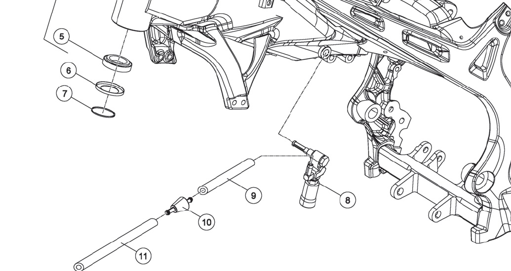

Relatively new to me 2016 EVO 300 4T.  Out riding yesterday, bike was running fine.  Wheelied to a stop in the fork of the tree, and parked the bike in a wheelie position for a few minutes while I did some trail maintenance.  Pulled the bike out of the tree, and couldn't start it.  Assumed I had flooded or starved it.  Finally, after about 50 kicks, got it started.  It ran for a minute then died.  Repeated, got it started again.  It would run at a slow throttle pace, but would bog when I added more throttle.  Thinking I ended up with some trash somewhere in the fuel system.  Before I pull apart the carb, I thought I should determine whether this bike has a fuel filter.  Pulled the parts fiche which shows one in the fuel line between the petcock and carb.  Doesn't exist on my bike.  Is there a fuel filter on this bike, for instance, inside the tank or somewhere else?
Thanks for any help.
Here's what the fiche shows (#10, which isn't present on my bike):
Edited by markbxr400
Item 8 is the fuel solenoid valve, it's held to the fuel tank/frame with a banjo bolt. That banjo bolt should have a nylon screen screwed into the end of it to filter the gasoline. On the side of the solenoid valve is a small lever that will rotate. One position is "Automatic" the other is "Manual", which is the bypass position. "Auto uses electricity from the bike's 12 Volt system to open the solenoid valve, which is only generated while the engine is running. If you need to open the fuel supply with a dead engine, use the "Manual" position. For example, when the bike is dropped and the engine has quit, all the gas may drain from the float bowl. On my 2009 "Auto" is up, "Manual" is down. Check your Owner's Manual for your year to be sure.  Cheers.
I have a 2013 300 4T and it does have the in-line filter you refer to.  If it stalls or falls over in a section it is more difficult to start and I often resort to "manual" (lever down) on the fuel solenoid.
Having said that once it starts up it runs fine.
As your bike runs at low throttle it may be that its starved of fuel.  Try running it with the fuel tap open (lever down) and the petrol cap removed, just to check the tank breather is not blocked.
After that suspect you will need to remove and clean the carb.

You haven’t flooded the air filter element with fuel or engine oil from the breather, this will certainly cause the issues you have. Sediment may also have blocked the carb idle jet. Next time, unless you’re doing a Dougie Lampkin and wheeling round the Isle of Man park your bike on the side stand etc?
