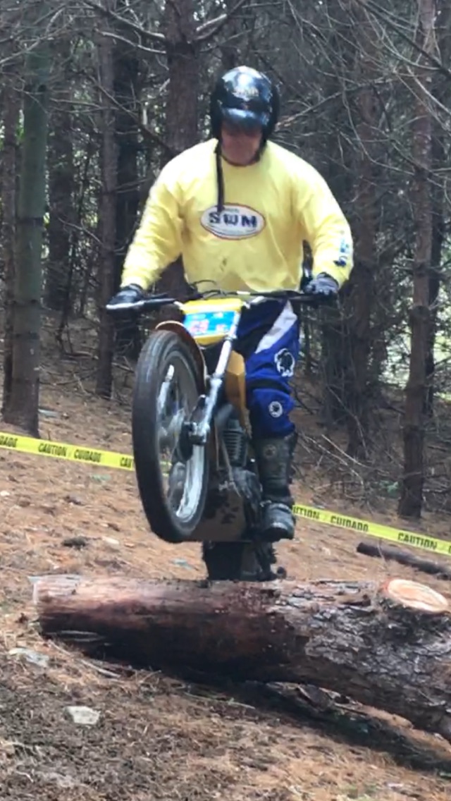

  • I had a great Trials last Sunday! It was the last NYACT event of the season. My 1980 SWM worked great! I might also try higher bars or bar risers.

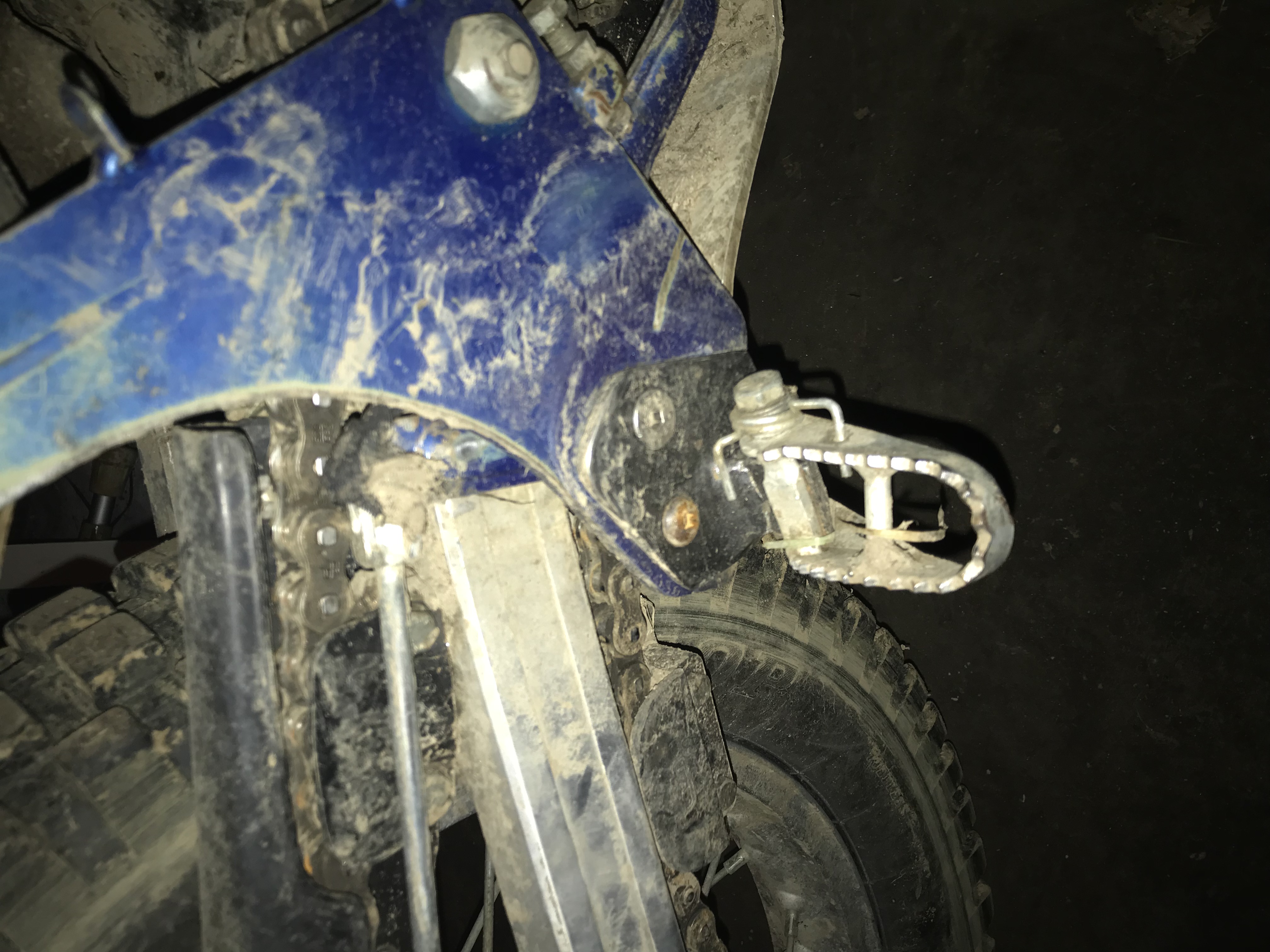

Instead of welding on the chromoly I made some plates from mild steel to relocate the pegs. Didn’t want to go radically back myself but it would be simple to make multiple plates to experiment with different  positions. I utilized the stock footpegs for kicker clearance. Oh,and don’t go so low on the peg position that the saddle contacts your leg above the knee when you lean the bike into turns as it will pull your body inside the tire contact patch.
  This is a great idea too! Do you notice much of a difference in width?

I actually kinda like the narrower side to side width as it allows easier access to the end of the footpeg as I lean the bike. wouldn't mind a bit more for and aft width but also like the look of stock pegs so just not worrying about it right now.
On my 1980/81 that I'm rebuilding. I moved the new foot pegs as low and far back as I could, I used my MIG welder. I didn't add any extra metal. I bought these pegs from Martin at MotoSWM. For some reason I'm not allowed to download anymore pictures.
My modified 80/81 foot pegs.
