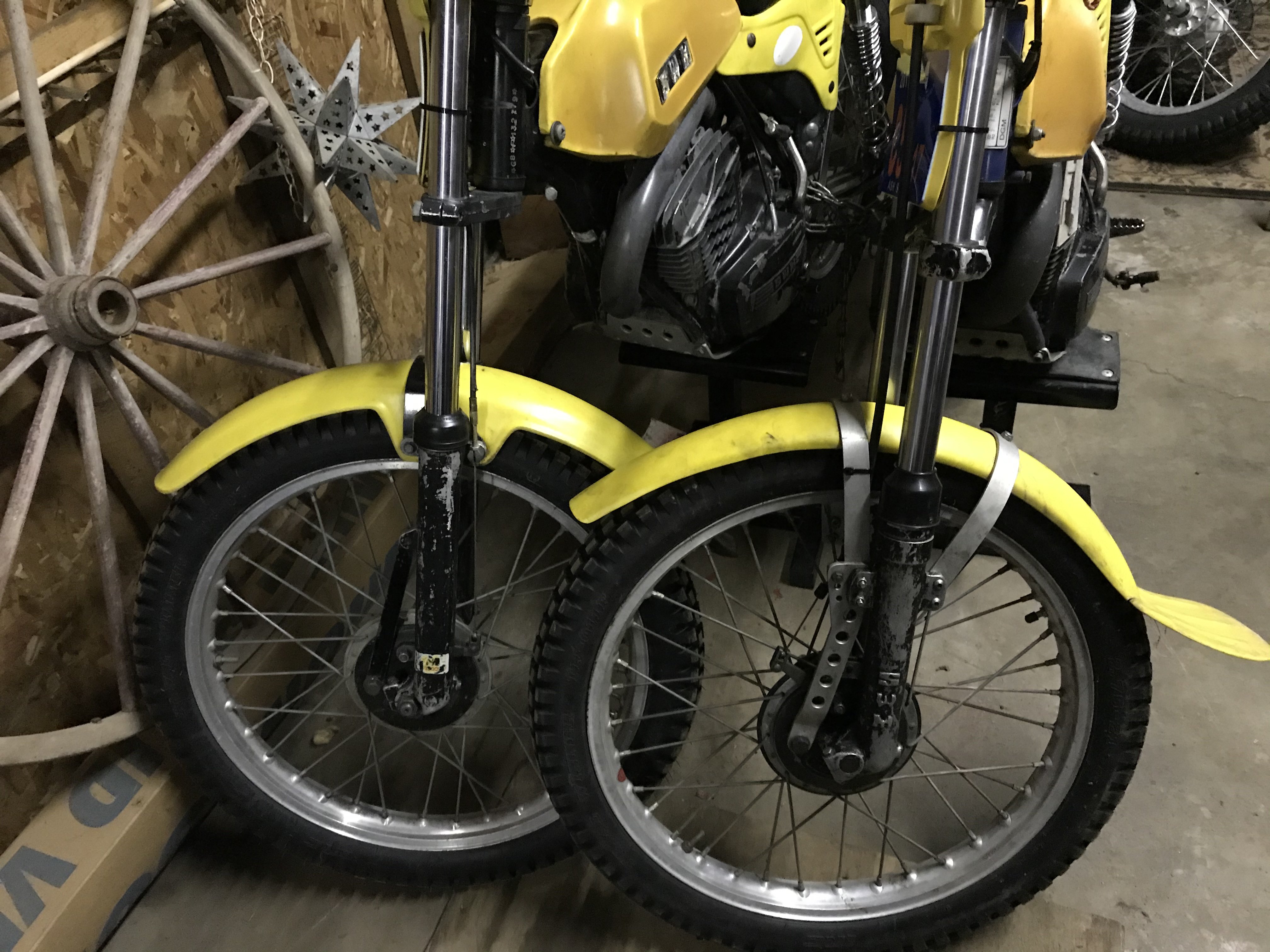

 I remember someone posting that a good set up on my 1980 SWM 320 with Marzocchi forks is to keep the Marzocchi triple clamps and use the Betor forks? I realized that my spare/project 1980 SWM 320 has the Betor forks and triple clamps. Would it be worth it for me to put the Betor forks (after I go through them) on my competition bike with the Marzocchi triple clamps?
The 1980 Marzocchi's (imo) were not the best, check the betors are the same length, they are reckoned to be better. Whether you use the betor yokes probably depends on your height. If your taller than 6ft, I'd go for the Marzocchi's.
The Marzocchies are not bad forks they work quite good it is all about the wear and how straight the stanchions still are.
Gilles Burgat started to replace the Marzochi front fork of his 1980/81 SWM because of two reasons:
-  the Betor fork at less stiction and
- the Betor is a shorter in length and the Marzocchi forks a a bit longer too the yokes | triple clamps mount is a bit higher then to them  of the Betor fork.
Thus the front will be slightly lowerd which will put some extra weight to the front wheel.
With more weight at the front the (in my experience in our sand sections) bad behavior of the SWM pushing the front wheel
straight while doing a tight turn with slight throttle is then in my experience a bit eliminated, for our super techical and thight
sections on loose ground very helpful.

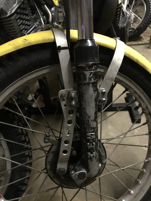

Here is the brake set up on my 1980 TL320 competition bike.

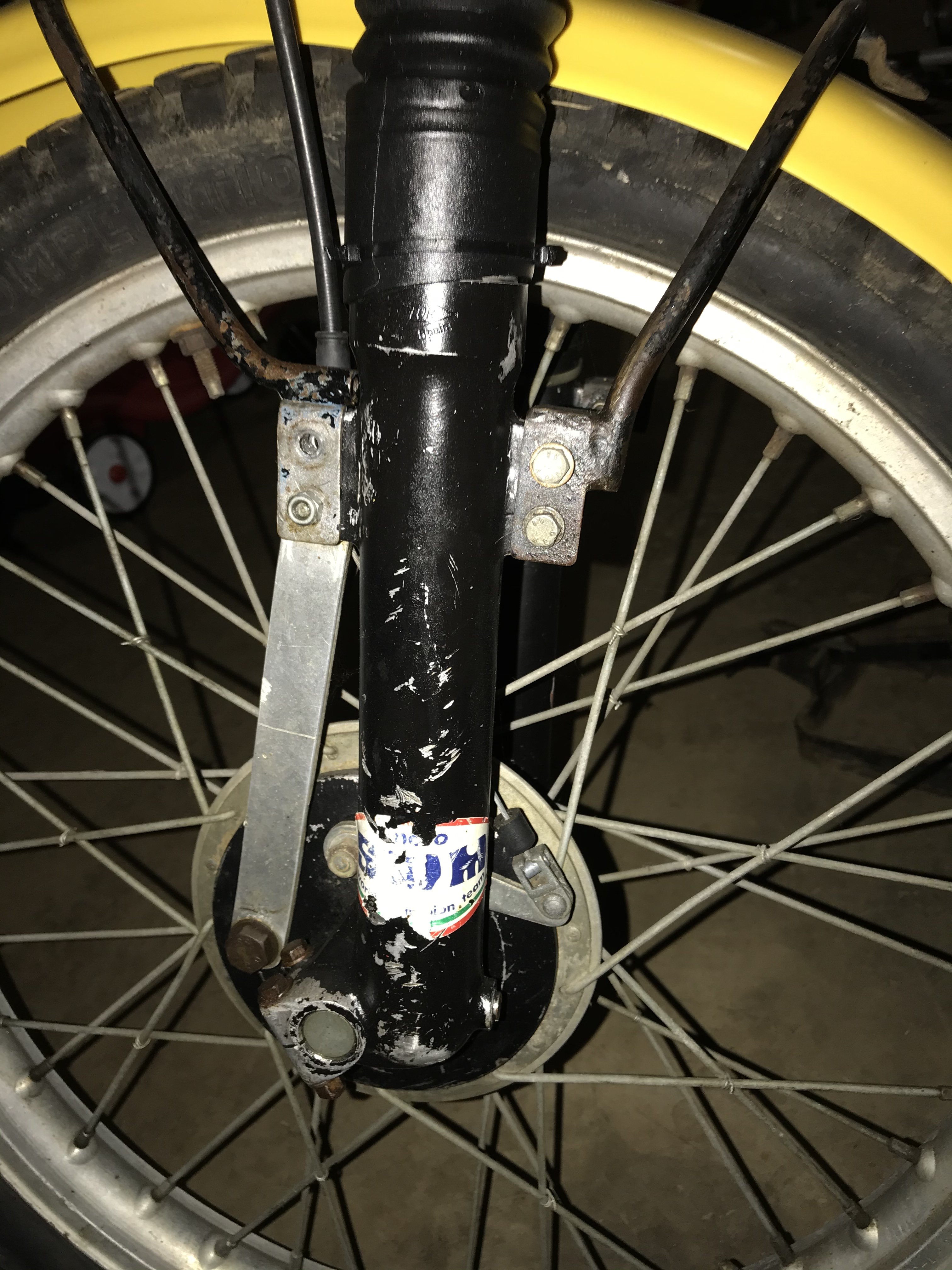

Here is the brake set up on my 1982 TL320 spare bike.

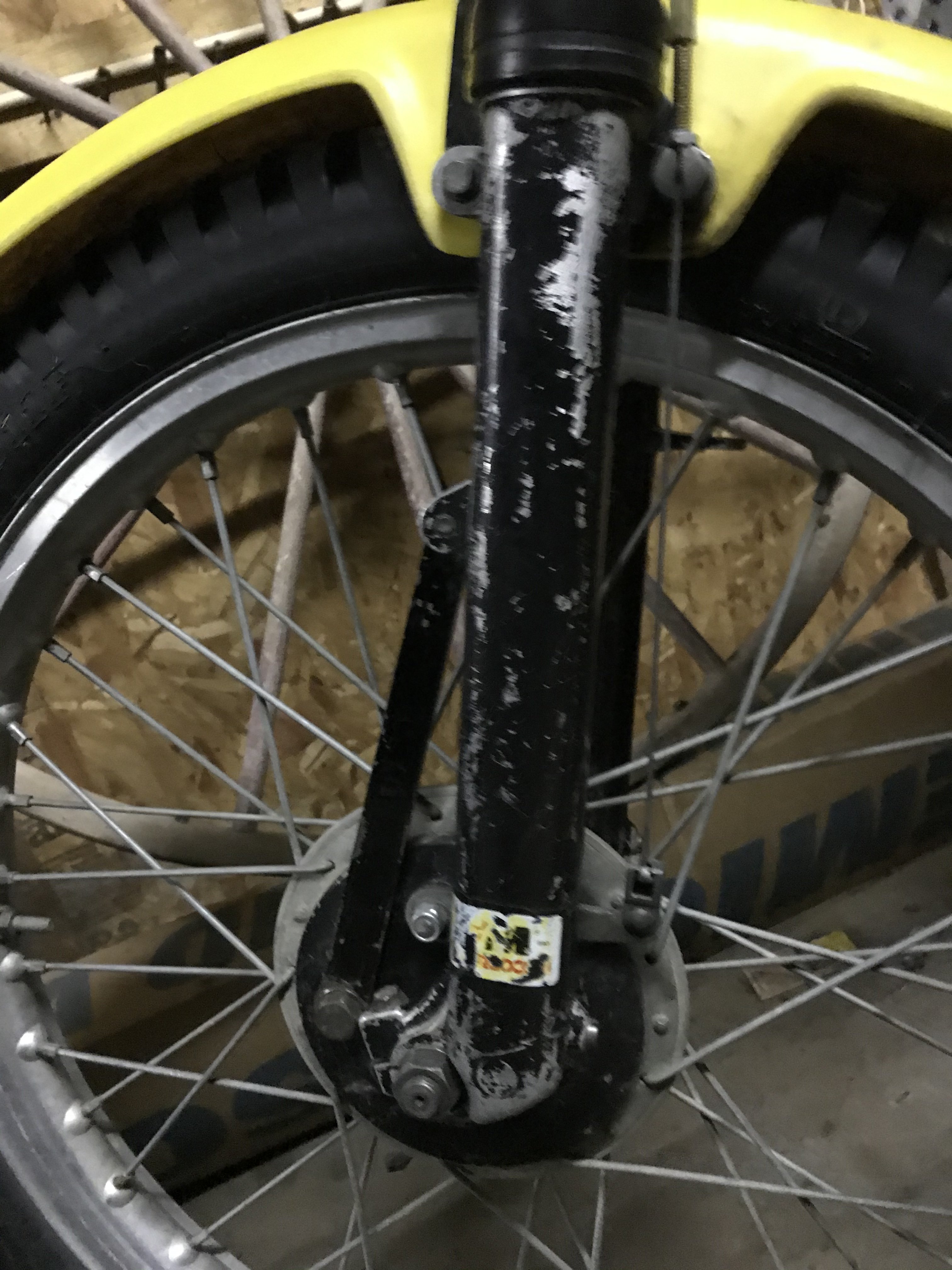

Here is the front brake set up on my 1980 TL320 project bike with Betor forks.
I have done this switch on my 320, I have marzochi yokes with betor stanchions.
1, The marazochi yokes have handlebars mounted closer to the centerline of steering axis, so steering allegedly feels quicker ?, not sure I've felt the effect but hey!.
2, the Betor stancions are about 25mm shorter than the marzochi, so again pulling in the front overhang and quickening the steering feel.
Ps the Fantic marazochi yokes have different bearings, and hence a different stem in the yokes.
I might try the Betors off my spare bike, I will need to install a new fender and fork seals. I guess my SWM could turn a little sharper. Might help my results. I just wish I could find a spare set and not take them off the other bike.
