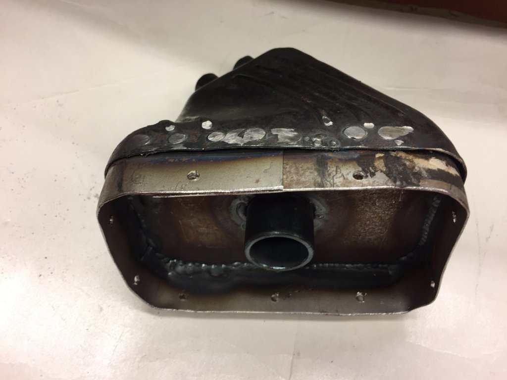

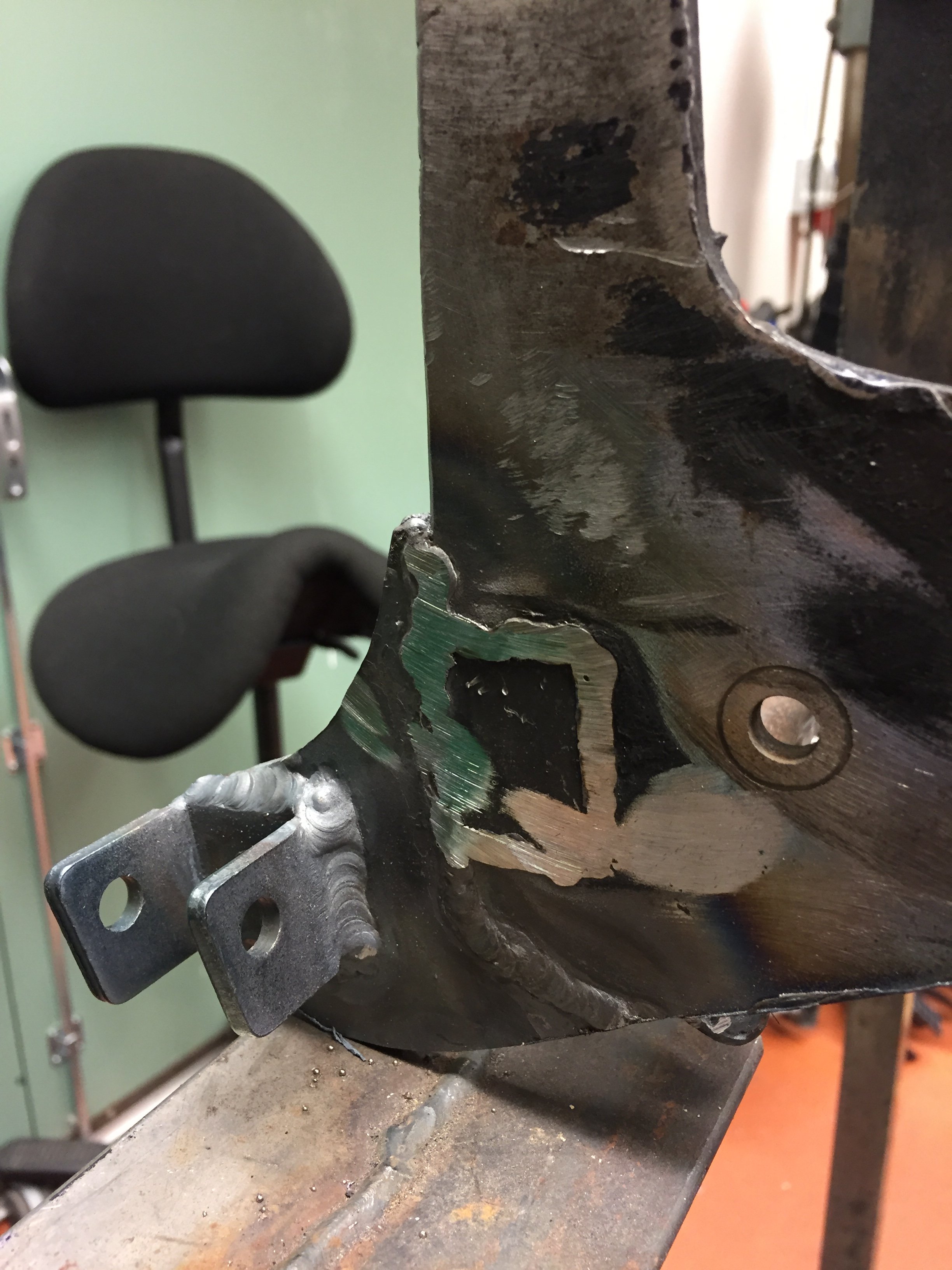

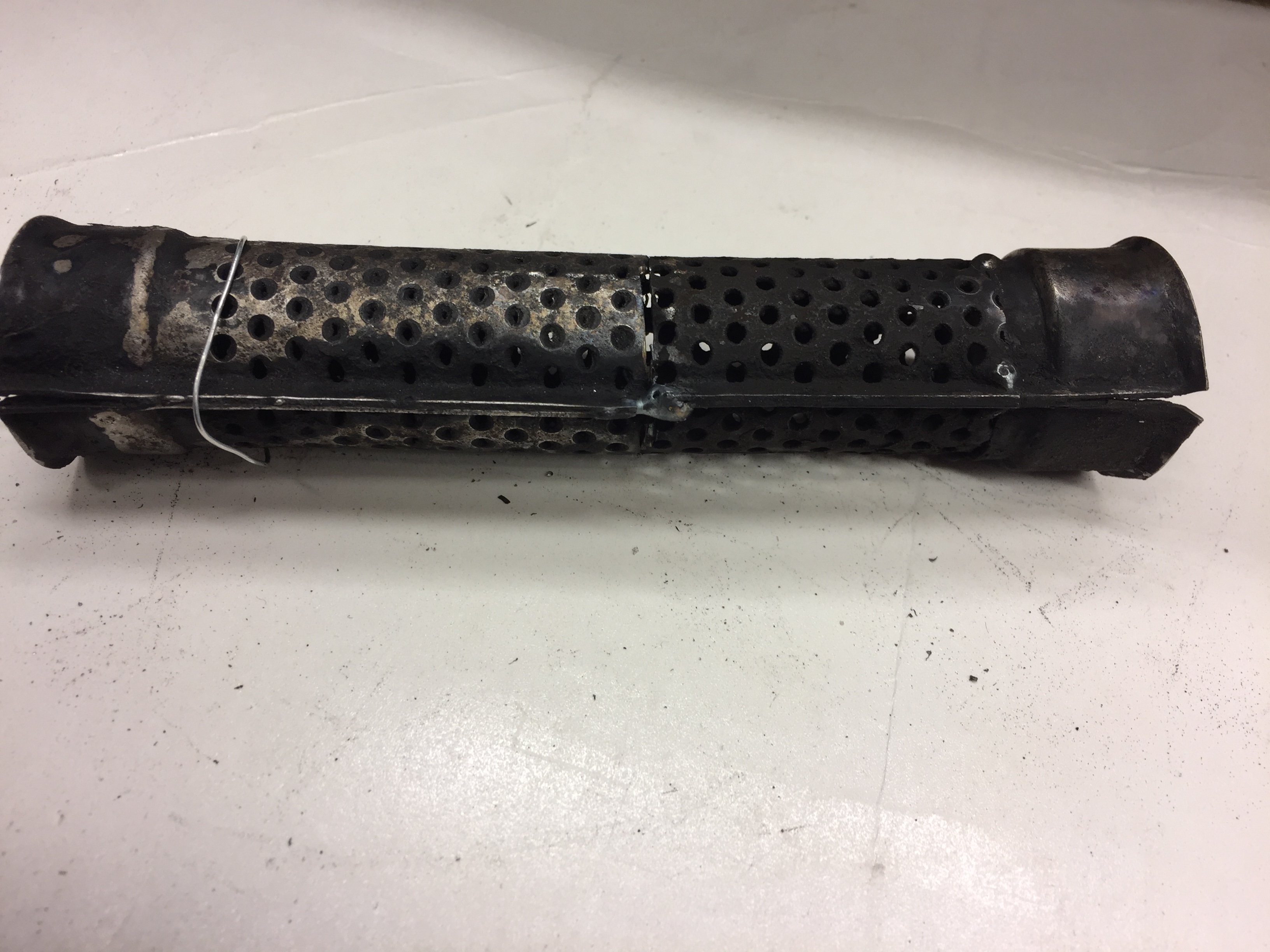

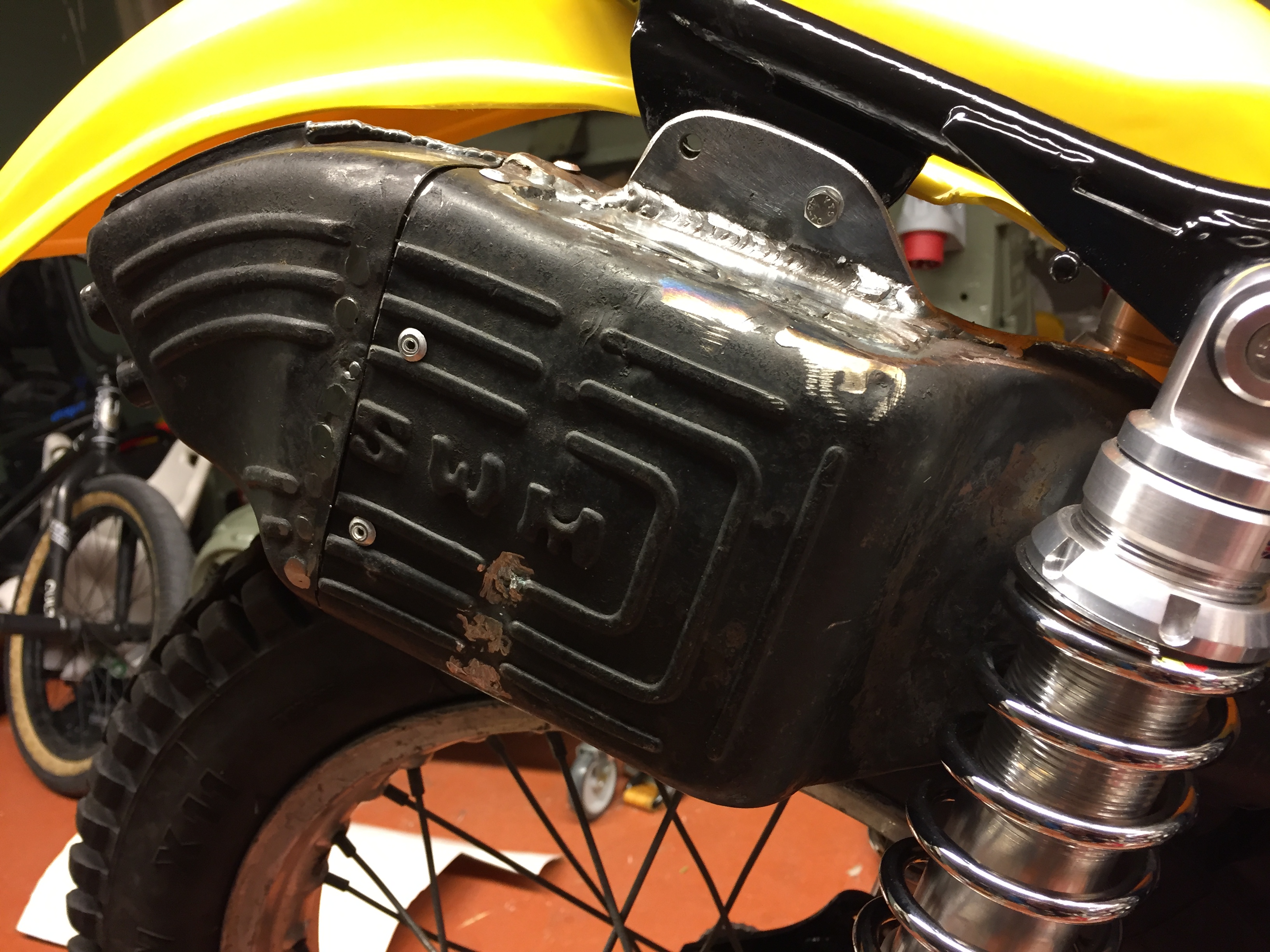

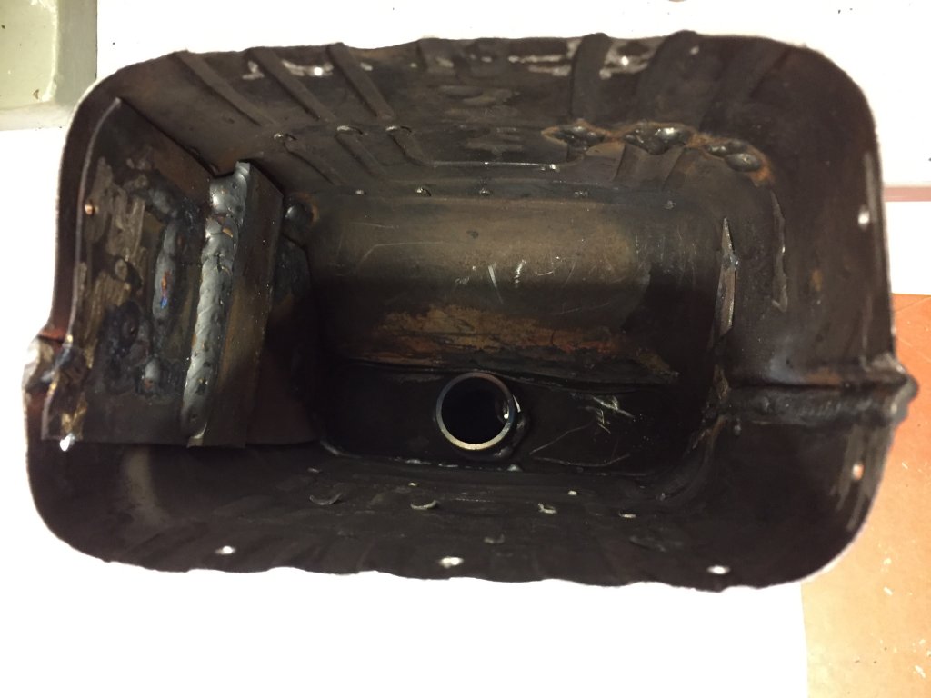

I agree with b40rt on most issues, specially regarding the footrests. Use CrMo plate of the same thickness as the side plates and TIG the bits in place, pre-warm the plates and keep them warm, making the plates and welds cool down slowly (check for any sign of cracks after every ride during the first couple of weeks).
However, regarding the midbox and rear silencer, a bit more work than b40rt suggest is well worth the effort. Cut them both up longitudinally with a thin disc and start removing whats inside. Repack the midbox with good hi temp insulation and reweld. Then, cut out everything inside the rear silencer and cut off the rear part as shown. Get a bit of perforated pipe or make one up, to fit between the inlet and a new wall in the rear part. Weld the front part longitudinally and do the same with the rear part. Then, weld the new wall in place in the rear part, as shown. Finally, fit the perforated tube into the front part and fill up with insulation before riveting the two parts together, then paint.
I have kept the original twin outlet pipes on this one, but you can also try a bigger single pipe if you like (louder and less back pressure). The silencer shown here is almost as quiet as the original, but is a much better starting point when tuning for better power delivery all through the rev range (porting, ignition timing, carb set up and so on). Of course, you could use any modern mx type silencer instead, but a little visual cheating can be nice, or....?

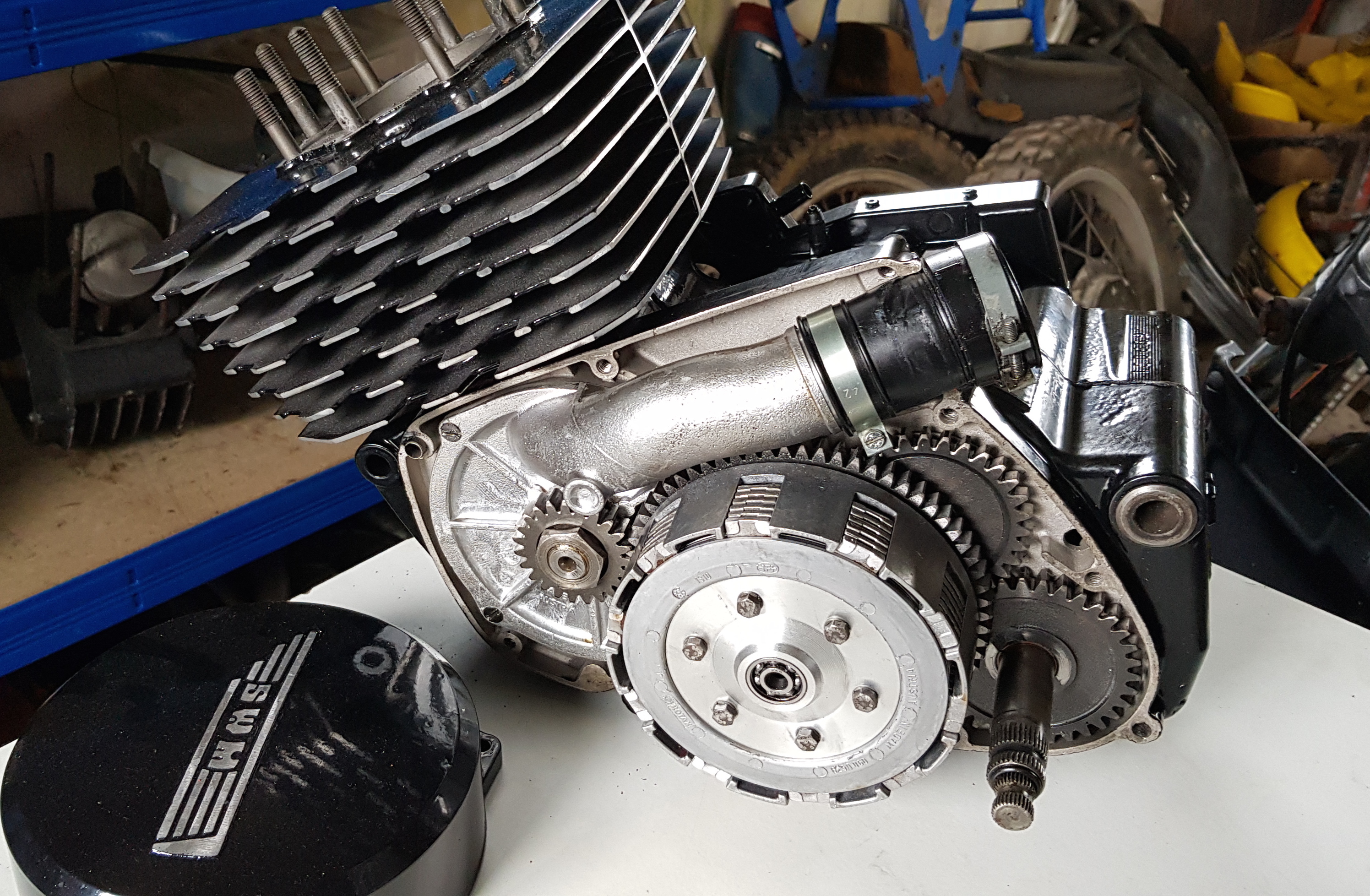

If you find an Aprilia TXR or Climber clutch cover, make sure you get hold of the clutch pressure plate and the centre hub, makes it feel about 20% lighter over the standard SWM parts
I have been looking for those Aprillia parts with no luck!

 Thanks for the info and pictures! This is awesome information! I’ll have a few projects this winter!
 How does the bike sound compared to stock?

I didn’t realize the frame was chrome moly, I don’t have a tig welder. I guess I better have the shop weld it.
