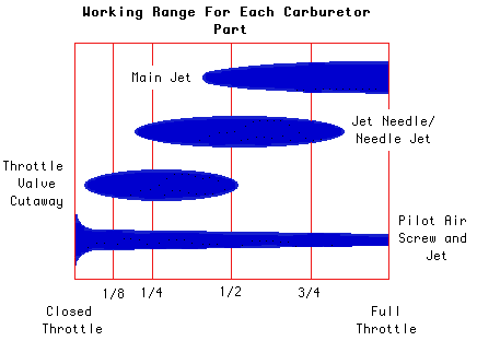

 Here is one of the best graphs for understanding jetting. Everyone always forgets the pilot circuit is on 100% of the time. Across the pond we tend to jet the pilot jet richer, seems in the UK they go right to replacing the slide. Must be the difference in fuel.
Edited by lineaway
What is the original source of that chart?
