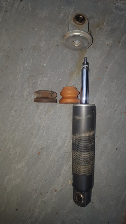

October 25, 20197 yr I thought the Bump stop was looking a bit tatty but until I compared to a new one I realize it was long overdue! this was on a 2004 Sachs shock and probably the original rubber. Note! The picture is only a comparison not how the shock is reassembled the rubber is fitted the other way up.
October 25, 20197 yr Author I made a clamp to grip the shaft in the vice. I ended up using a bit heat on the aluminium because they have put loc-tite on the thread. Use a good spanner on the square section of the Ally mount and shock it loose then it unscrewed easily. (normal right hand thread) Also when the mount is off the damping adjuster screw can be removed to clean and lube it. Edited October 25, 20197 yr by richt detail added
October 25, 20197 yr Your old one IS knackered but it was quite common to cut down the bump stop to give more travel before bottoming out. I used to cut about 10mm from the bottom (not the tapered end). Also the damping adjuster was set all the way out and NEVER altered. Not as good quality wise as the Ohlins but always seemed to work well on the GG. Reiger shock and updated linkage on the 2012 was the first improvement in 10 years. Edited October 25, 20197 yr by bumpy_ltd
October 25, 20197 yr Here's an excellent video from Cascao on rebuilding the Sach (and shows how to remove the bottom mount to replace the bumper). There are English subtitles which you can enable. There's a thread on ADV/Trials which is also very good: "Rebuild the Unrebuildable Sachs ZF Shock = GasGas and Other". Edited October 25, 20197 yr by d2w
October 25, 20197 yr Author 5 hours ago, bumpy_ltd said: Your old one IS knackered but it was quite common to cut down the bump stop to give more travel before bottoming out. I used to cut about 10mm from the bottom (not the tapered end). Also the damping adjuster was set all the way out and NEVER altered. The damper screw on mine has always been wound fully out as well. I couldn't tell if my old rubber had ever been cut down but its compressed and gone rock hard. Exactly like you said "IS knackered" While the spring and the rubber were removed, I checked the damping was consistent through the total length off the stroke which was spot on. Edited October 25, 20197 yr by richt

January 14, 20206 yr Use aluminium ou other soft material to clamp the axle. You will need a good clamp custom made for this stem diameter. Clamp the axle on the clevis nearest part. Where seals are less likely to go Heat can damage rebound screw O ring. Maybe you will need replace them It is a good opportunity to change or lub dust seal. Just pop the shock cap off. Edited January 14, 20206 yr by cascao
January 14, 20206 yr Author You don't need to do anything with the rebound screw until after you get the bottom mount off. The screw can only be removed afterwards. I didn't need to get it very hot it's more a case heating it quickly to expand the aluminium before the steel rod and it breaks the "loctite" on the threads. The o-ring on mine was okay but I changed it anyway. Edited January 14, 20206 yr by richt
