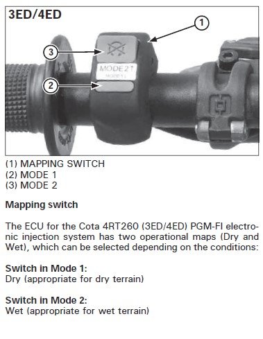

sportsawyer Posted February 25, 2020 Share Posted February 25, 2020 The map switch modes are reversed between the 300RR / 301RR and 4RT260 models. 1 Quote Link to comment Share on other sites More sharing options...

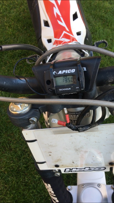

lineaway Posted March 8, 2020 Share Posted March 8, 2020 So did you ever turn the idle up? Quote Link to comment Share on other sites More sharing options...
54tphill Posted March 8, 2020 Author Share Posted March 8, 2020 no I didn’t , ??♂️ Do you still think that’s the problem ? Quote Link to comment Share on other sites More sharing options...
jonnyc21 Posted March 8, 2020 Share Posted March 8, 2020 (edited) 1 hour ago, 54tphill said: no I didn’t , ??♂️ Do you still think that’s the problem ? if you haven't check the RPM at idle is at least 1800' when warm it really could be the issue. That is not 100% for sure but well worth making sure before calling it a more complex problem. Edited March 8, 2020 by jonnyc21 Quote Link to comment Share on other sites More sharing options...
lineaway Posted March 8, 2020 Share Posted March 8, 2020 1 hour ago, 54tphill said: no I didn’t , ??♂️ Do you still think that’s the problem ? 2 Quote Link to comment Share on other sites More sharing options...
