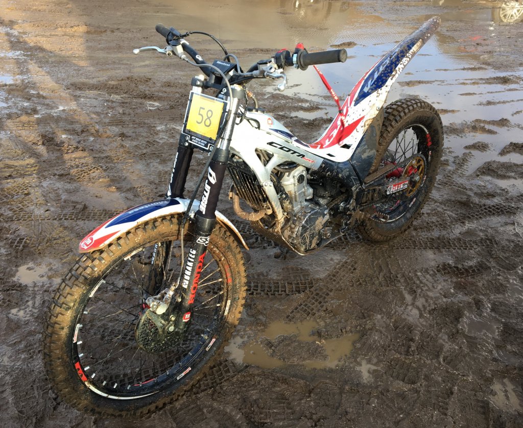

54tphill Posted February 23, 2020 Share Posted February 23, 2020 Help please , I was riding in a trial today and whilst in a section my 4rt just cut out, I couldn’t get it to restart, did the usual reset but no joy, it was like as if I’d ran out of fuel but I hadn’t. I Retired and went home. Any ideas ? Quote Link to comment Share on other sites More sharing options...
jimmyl Posted February 23, 2020 Share Posted February 23, 2020 Any more info- have you had anything in bits before hand etc sounds a strange one . lanyard cables, deep water etc etc Quote Link to comment Share on other sites More sharing options...
54tphill Posted February 23, 2020 Author Share Posted February 23, 2020 No the bikes not been in water, muddy wet day, been through a couple of decent puddles. The bikes had a lanyard switch fitted the some day a bought it. Cheers for your help Quote Link to comment Share on other sites More sharing options...
2stroke4stroke Posted February 23, 2020 Share Posted February 23, 2020 Is it sparking? Quote Link to comment Share on other sites More sharing options...
misscrabstick Posted February 23, 2020 Share Posted February 23, 2020 Basic checks, compression, spark, fuel. You could have a wet wires issue, a component failure such as a fuel pump, You could remove the injector leave it plugged in, kick it and see if it squirts? Quote Link to comment Share on other sites More sharing options...
lineaway Posted February 23, 2020 Share Posted February 23, 2020 Your idle is set too low. This happens all the time. I believe you turn it out. Try 1/2 to a whole turn. Quote Link to comment Share on other sites More sharing options...
jonnyc21 Posted February 24, 2020 Share Posted February 24, 2020 As lineawy indicated adjusting the idle is an easy check and worth a quick try. As above check spark, if you have that then the next in my mind is compression because its an easy check and then fuel. However with what you indicated I would expect it to be spark or fuel as compression usually would show up as early starting or other hard running issues first before just not starting. My 2 cents on how I would look into it... If you do not have spark I would try disconnecting the kill switch and checking spark again, if still no spark start checking the wires and see where you might have a loose wire or wet connectors from the muddy conditions. If you have a gauge to check compression I would do that next just because its quick and easy. Now If you have spark I would use a 12 v battery to check the fuel pump, if that works then continue down the line to see if you have fuel coming out of the injector. If you hit a wall with all of the above let us know. Quote Link to comment Share on other sites More sharing options...
kevin916 Posted February 24, 2020 Share Posted February 24, 2020 Had exactly the same problem with my son's 4rt. Turned out to be faulty lanyard switch. Good luck ! 1 Quote Link to comment Share on other sites More sharing options...
b40rt Posted February 24, 2020 Share Posted February 24, 2020 And try a new plug to eliminate that. 1 Quote Link to comment Share on other sites More sharing options...
54tphill Posted February 24, 2020 Author Share Posted February 24, 2020 Went in my garage to try kick the 4rt up today, didn’t kick up so I did a reset doing the 3 slow kicks with the throttle open, then tried again, 2nd kick it’s burst into life, I let it run until the fan came on. So it seems it’s fixed it’s self??? Quote Link to comment Share on other sites More sharing options...
duggan Posted February 24, 2020 Share Posted February 24, 2020 Definitely sounds like the idle is a touch low, this can make them very temperamental to start. 1 Quote Link to comment Share on other sites More sharing options...
