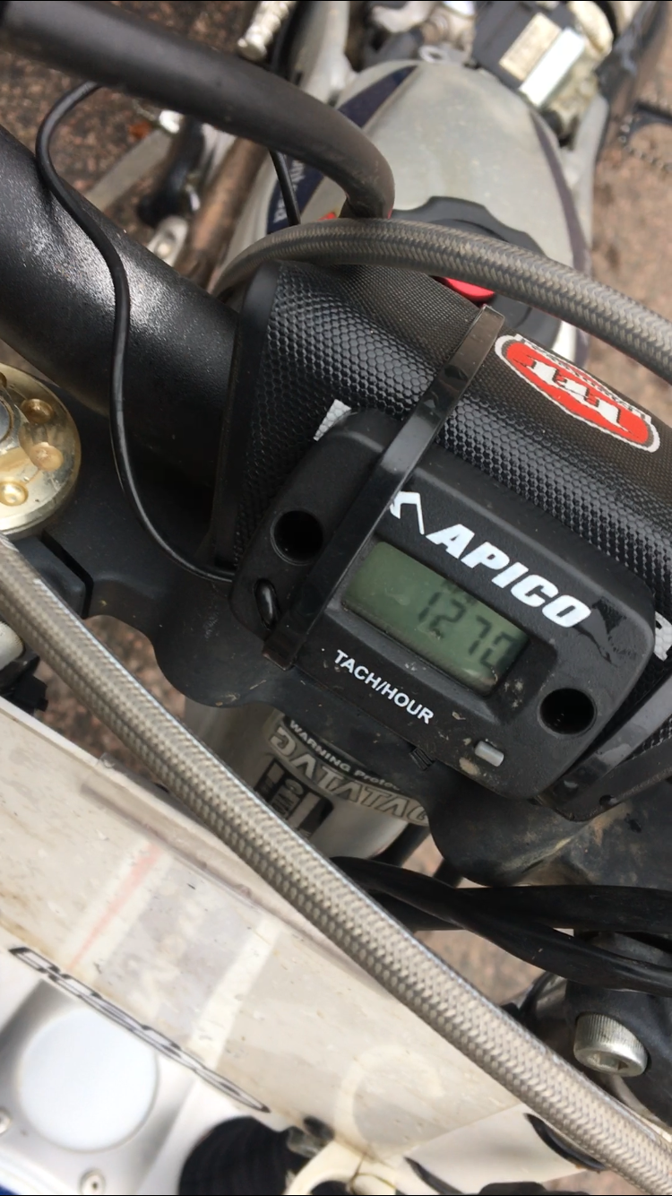

My bikes playing up again, rode it 2/3 times for 3 hours a ride, now it’s started stalling/cutting out again, this thread was originally about my bike.
I’m thinking maybe my ecu is faulty, everyone kept saying about the idle so I did fit an Apico hour meter/rev counter but with lock down the bike wasn’t used for a while.
everyone was saying the rpm needs to be 1800, I fitted the Rev counter after I had tweaked it,
the rpm only shows 1270 but it’s loud, like it’s reading it wrong ?
It’s been fitted exactly how the instructions say. If I turn it up it’ll get to 1500 then cut out, turn it down to 900 and it’ll cut out, at 1200 ish it runs ok but occasionally tries to cough, the revs dip randomly. Sometimes I’m riding through a section and it’ll just cut out.
I must have bought the most unreliable 4rt in England. .....
33 minutes ago, thall1 said:
Have you actually tried setting at 1800?... it is quite loud... very similar to a petrol lawnmower!
Yes i can Not get it to 1800, at 1500 it sounds like it’s going to ride off on its own but then it cuts out hence it must be wrong!

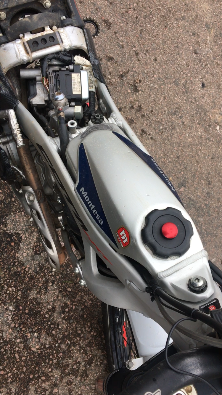

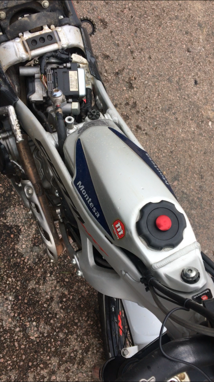

After all this, have you tried running the bike with the gas cap off? It could not be venting properly. Every trials bike seemed to have venting problems in 2018 for various reasons.
That’s an interesting idea, it did actually start playing up after I fuelled up, so you think the cap on the top of the tank could be causing an issue ?

I agree with lineaway to remove the no spill cap and see how things go.  The two times I have tried one for any of my bikes I have had some kind of issue and ended up deciding not to do it again, no issues sense.
