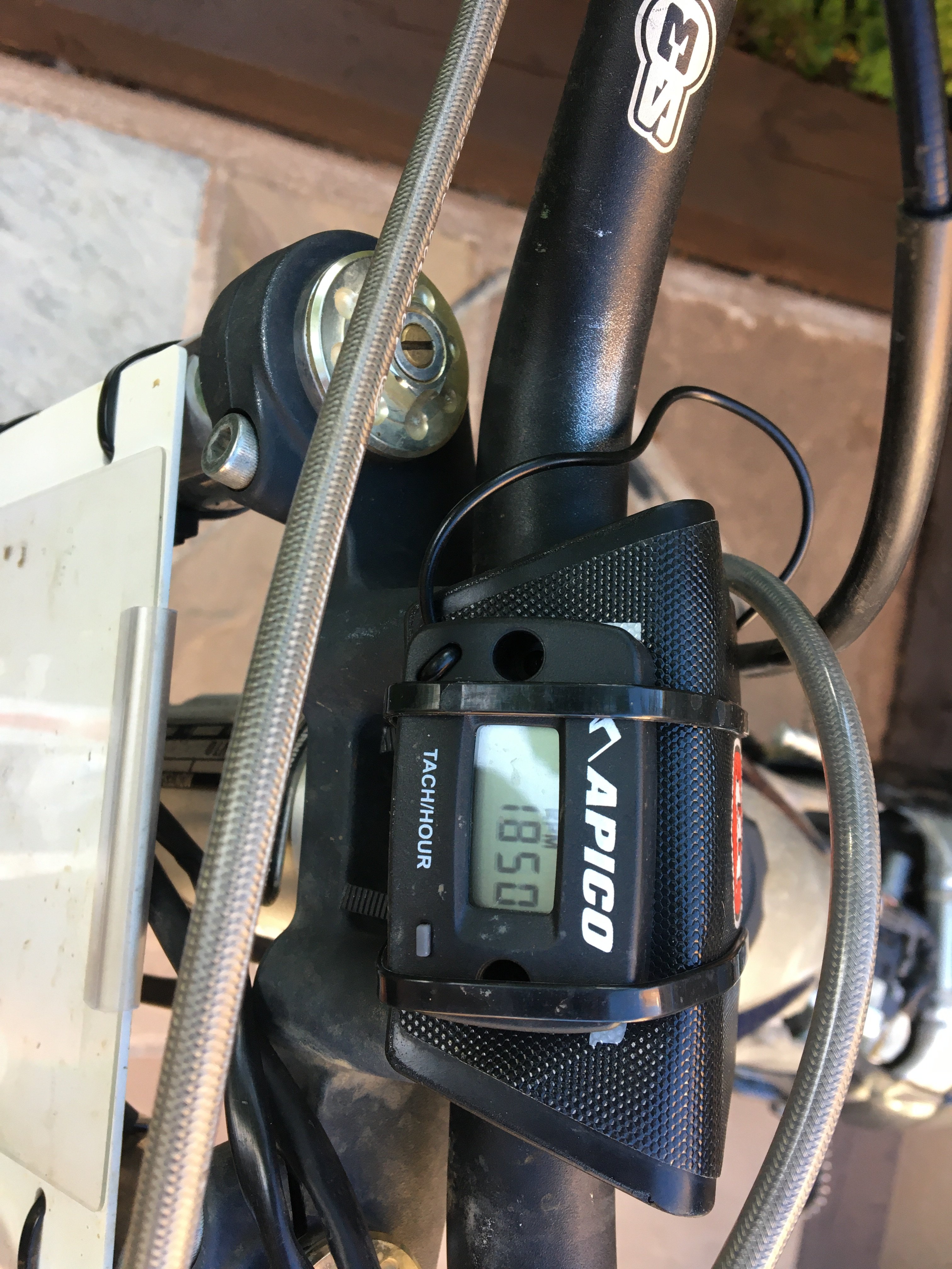

I’m thinking maybe my ecu is faulty, everyone kept saying about the idle so I did fit an Apico hour meter/rev counter but with lock down the bike wasn’t used for a while.
everyone was saying the rpm needs to be 1800, I fitted the Rev counter after I had tweaked it,
the rpm only shows 1270 but it’s loud, like it’s reading it wrong ?
It’s been fitted exactly how the instructions say. If I turn it up it’ll get to 1500 then cut out, turn it down to 900 and it’ll cut out, at 1200 ish it runs ok but occasionally tries to cough, the revs dip randomly. Sometimes I’m riding through a section and it’ll just cut out.

99F722C7-C213-4040-B6F1-4D8E23798A8B.pngYou can switch those tachs for different pulses  mine I had to adjust to p2 to read correct  and if it is a gas cap if you top off the tank and it acts up right away then I would drain most of the fuel out and see if it takes longer to have issues or wha

How do you change the pulse ? Cheers
If it seems it’s reading twice as fast as it should then set at 925 rpm
Dunno - never had one - just do it by ear and then a bit more for good luck ?
I probably run mine higher to minimise any chance of the famous four stroke cough

As for the hour/tach there should have been a set of instructions that tell you how to deal with RPM's being double what they should be.  (I think I remember it was a HardLine unit you got? If so this is a link to their current instructions: https://www.hardlineproducts.com/wp-content/uploads/2015/12/8067-2download.pdf)
RPM Section:
Changing Spark/Pulse Input:
While in Tach mode, press and hold button until until “1P:1r” appears on the display.
Release button if this is the desired mode. Hold button to view more selections.
“1P:1r” indicates that the meter is set for 1 Pulse per 1 revolution.
“1P:2r” indicates that the meter is set for 1 Pulse per 2 revolution.
“2P:1r” indicates that the meter is set for 2 Pulse per 1 revolution.
If your RPM reading is double what it should be at idle you need to select “2P:1r”
Refer to your owners manual for correct idle RPM.
Hope this helps.

Right might be getting somewhere now, I’ve held the button down On the Rev meter and changed It, it the went from 1200 to 2400 so I’ve turned it down to 1820, removed the red tank cap thing and kicked the bike up and watched it for a while on the patio , 1820 btw is map 1 and to my surprise in map 2 which I thought was a slower anti skid map it increases the Revs to 2040.

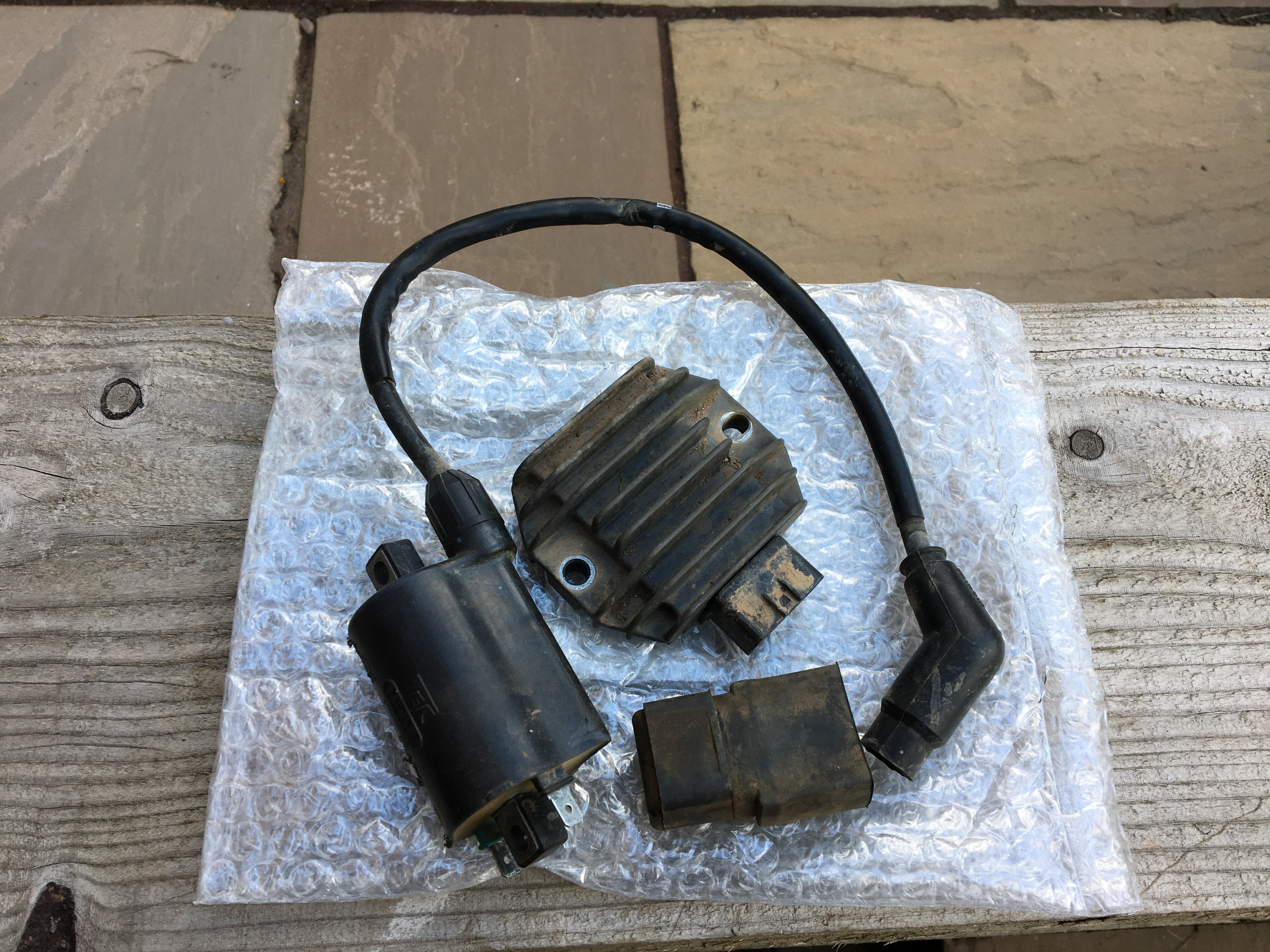

Ok the the part with the wire for a spark plug is the coil , the middle part with the fins is the fan relay ? And the smaller part is the rectifier ? All 3 parts were changed April 2019, bike was 2 months old at the point....
The capacitor is mounted vertically on the rectifier plate... it’s a little smaller than a ‘c’ size battery. It’s tight to the air box so the air box and throttle body needs to come out I think.
