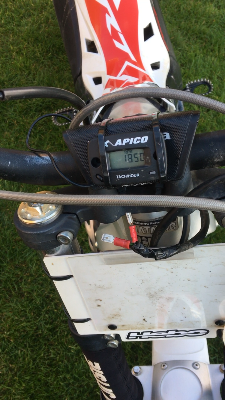

Ok I’ve spoke to a few people and considered what you guys on here have said,
I was told that the rpm needs to be 1850 when fan is on. It is. Still coughs, in fact just pulling the bike out the garage this evening and running it again it cut out twice in first 6 minutes
i noticed the Revs started off a bit lower like 1740, is that normal? The revs do go up and down a bit on start up
ive taken the fuel cap breather off
so that’s ruled out
I’ve disconnected the landyard as people have said they can be an issue But it cut out and after a few minutes
so that is ruled out
Any other ideas ?
