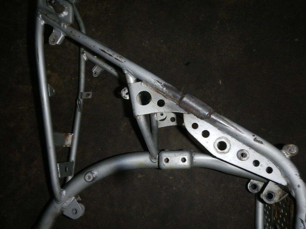

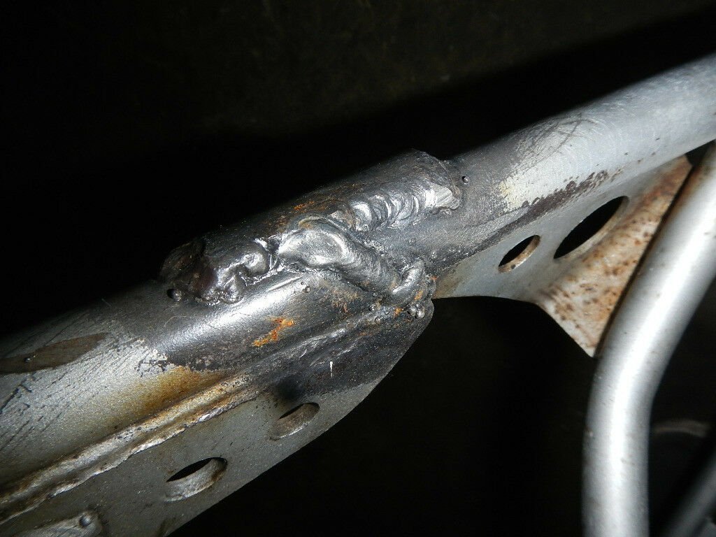

That said, of the two possibilities I'd recommend the TY for yourself.  IMO the TY is beautiful aesthetically.  As you mentioned, it is lighter and a better handler from my own experience.  My own RL felt kinda snappy and unpredictable.  I eventually had some porting work done to smooth things out which, from recollection, didn't really... though my wallet felt a bit lighter in the end.  My biggest issue living with the RL was the way that it turned (or didin't) when in the tight stuff .  The front would regularly push and... this may sound strange, but the bike felt really long... as if the wheelbase was significantly longer than it needed to be.  Possibly psychological but it didn't seem as precise as what I was used to (Bultaco M80 and a Ossa MAR).  The final turnoff for me was that my frame cracked on the left side subframe tube, just above the pivot plate.  Seems it's a common issue with the RLs and the one you're considering is no different.  Looks like there was some repair work performed to address the issue, from what I can see in the photo.  Check it out closely when you pay the owner a visit.  I've attached a couple of photos "borrowed" from an auction site listing showing a repair that was performed to this area.
