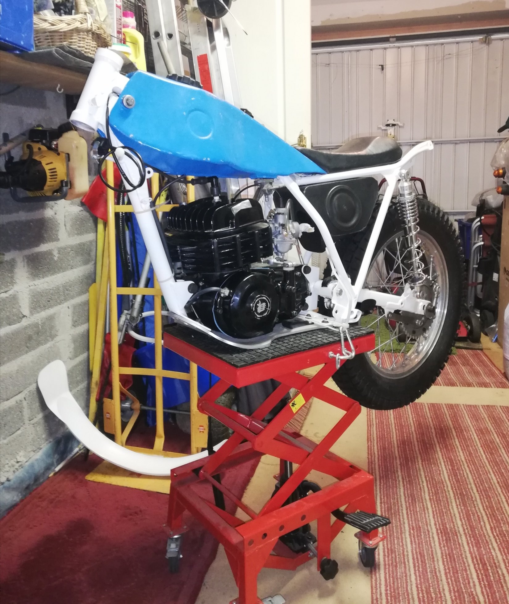

In the midst of my Covid199B restoration.
