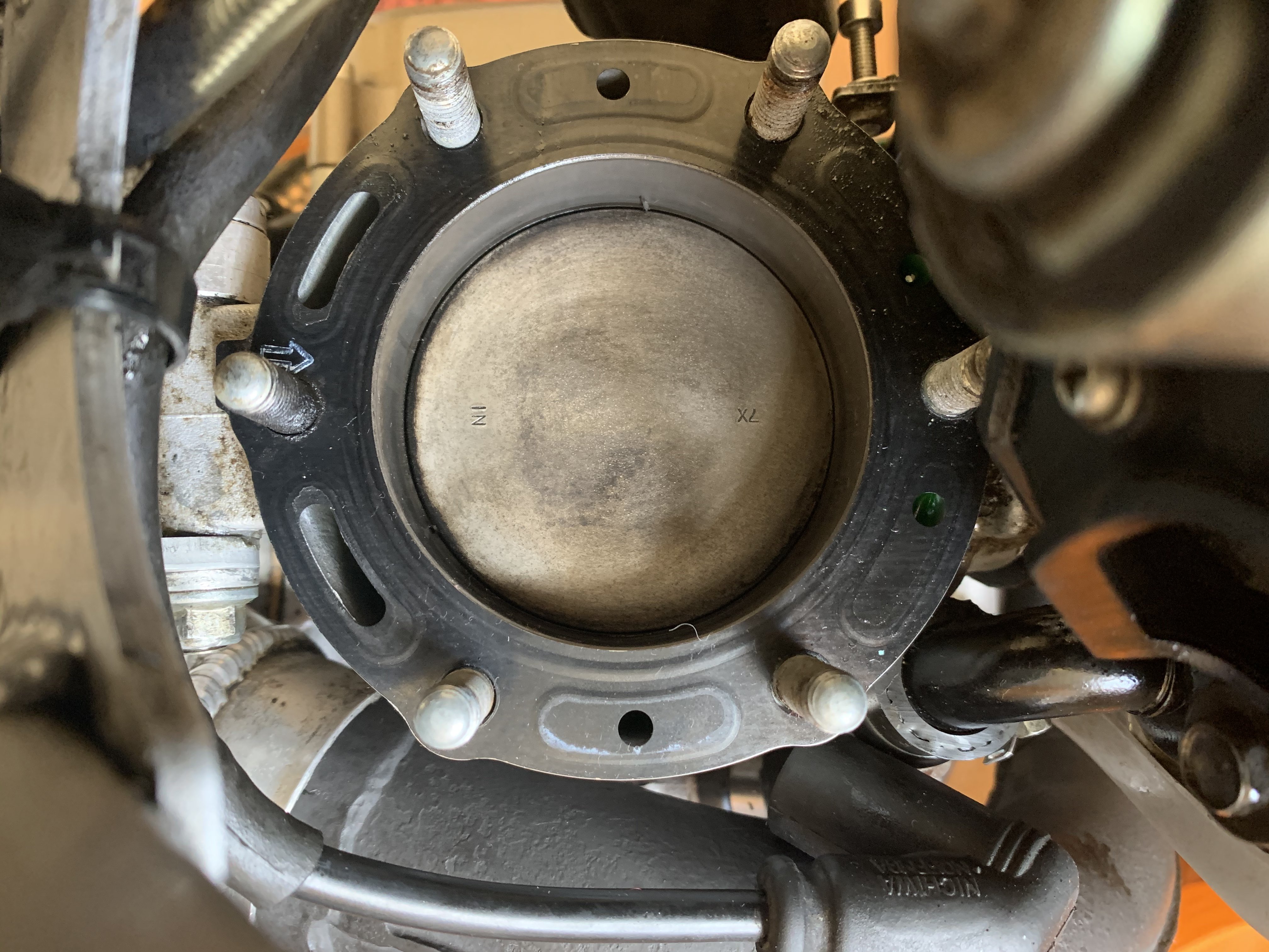

Can anyone tell me what piston this is?i was told it would be printed with the letter a,b,or,c on it.Really struggling to get the piston kit I need.And she’s smoking badly also spitting oil out of exhaust.....Help...
Might be stamped on the barrel - above the gearbox sprocket  - seem to ring a bell.
Does the bore look worn  - damaged  - might just need rings .
If its just smoking and blowing out oil are you just putting too much into the fuel - is it sounding rough or down on power.
If oil mix is ok check crank seals to make sure its not drawing oil in from there
Oil coming out of the exhaust has nothing to do with rings or the piston on a two stroke. Jimmy is correct its either too much oil in the petrol or the crank seals are gone.
If its constantly running at very low rpm it may just need to go for a blast down the road.
its hard to tell from that picture but the piston & bore look ok?

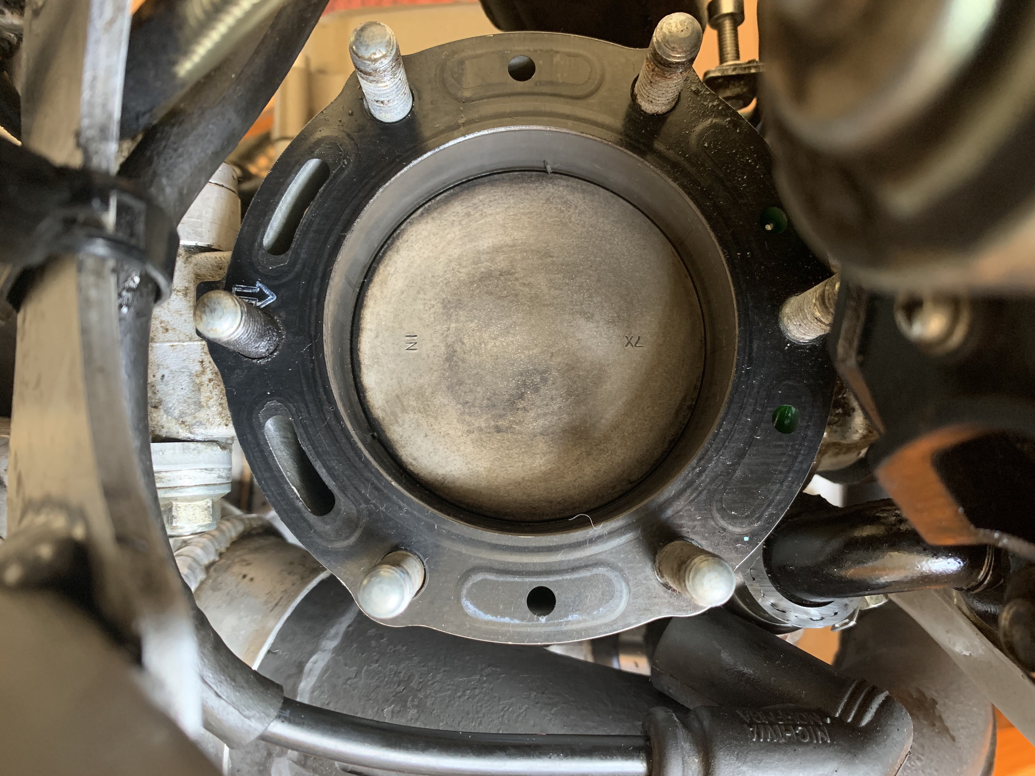

take a picture with the piston all the way down

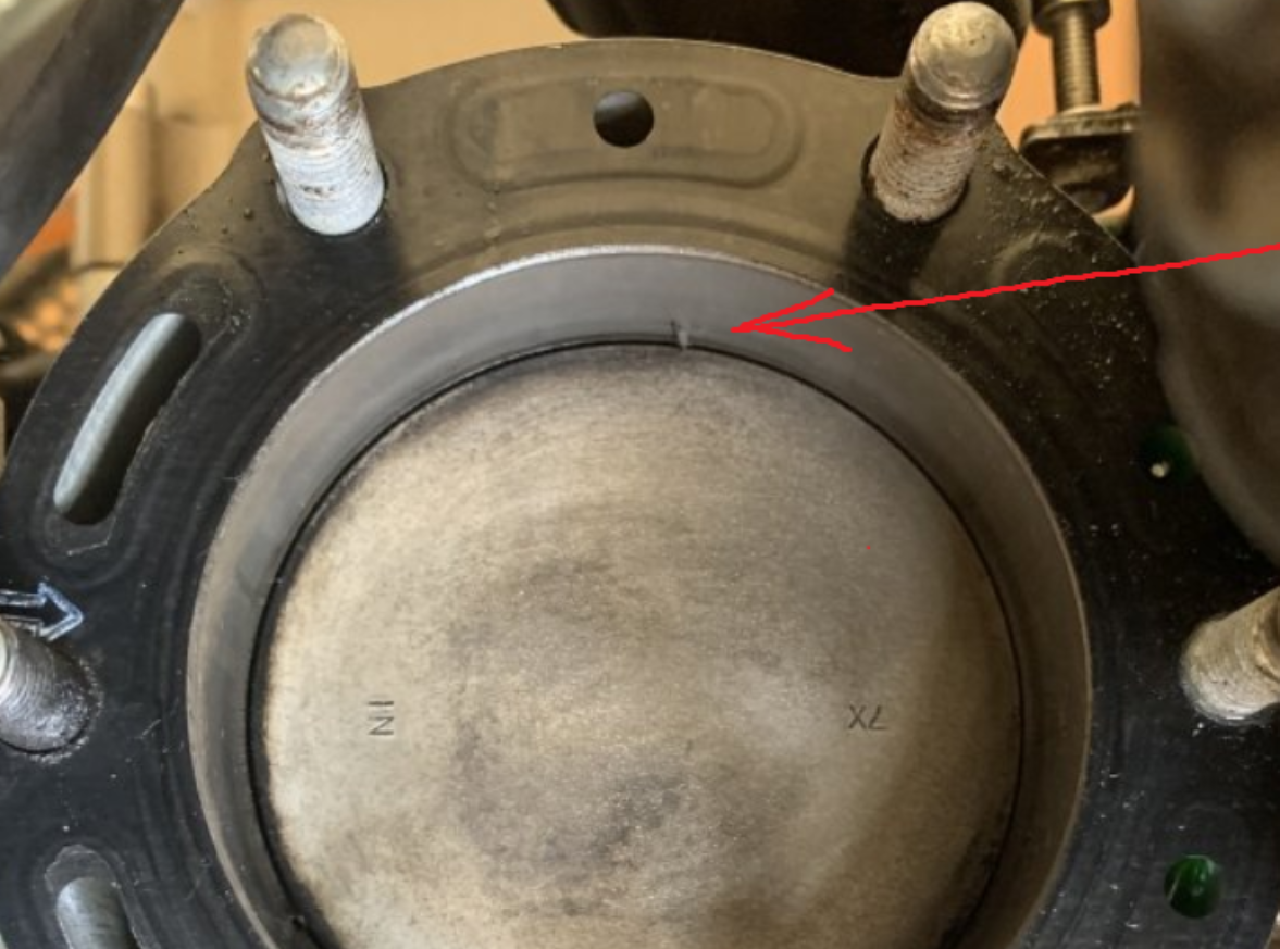

Looks like a single score mark on zooming in
Think its dirt as its hiding the ring.
The piston was full of black sludge when I took the barrel off.I was hoping for a quick fix?
You may well get one not involving a new piston. Apart from smoking badly and oil coming out of the exhaust are there other symptoms ? When a new piston is required the engine will rattle at tick over. If it's not doing that then it doesn't need a piston.
