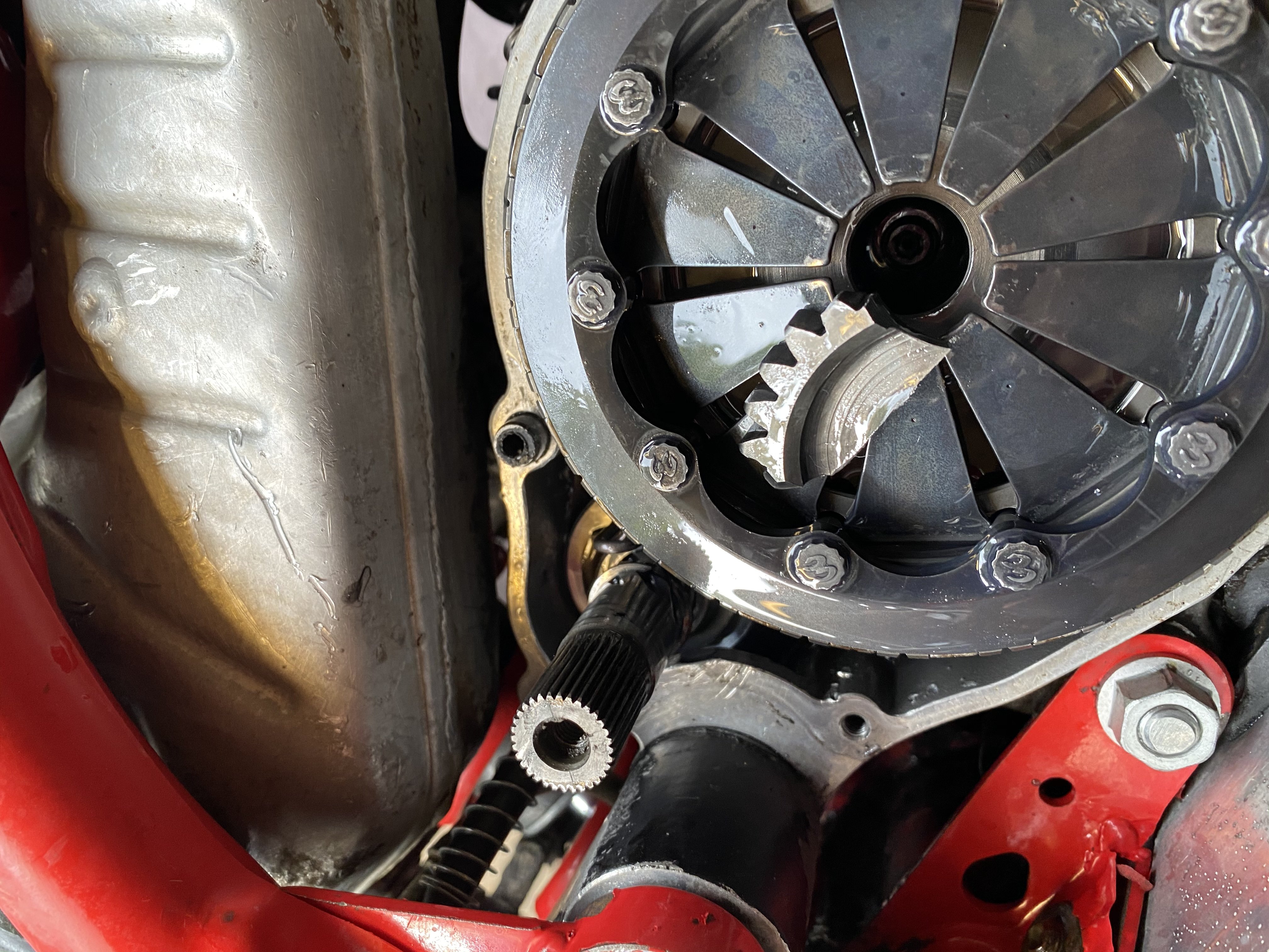

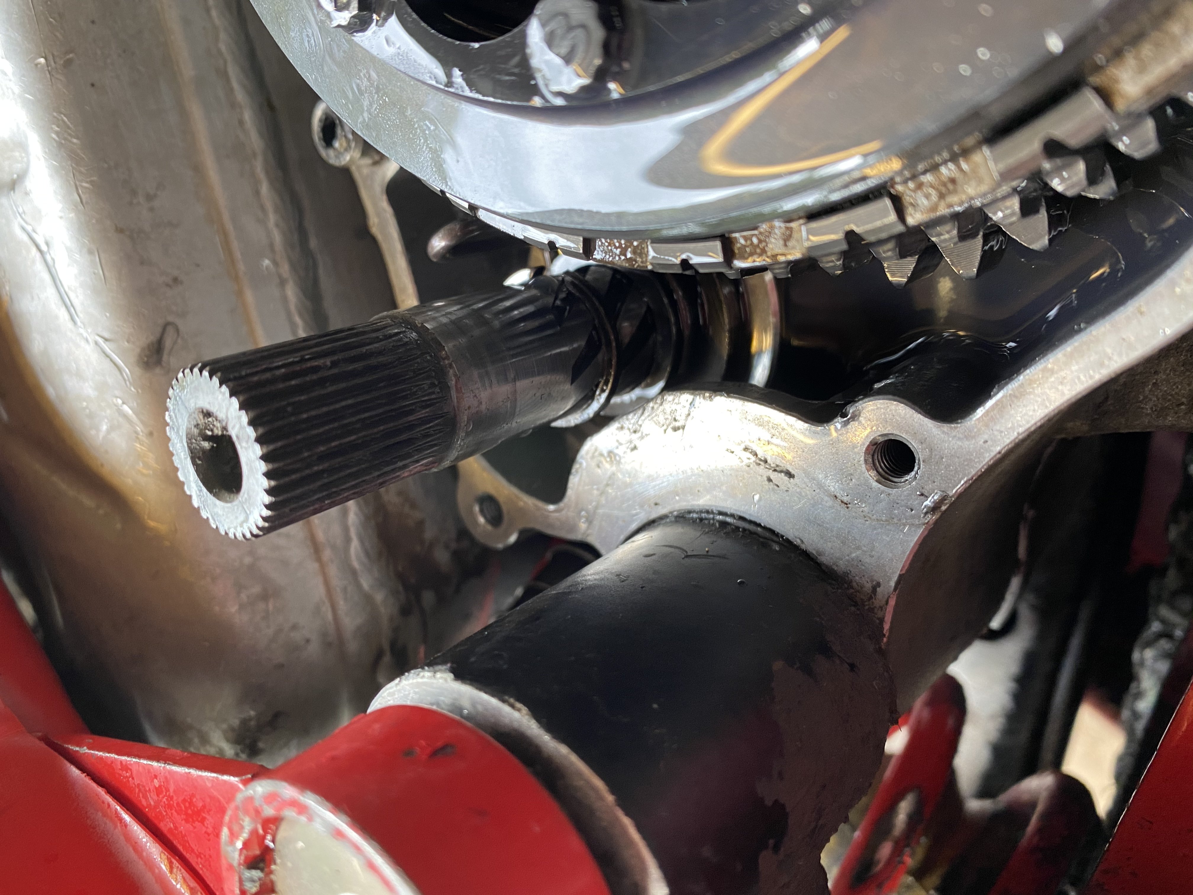

Clutch cover off and that’s what I found, piece of cog was down near the shaft any ideas on what’s next?
with the idler gear broken, be sure to check over the "Bart" gear on the kickstart shaft for damage as well.
The idle gear is actually fine the piece you see broken here is the bart gear

Originally i thought it looked like the bart gear. As for the idler, you won't know until you rebuild it. A slightly damaged tooth on the idler gear can create a very annoying rumble/ticking when the bikes running and turns against the clutch basket.
Edited by faussy
Check the replacement Bart gear very carefully, no tiny indentations, scratches or burrs on the teeth...all can lead to hairline cracks developing eventually ending up as you found. I think the recess machined into the gear body is the problem, it may be there to allow clearance for some other mechanism but its made the gear very thin in my opinion...no pun intended?
