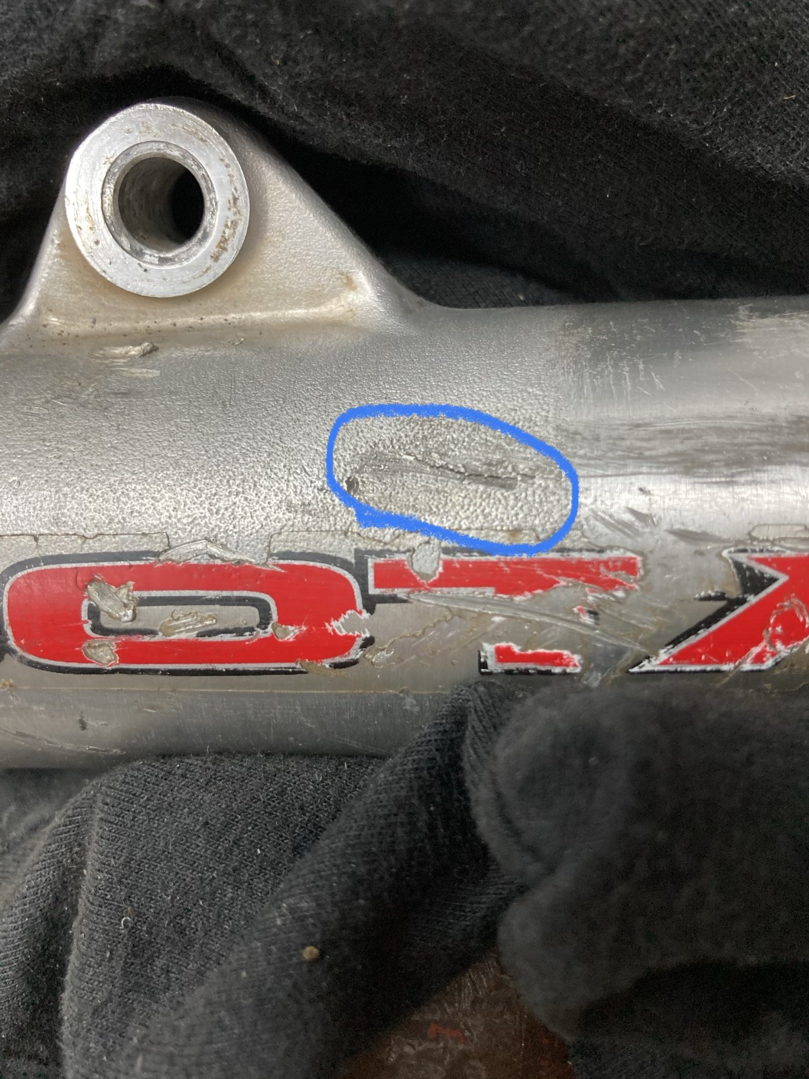

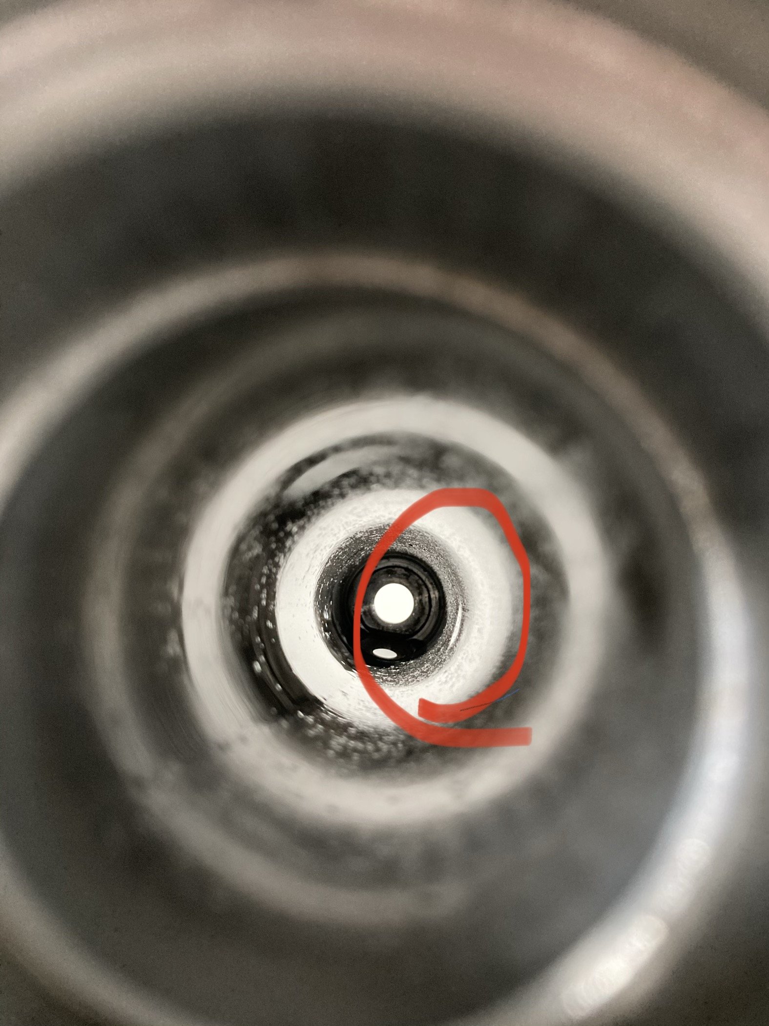

I dove into my winter maintenance today on my 05 4rt. I went to change the fork oil and noticed the spring leg was binding mid stroke. After I tore the fork down I found a small ridge from a dent in the lower slider. I know the proper course of action is to replace the slider. I’m not sure I can get the part. One online source says available in 2-3 days another says extended back order due to covid and no sort of timeframe. I’m in the US so it will likely me harder to find one.
if I can’t get a replacement what are my options? I had the thought of using and exhaust pipe expander with hose clamps on the outside to support the leg to hopefully push the dent out enough without deforming the tube any further.

Reeming  tool welded onto an extension bar to get down in? It wouldn't weaken it that much.

As above, but have the fork welded first to fill in the dent.

I had a similar problem with an RL Suzuki, which had rather thin sliders, but the fork jammed completely (the Mamore Road, not to mention the sections, was fairly interesting with a solid front end?).  I can't recall exactly what they did but a local machine shop were able to sort it and it lasted for years thereafter.

I've done similar on a few sliders, but I used a boring bar in a lathe.

I have been wondering about this.  How do you set up a slider in a lathe?  All of the external surfaces are non-precision as-cast surfaces.  How is the slider held and how do you get the bore aligned straight and centered?
there are a couple of ways,
In a four jaw chuck and a fixed steady (and a bush to fitted to run the steady)
or the slider mounted on on the cross slide (vee blocks and lots of packing), and boring bar in the chuck
both methods take a lot of clocking up!
