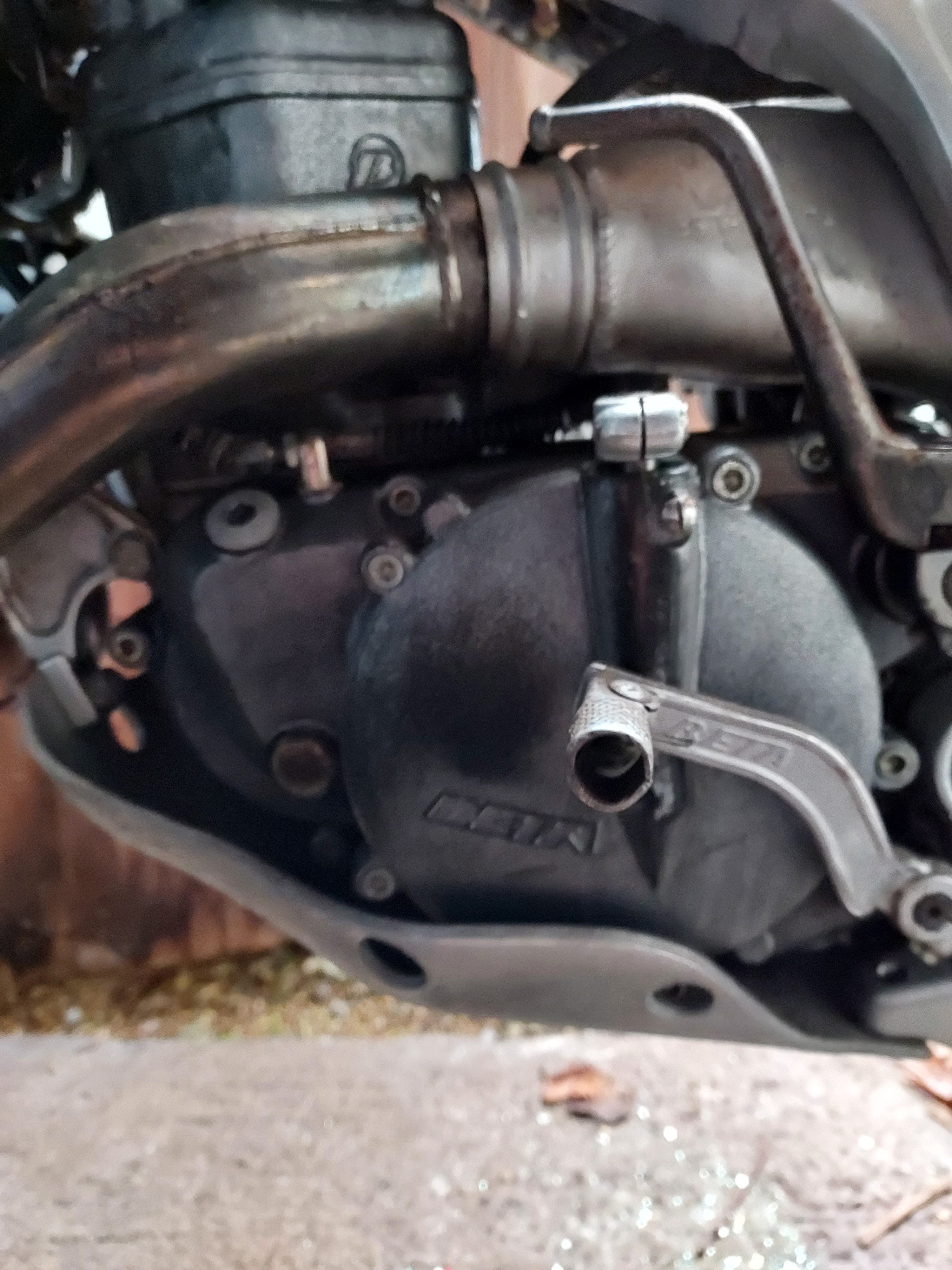

Hi, many thanks for that. To clarify, sump plug on underside of gearbox?
Attached photo: top left filler...?
Also, minor detail, but previous owner has wrapped tape around the kickstart horizontal "spike" for want of a better word. I assume this is out of some sort of personal choice rather than a rubber missing...? Makes it slippery.

The sump drain plug is the large alloy Allen key bolt on the underside of the engine, it should be able to be accessed by a hole in the alloy bash plate. To free the clutch off properly id take all the clutch plates out get some very fine sand paper and gently sand each friction plate. (not the metal one's). using some gear oil on the sand paper on a perfectly flat surface in a figure of 8 or circular sanding motion you don't need to sand much off probably 30 seconds per side  with not much pressure pushing down on the plates. I used p1000 from halfords it's work form a few times over the year's.
OK, thanks for the sump drain plug confirmation. It wasn't immediately obvious because there seems to be some sort of plastic shield which seems to have moved and part-covered the hole. Getting the bash plate off looks to be the first job....
