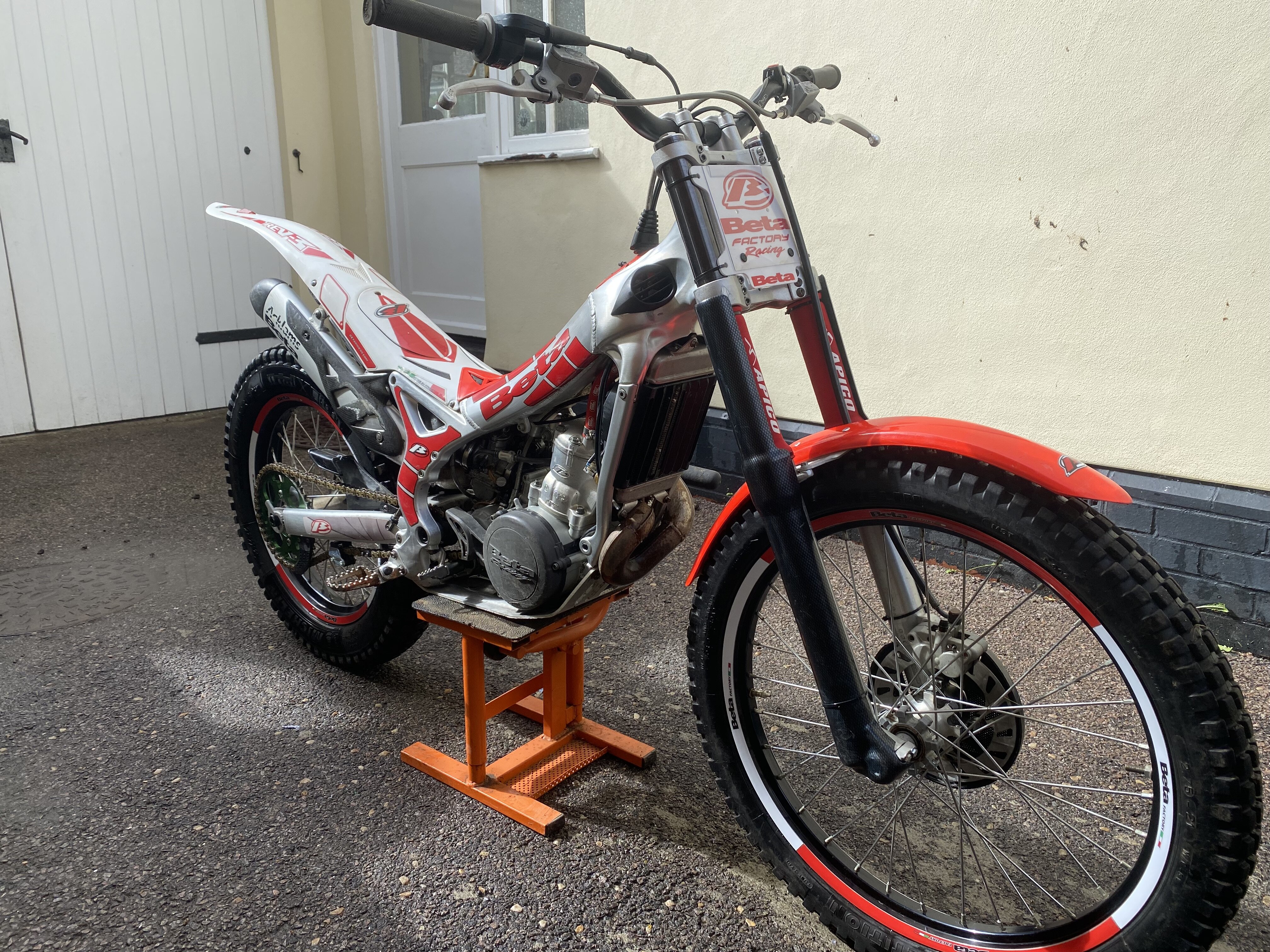

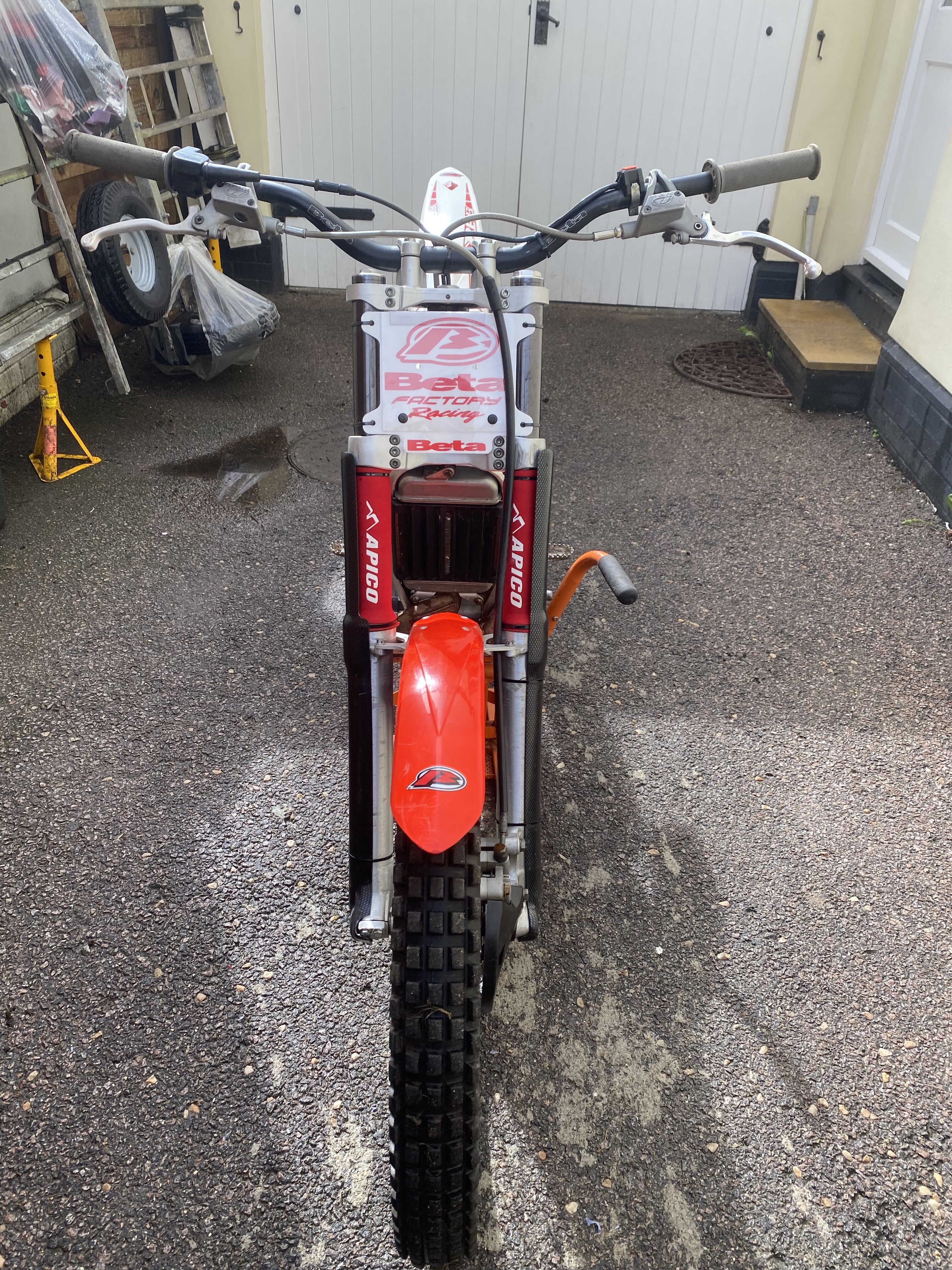

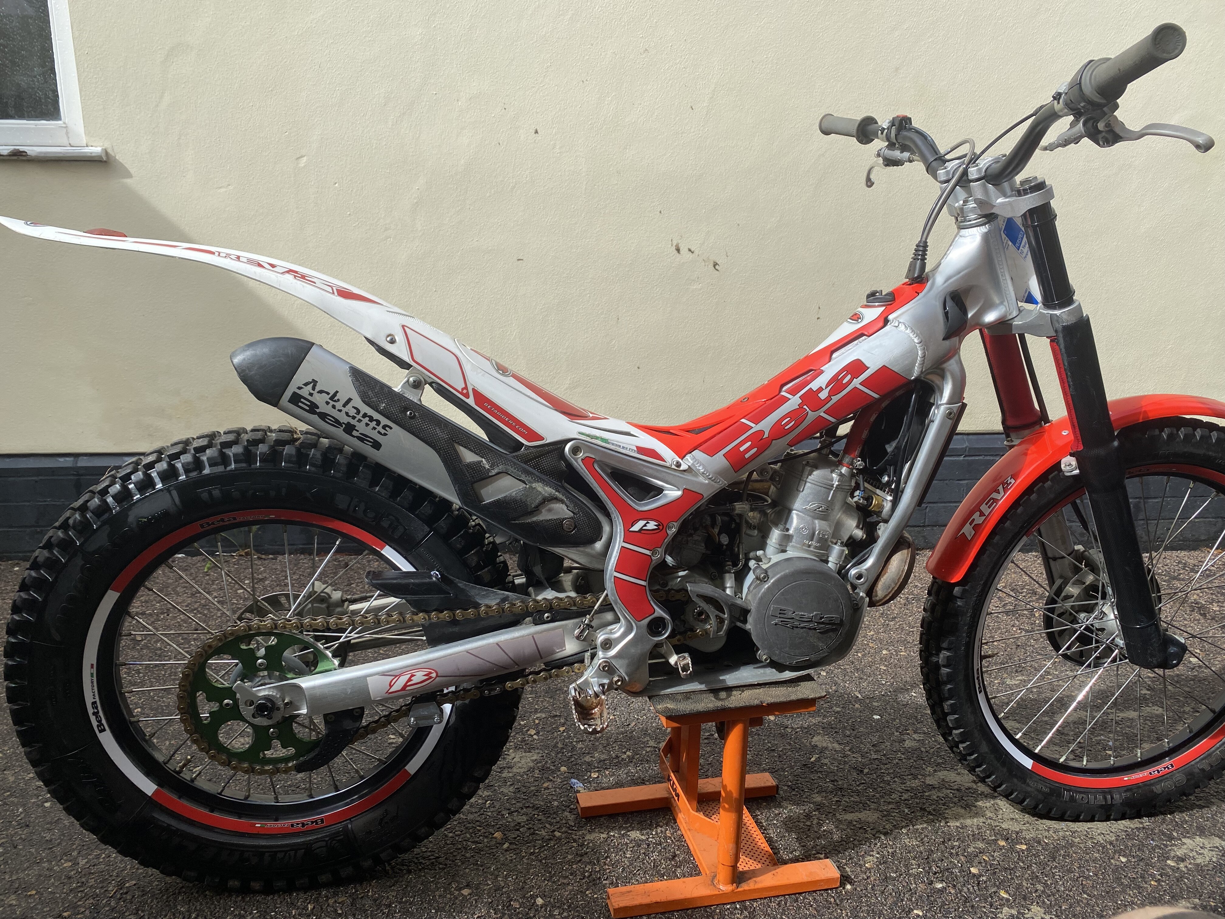

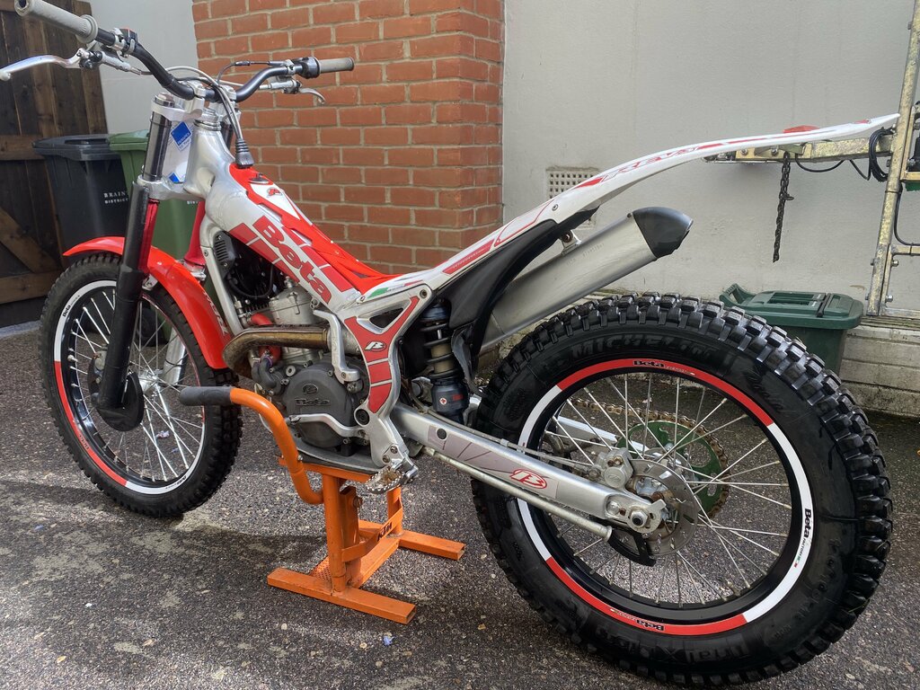

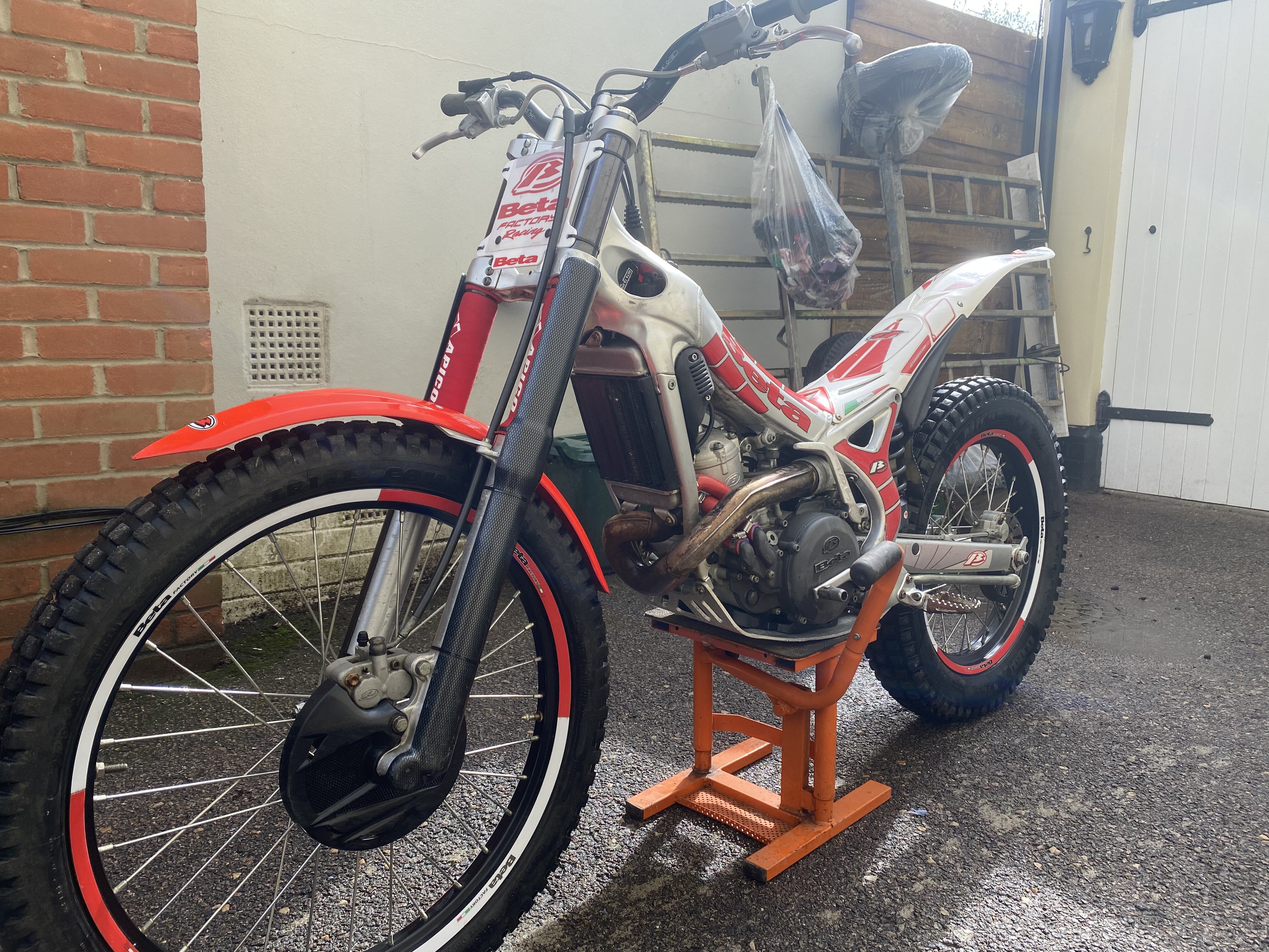

FOR SALE 2008MY Rev3 250 2T
Road registered as a ‘57 plate (V5 in my name)
Very, very good condition
Recent full service kit
Fork seals replaced
New Chain & Sprockets
Full length fork protectors
Apico Fork Gaiters
Apico levers
New grips
Wheel rim decals
New front & rear wheel bearings (supplied, not yet fitted)
Inner clutch cover was replaced by previous owner (due to corrosion) and then a Samco silicon hose set was fitted and it’s been run on waterless coolant since.
I have the full lighting kit, wiring, speedo, and a bunch of spares & other bits and bobs.
Starts 1st or 2nd kick and wants for nothing.
Unabused southern bike, I only ride in Novice!
Selling only as I’m upgrading £1800 Braintree, Essex

Hugh,
I've posted it into the Classified Adverts here with some pics. But if you care to message me you're mobile I can send the direct via WhatsApp (and a couple of videos of it running)
