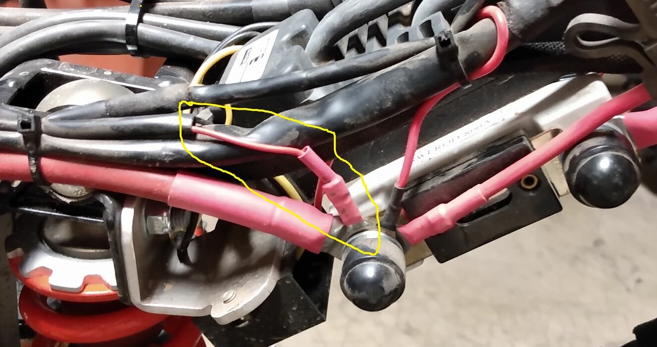

Joule Posted September 28, 2021 Author Report Share Posted September 28, 2021 Thanks for the suggestion, my riding partners do experience what you describe on occasion at one of our staging areas which sits under some high tension lines. My experience was far from any lines and I immediately expressed to the riders around me did anyone else experience a discharge or see anything...no one else. I think I may have traced the culprit, at minimum I am not concerned about operating the bike in dry weather. Attached photo shows the attachment point of the battery +50V terminal. The terminal is one side of an 800A fuse, and the additional wires coming off the terminal are clearly going to melt long before the fuse if there is a short on their side. Point being, I don't think I need to worry about a short induced battery fire. As an aside, one could definitely do some welding in the field with the EM battery...that's got to come at a huge premium price! In the picture I've circled a red wire that is on the +50V battery terminal in yellow. If I traced it correctly this wire runs to the LCD display (and I want to believe I traced it correctly because it isn't uncommon for an LCD to need more than +5V logic supply. I'm guessing EM chose to use a step-down converter in the LCD rather than a step-up, keeps wire size down). I'm highly suspicious the jolt I received came from the LCD supply line. I'll be even more convinced if someone can give me a reasonable explanation of the current path... I think for a long term solution, if it is the LCD line, I want my dealer to find out from EM if the hypothesis is plausible, and if yes, what is the current draw of the +50V line so what value resistor could be placed in line to limit any future shock. Or an inductor...but that could backfire severely if a resonance occurs...both inductor and resistor... Quote Link to comment Share on other sites More sharing options...

Guest dgshannon Posted September 28, 2021 Report Share Posted September 28, 2021 (edited) 22 minutes ago, Joule said: In the picture I've circled a red wire that is on the +50V battery terminal in yellow. If I traced it correctly this wire runs to the LCD display (and I want to believe I traced it correctly because it isn't uncommon for an LCD to need more than +5V logic supply. I am a bit taken back by them taking those power taps ahead of the fuse. Running 50v from there, all the way back to the LCD, before stepping down just doesn't sound wise, if that is the case. Given you felt the shock on the clutch side, I would look closely at the kill switch lanyard button mounted right next door. In addition to the normal kill switch functionality, it lights up as well. No clue what type of power they are sending up to it for that. Should be minimal, but it is still a current path. Wet lanyard around your wrist is a conduction path, as well. Edited September 28, 2021 by dgshannon Quote Link to comment Share on other sites More sharing options...
Joule Posted September 28, 2021 Author Report Share Posted September 28, 2021 40 minutes ago, dgshannon said: I am a bit taken back by them taking those power taps ahead of the fuse. Running 50v from there, all the way back to the LCD, before stepping down just doesn't sound wise, if that is the case. I suspect that it is deliberate to leave the electronics live on whatever is left of battery power after the 800A event...it let's them have a diagnostic and maybe a warning message like: "RUN!" or "Please enter next of kin" Quote Link to comment Share on other sites More sharing options...
